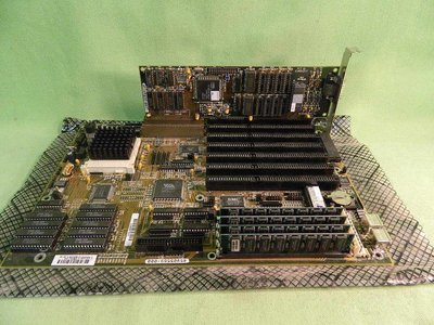

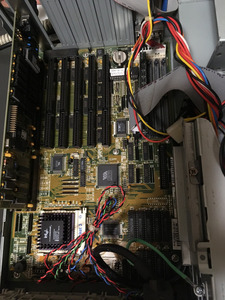

I put down a bid for this socket 3 motherboard and surpisingly won it for almost a decent amount of money these days for a socket 3 motherboard, $51.
It is labled as a "ELI6-II Socket 3 Motherboard w/ Pentium 486-DX2 CPU SIMM Memory and Video Card"
Now I don't know why a Pentium is mentioned, hopefully it is a socket 3 motherboard, but with the VLB slots I think that is a given. I can't find any information on and ELI6-II motherboard. Granted I'm working 15 hour days right now because it is hell week for the school musical right now so maybe my google skills are severely diminished. 😊
Does anybody recognize this motherboard and have more info on it? I'll attach the image I got from ebay. Thank you for your time!

Reply 1 of 18, by PCBONEZ
BIOS string?
Reply 2 of 18, by Robin4
VIA CHIPSET + BLACK SIMM SLOTS = Could be FIC (First International Computer)
I would guess that the bord was made for businesses applications, because two PS/2 where very rare for the regular consumer market..
Reply 3 of 18, by PCBONEZ
UNISYS ELI6-2 (That's the system it's from not the mobo model.)
UNISYS OEM'ed some of their boards from FIC. It may never have been offered retail.

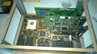

Reply 4 of 18, by McBierle

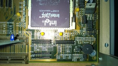

It seems i have the same one. It is a Socket 3 board, i'm using an i486DX4-100.

Reply 5 of 18, by PCBONEZ
BIOS string?
You can usually ID the manufacture and sometimes the model by decoding that.

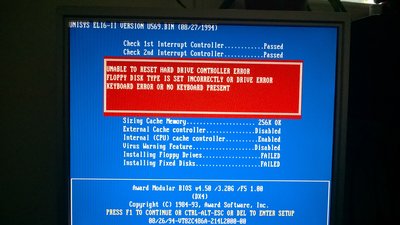

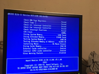

Reply 7 of 18, by McBierle
Hi!
Bios:
636.5 KiB

Reply 8 of 18, by PCBONEZ
Thanks -Have another.
UNISYS ELI6-II VERSION U569.BIN
Custom UNISYS BIOS for the system. (Like a Packard Bell would have for one of their systems.)
08/26/94-VT82C486A-214L200-00
Generic FIC ==> https://www.wimsbios.com/chipset/214L2.jsp
Can't find a FIC board with that layout.
Most likely custom made for UNISYS
If you toast the BIOS chip you aren't likely to find a replacement.
Might wanna archive a backup of your BIOS.

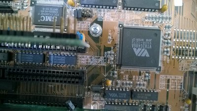

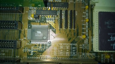

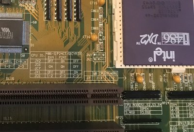

Hi, i don't have any Cyrixes for testing but i tried an AMD DX4 which diddn't work. Alway recognized it as DX2-66. As you can see in the pics there are Options to change to Cyrix but on my board one is soldered to intel. As i don't have a fitting cyrix i diddn't do solderwork.

I noticed you are running with S1, S2, S3 and S4 open, which according to the print on the board would give 5 Volts. Aren't all DX4 in the 3.5 V range? Is your DX4 fine with the higher voltage?
I have a DX2-50 on mine, but am considering upgrading to a DX4. I figured I would have to try and close S1-S4, so I'm curious that maybe I don't have to?
Sorry for digging out this old thread, but i had time to play around.
S1-4 are indeed "fixed" on 5v but i measured and it seems this board has an voltage detection. Intel/amd dx4's run at 3.X V.
I soldered jumper pins on some places so i could chose cyrix as i now have an TI dx4 which if i'm right are cyrix cpus. To my surprise it runs at 5V. Does cyrix not support this voltage detection stuff?
As i wrote earlier amd dx4 is idetified as dx2-66. But after doing some benchmarks it seems to run similar to a intel dx4.
Another thing is that it seems the jumpers for 2.0x / 2.5x / 3.0x have no effect, the cpu choses its own multiplier.

Using an intel DX266 SX955 (P24D) with the jumpers set according to the middle column, sometimes produces bad audio distortion in some games. I got around this by setting the jumpers according to the left most column (pictured)
210.13 KiB
1671 views
, which makes the board recognize the CPU as a "80486DX2S", rather than a "P24D". This may or may not be because of an issue with how the board handles CPUs with write-back cache functionality, like the P24D.

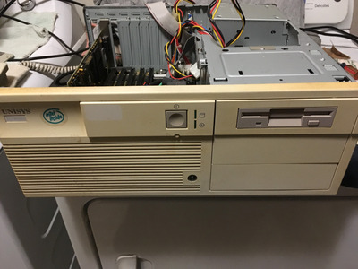

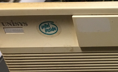

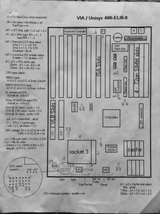

Sorry to revise this old thread but recently got a mostly complete Unisys ELI 46665 computer. The ELI6-II board came in it and it has a label that has the jumper settings. Also shoved under the dead HD was a paper that also listed the jumper settings. Here they are along with some pics of the computer. I removed the label best I could with hot air and attached to a sheet of paper to take the picture.
    524.17 KiB
    1483 views
    588.52 KiB
    1483 views
    212.06 KiB
    1483 views

Forgot the pic of the full front. My work shop desk has the Laser XT3 on it so was using the top of the washer and dryer to test this one 🤣
