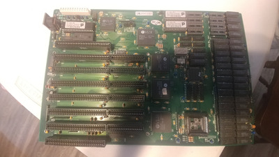

My board has 2mb sicked in the board, and no simm or sipp sockets, but 2mb seems rather small, maybe it's not but I want a fluid 3.1 experience to launch dos games from. What's the best way to increase my memory.
The memory and board

Also I've got empty ic sockets above the ram, are those cache. I haven't been able to identity the board yet. It's a 386SX-16 with a vlsi chipset
Reply 1 of 51, by Horun
Hmm I cannot read the CPU or main crystal, your pictures are very 1990's 🤣. Those empty sockets could be cache but the VLSI 82c200 series chipset was also used on some 286 and had very limited support. If that a 16Mhz 386sx is not worth wasting money on imho, it will not perform any better than a 286-16 under most conditions. Just my opinion and no do not recognize the board.

let me read what the IC's says for the ram
MT4C1024-8 X 16
AND
GM71C1000-80 X 20

Are you certain this board can’t accept 4mb in dip ram?
Anyway, a fluid 3.1 experience probably needs a 486.

No I'm not but I have no idea what to search for to find it either, I've tried 4mb x 1bit 18pin dipp and found nothing, I've only been able to find 4mb x 4bit 24 pin dipp
Reply 12 of 51, by Anonymous Coward
I think something like Samsung KM41C1000 is what you want. 1Mx1 page mode DRAM.
Your board appears to already have 36 pieces of 1Mx1 DRAM though. That should be 4MB (with parity), so either some of your memory is configured as EMS or you have a bad IC.
BTW, what is the "P" on the AMI chips? Is that the OEM insignia?
Hmm bad dram I hadn't thought of that, 4mb is where I want it to be, now I'm gonna have to go testing it 🤣
Reply 16 of 51, by candle_86
I tried messing with the rsel jumpers, rsel0 sees 2048, rsel1 gets me 1743mb, and rsrl2 limits it to 512kb. Any combination my max is still 2048, if rsel0, and 2 are selected it's 512kb and rsel 1 turned in with anything is a black screen. Dunno if that helps at all

Make sure the 4 chips for parity is correct 1MB x 1 bit, Not 256K x 1bit.
If 4 chips are 4 bits per chip, remove these four.
