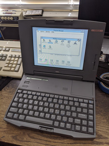

It came in.......the Versa M75 that is.....
So here's the assessment
Working/Good
- CMOS battery is good
- runs NESticle at full frame rate
- runs most DOS games perfectly
- came with 2 batteries (no floppy)
- the batteries are the newer smart batteries
- looks to have latest BIOS (1997)
- original NEC NL6448ac30 panel is not cracked
Broken/Missing
- digitizer is cracked and not working, plus blurry (hard to see through).
- can't figure out the words+ thing yet
- need to change driver setup in FreeDOS for sound and wifi
- missing the pen for touch screen (1/8" phono connector)
- have not figured out words+ thing yet
- lots of adhesive to remove (words+ was velcroed to bottom)
- no smartbay floppy (my other might work).
- doors for pcmcia, rear ports, and Dock gone
- hinge casing BADLY cracked
My plans.....
- replace digitizer, get pinout for pen and make my own if I can't find one.
- hinge cover rebuild
- replace doors
- get proper Floppy drive
Pictures

That Versa is a nice looking laptop it'll be a fun machine once you get it all fixed up

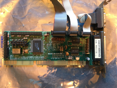

Played around with one of my 386DX-40 boards, a C3404 Rev B (MH2212, TH99 32212) found the ext. battery uses pin 4 for + and pin 1 for -, opposite of most 286/386 boards.

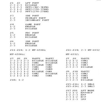

Also figured out some jumpers on my Holtek LCMEIO-2A (Holtek EIO-2 v1.1) ISA IDE/Floppy/multi card based on Holtek HT6550A. Found the datasheet and J10 needs to be on 1-2 or else the card does not work proper. There is good silk screening on the card for most jumpers but not J10 and nothing anywhere on the net mentions it (I could find nothing). Also the datasheet has jumper settings if the chip is a HT6552. Included a picture of card and of the jumper settings.

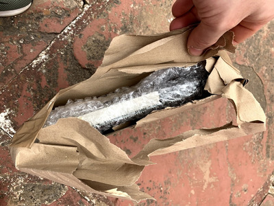

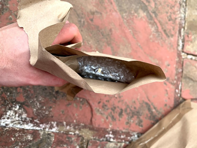

I got time to test my pc chips m912 and VLB I/O controller that both arrived from different sellers but packed the same way.
1 layer of bubble wrap and then wrapped in paper...
Incredibly they both still work.

Horun wrote on 2020-07-26, 02:27:
this thing has 16 data bits but only 11 address bits on isa connector - how come?
Reply 16297 of 30903, by Horun
mrau wrote on 2020-07-26, 14:18:
Good question ! I also have a Maxtor ISA 16bit IDE/floppy card (with Goldstar chips) and it has all 16 data but only 11 address lines also. Ahh found this:
"ISA was the basis for development of the ATA interface, used for ATA (a.k.a. IDE). Physically, ATA is essentially a simple subset of ISA, with 16 data bits, support for exactly one IRQ and one DMA channel, and 3 address bits. To this ISA subset, ATA adds two IDE address select ("chip select") lines and a few unique signal lines specific to ATA/IDE hard disks.."

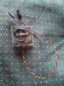

Today I made a quick and ugly BIOS battery holder for my 486.
