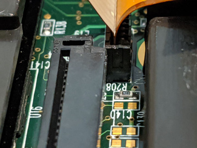

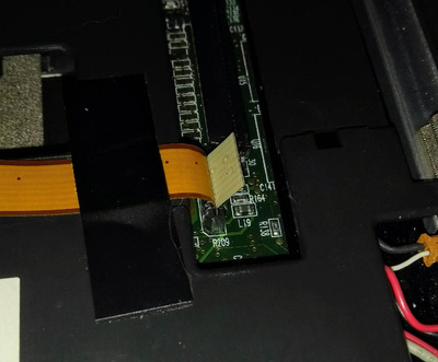

I'm stuck on this cable (see attachment) while taking apart a Compaq Armada 1750. It looks like a ZIF cable but it doesn't have a clamp that you have to open first.

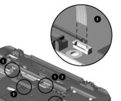

The service manual says to just pull it and I have, with quite some force on the white part, but it doesn't seem to move at all. Is there a trick to it?

That type of cable is usually pretty tight. I usually wiggle them out slowly. And of course undo the tape if you haven't already.

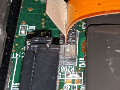

It's confusing. I don't think there is a clamp but the service manual suggests there is.
I've taken some photos with a phone instead of a potato and I don't see any edges. I also tried to poke around with some tweezers but nothing seemed to move. Still didn't get the cable out but I guess I'll just keep trying by wiggling it.

I wonder if there really is a lock and the tabs are just broken off

Hmm, now that you mention it, the surface does seem a bit rough on the sides.
Except for the missing hard drive (and the bent pins...) I didn't see any hint that it was opened before. But I'll see if the 'pillar' in the middle can move because that could have been part of the clamp I guess.

speaking of rough, those pins don't look particularily shiny, maybe there's some corrosion preventing it from slipping out easily... did you try some contact cleaner as "lube" maybe?

I got it out. I couldn't find any moving parts so I just tugged on it on several occasions and it suddenly moved. There was no indication that it was getting loose, it just popped out. I will put some contact spray into the connector before I assemble it again.
