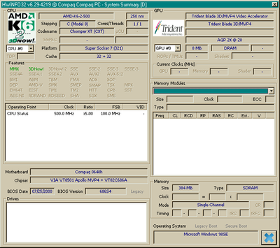

I just noticed that for some reason, the newest version as well as the beta of HWINFO thinks that the 9700k in my htpc for some […]
I just noticed that for some reason, the newest version as well as the beta of HWINFO thinks that the 9700k in my htpc for some reason is an engineering sample when I got it from Microcenter and is an R0 based 9700k.
file.php?mode=view&id=88584
It shows "Prod. unit", but QDF number instead of SSPEC. So your CPU is OK. Shall be fixed in the next build.
Thanks 😀

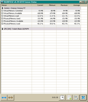

Reply 402 of 683, by hwh
Results from new beta:
Had to zip the HTM because this stupid forum won't let me attach it. DBG(log).
1. Monitor is simply the saved information from some INF but the installed monitor is not this. It's a Sylvania L17.
2. This is all that shows up in sensors. I guess there aren't many sensors. Think you would have SMART or something.
3. Here is the summary now.
On the memory sheet, memory has this "detected size" but unknown "total size" for some reason...
Reply 403 of 683, by Mumak
hwh wrote on 2020-08-06, 02:48:
Results from new beta: […]
Thanks! The Trident card seems to be properly recognized now. Information like SMART will require copying a VXD within the WINDOWS folder. I don't recall now the exact path, but I think it has been detailed in the SIV thread.
As for the monitor, I will need registry dump of the HKEY_LOCAL_MACHINE\ENUM\MONITOR node.

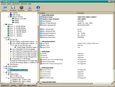

Reply 404 of 683, by hwh
Mumak wrote on 2020-08-06, 07:49:
Thank you too. I'm not following the SIV thread, so I'll just leave it there.
Here's the MONITOR node. As you can see, there's a default, the Sony one, and then the Sylvania. However only the Sony appears as a monitor in HWiNFO, and I promise you it isn't the installed monitor. Maybe nothing you can do but FWIW.
Reply 405 of 683, by Mumak
hwh wrote on 2020-08-06, 08:33:
Thanks, I'll try to fix this in the next build.

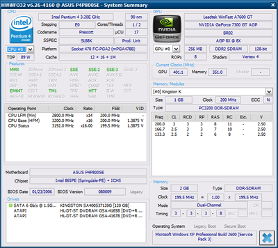

Reply 406 of 683, by Carlos S. M.
Not really vintage, but i found an interesting misreport which happens when you try to run hwinfo on a rare EM64T enabled Socket 478 Prescott (SL7QB 3.2 GHz and SL7Q8 3.4 GHz) which reports the wrong S-Spec
61.96 KiB
1879 views
Reply 407 of 683, by Mumak
Carlos S. M. wrote on 2020-08-12, 20:06:
Thanks, those SSPECs seem really rare, I can't find them in the extended/NDA Intel database nor documents.
I will update this in the next build.
Reply 408 of 683, by debs3759
They were originally only supplied to one OEM, but I can't remember which one
Reply 409 of 683, by Carlos S. M.
debs3759 wrote on 2020-08-12, 20:51:
IBM, for certain server machines
For anyone reading this thread, more info on this page: http://www.cpushack.com/2019/10/01/the-story- … m-4-64-bit-cpu/

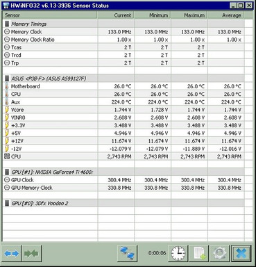

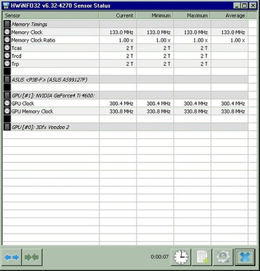

I decided to upgrade from 6.13 to recent stable 6.32.
Problem - Asus sensor chip doesn't show any data. Even worse, after running it once it will kill device for any other software like Speedfan. Only restart will help.
Screenshots:
63.87 KiB
1603 views
83.09 KiB
1603 views
    v6_32.txt
    146.73 KiB
    61 downloads
    v6_13.txt
    45.43 KiB
    59 downloads
Reply 416 of 683, by Mumak
vutt wrote on 2020-10-12, 18:44:
I decided to upgrade from 6.13 to recent stable 6.32. […]
Screenshots:
Thanks, I think I found the problem. Shall be fixed in the next (Beta) build !
Reply 417 of 683, by Mumak
Screenshots:
Please try version v6.33-4280 Beta if it fixes this issue.
Reply 418 of 683, by vutt
@Mumak Yes P3b-F onboard sensors are now working again. Thanks!
