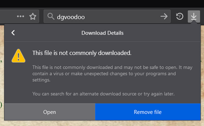

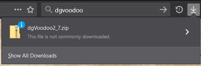

Reply 186 of 474, by mike_1978
Dege wrote on 2020-09-25, 19:12:
Btw, my webpage got recovered for Google S Browsing. I don't know what happened. 😁
Indeed - I didn't get a warning when attempting to visit your website today using Firefox 😀
However when downloading the latest version, Firefox still gave a little grief (easily overcome).
First you press ">"
https://i.imgur.com/cYx5eqS.png
Then you press "Open"
https://i.imgur.com/oDCp9bK.png
Or people can just use Microsoft Edge as you suggest on your website 😉
