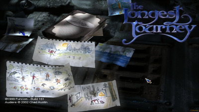

Reply 229 of 474, by The Master
@Dege
The Longest Journey has a little render Bug. See Attachment. It seems that every "movable" Object makes a "dot" on the Screen. Tried around with the Settings but could not fix it.
PS: Thanks for the hard Work. Ultima 9 with a few Mods works like a charm 😀

The Master wrote on 2020-10-08, 21:20:
@Dege
Thanks. It's a known problem with The Longest Journey. Forced res or MSAA causes this.
