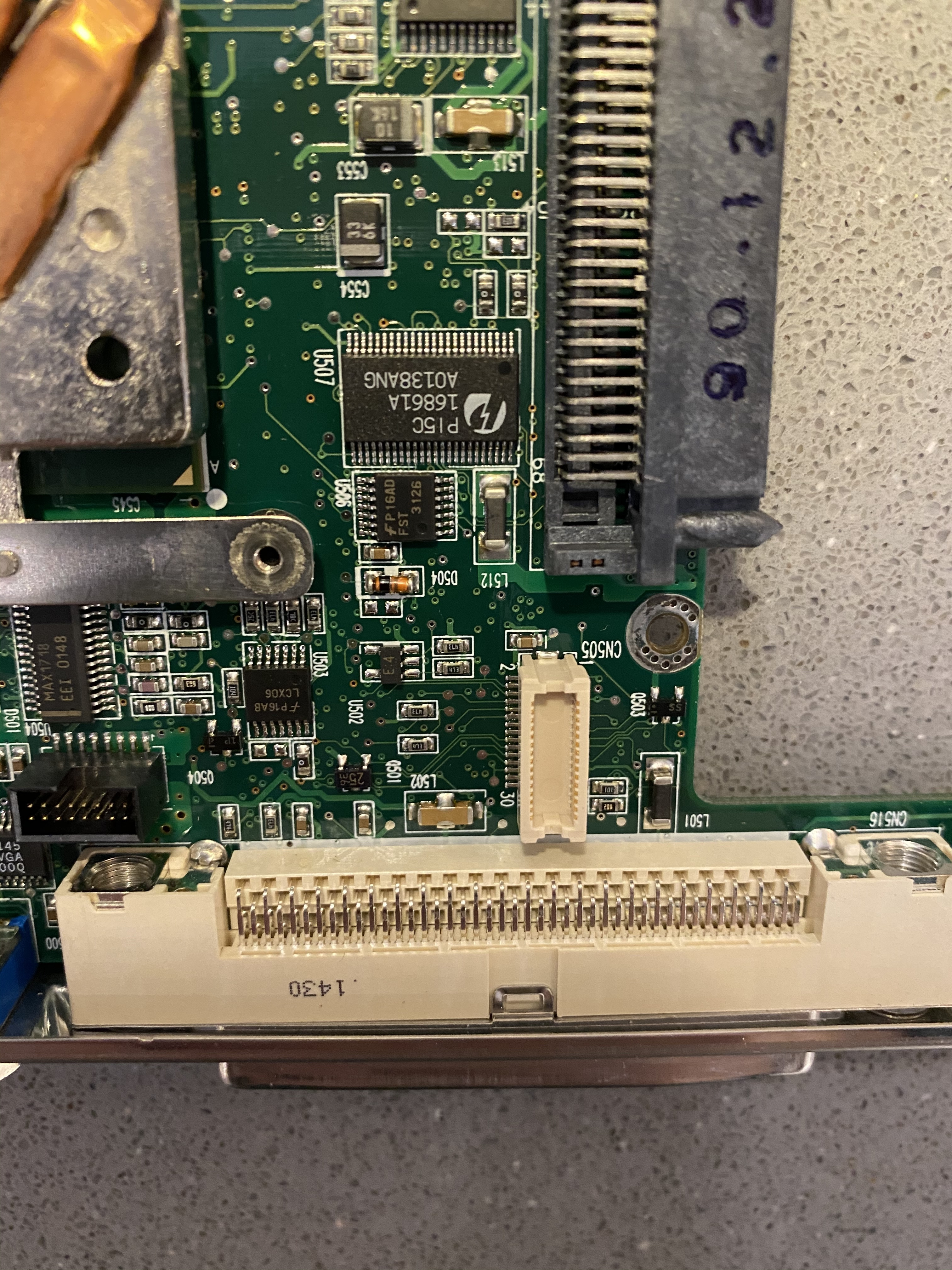

The docking station connector on one laptop was slightly managled so I stuck a penknife blade in to clear out the broken bits of plastic. I did this while it was off but plugged in to the power adapter (very silly). One small spark later and the sound chip is no longer detected in Win98 SE. Also the laptop hangs on any non-physical restart whether it is from the OS or from the BIOS (Save and Exit).
Other than that there are no obvious issues - it POSTs, it boots, everything else 'works'.
I removed the motherboard to give it a quick visual inspection and I don't see any obvious damage. I wonder if anyone has a clue what the cause might be just for my curiosity. I was wondering if perhaps the laptop now thinks it is permanently docked or something like that.

1. Damaged docking connector. You can see where it is bowed and this is where I ran the penknife blade through.
preview

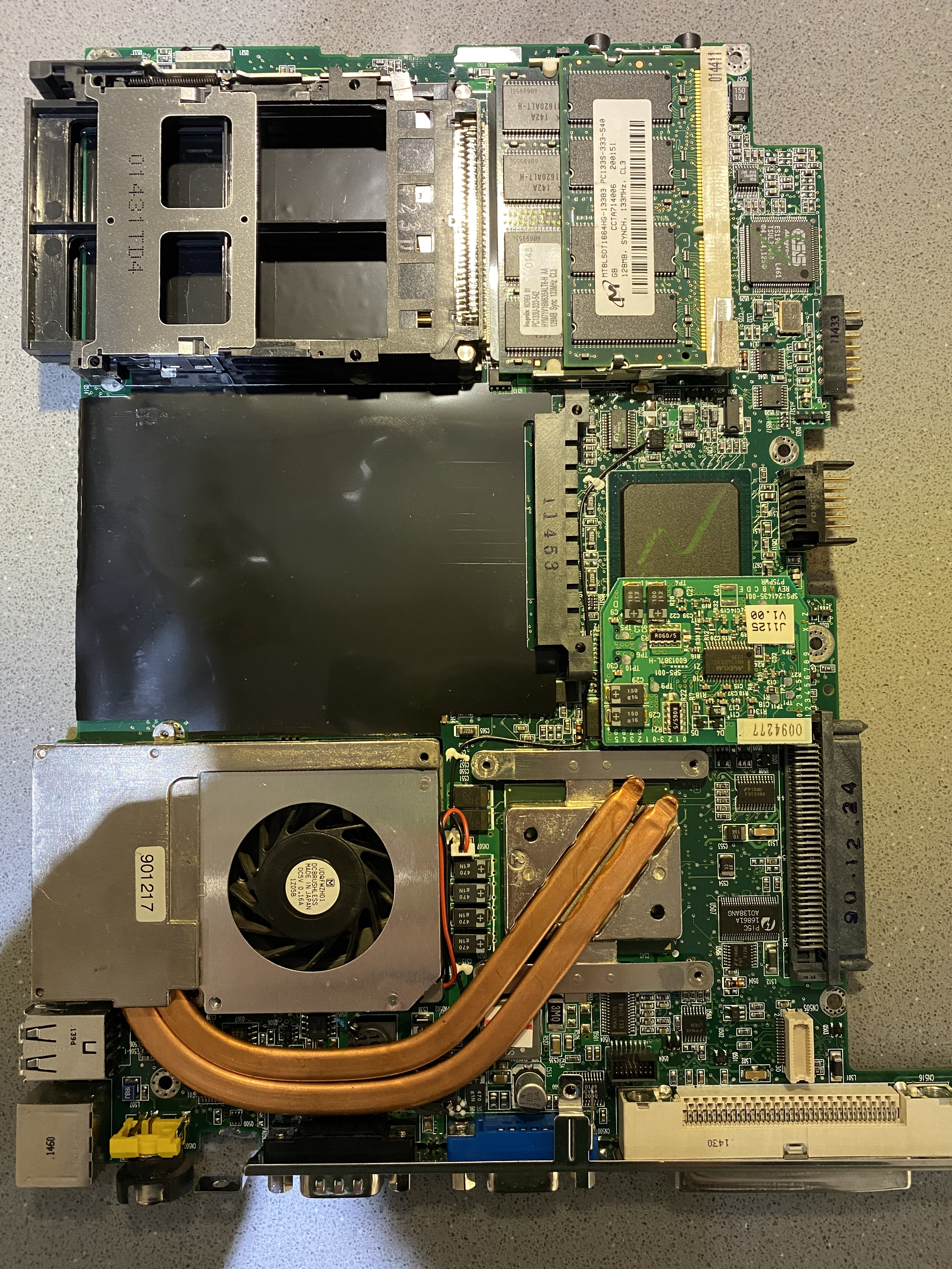

2. Bottom side of the motherboard - docking connector is top right
preview

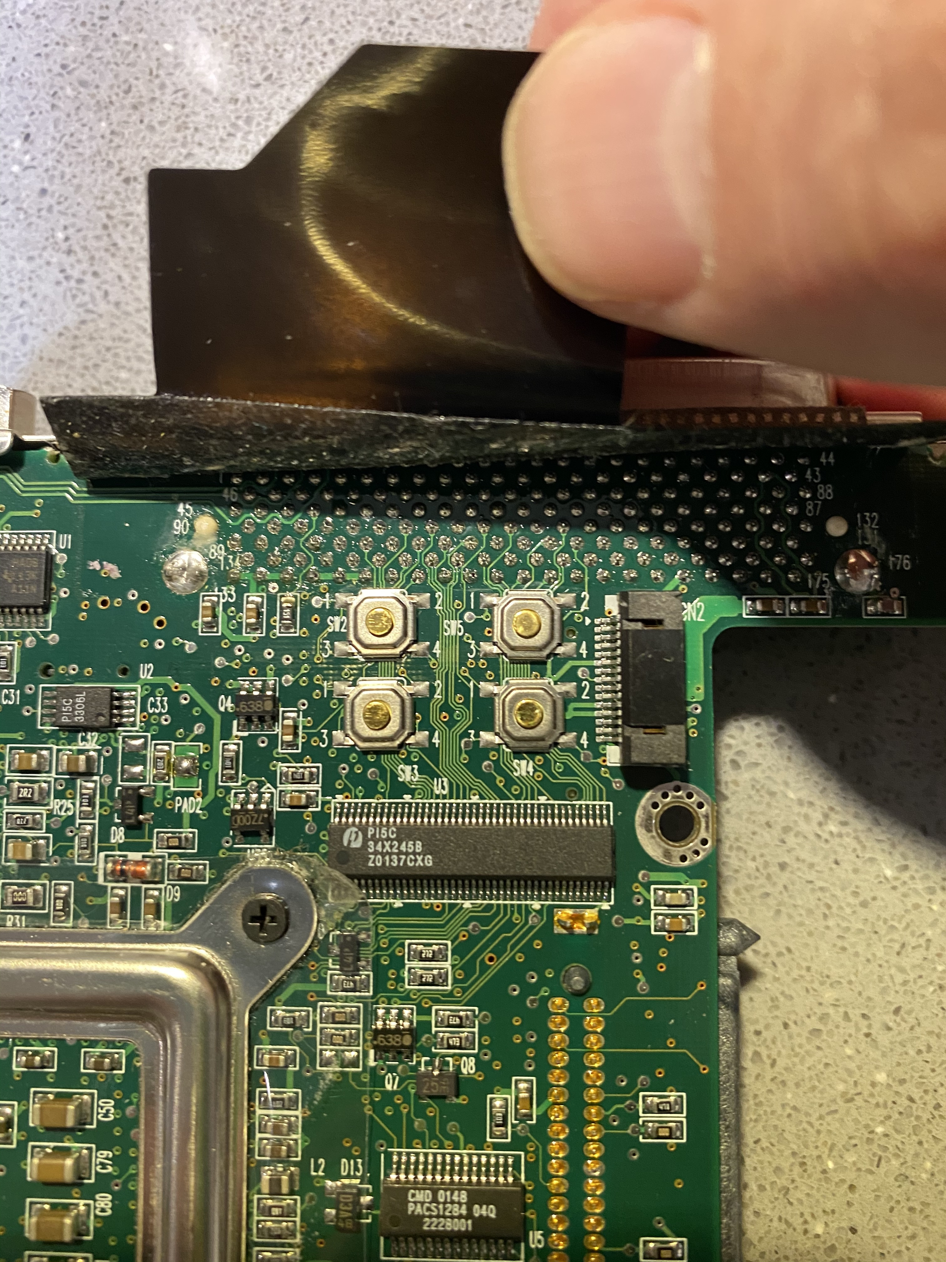

3. Underneath the plastic sheet where the docking connector is soldered to the board
preview

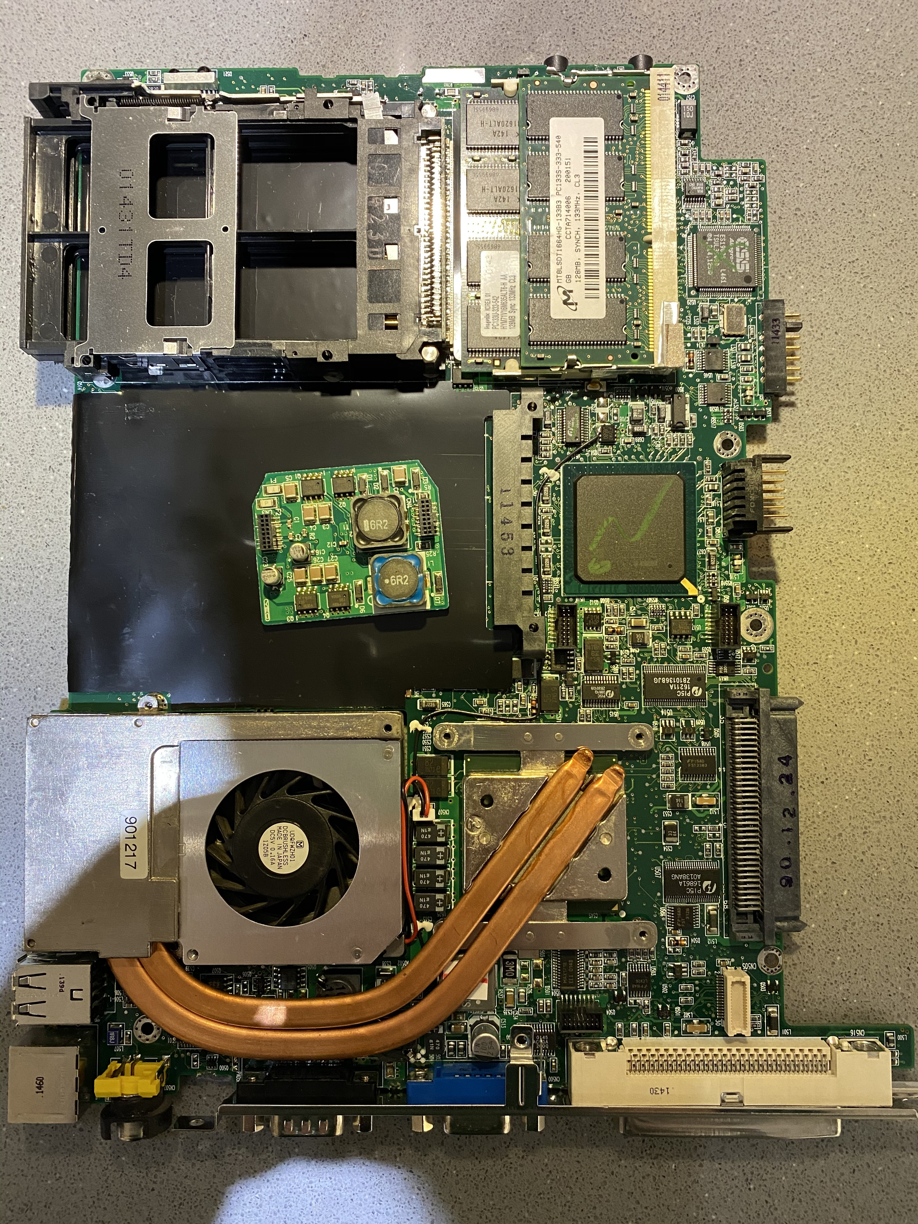

4. Top side of the motherboard - sound chip is top right (ESS Alegro)
preview

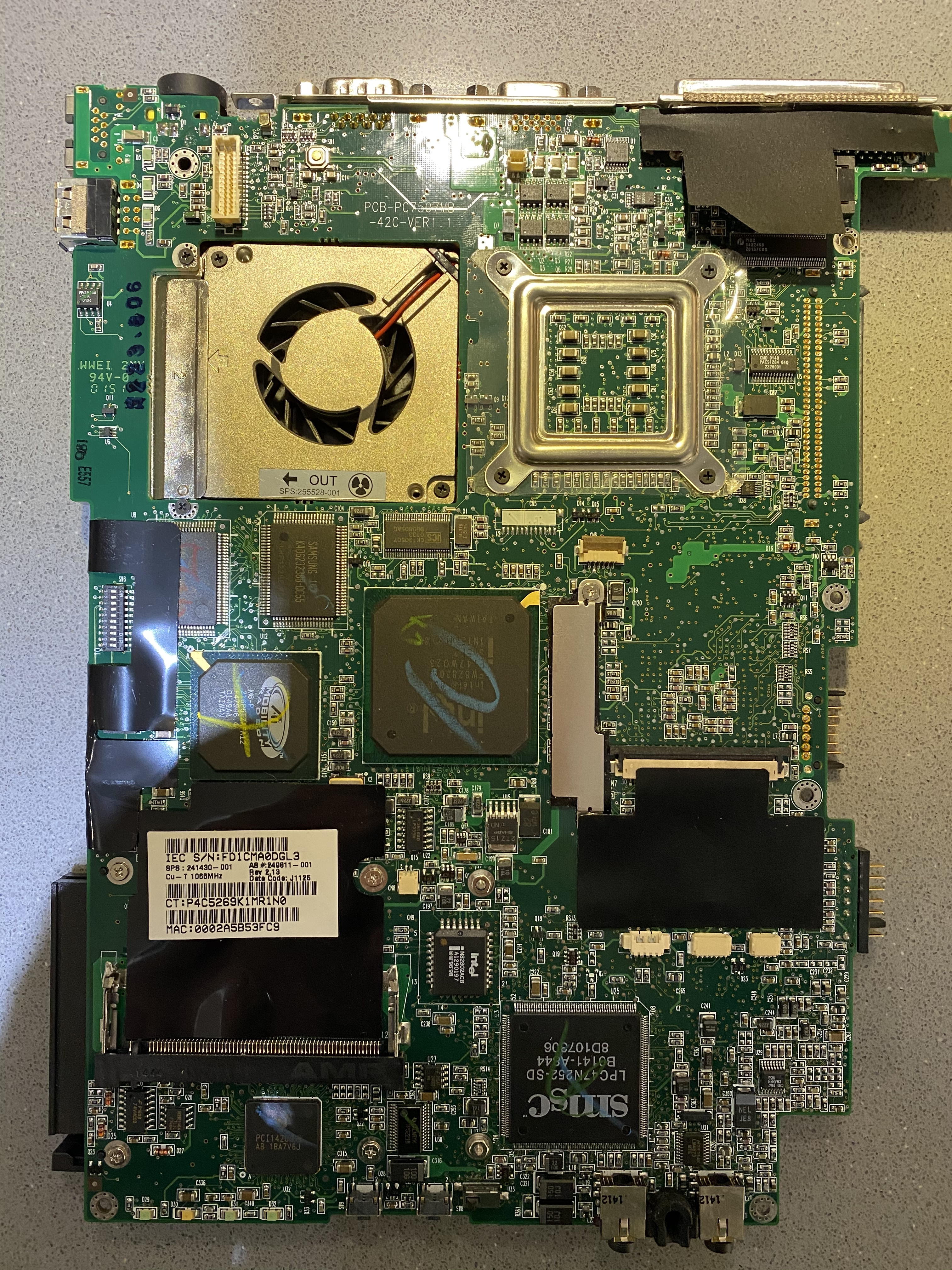

5. WIth DC/DC converter removed
preview

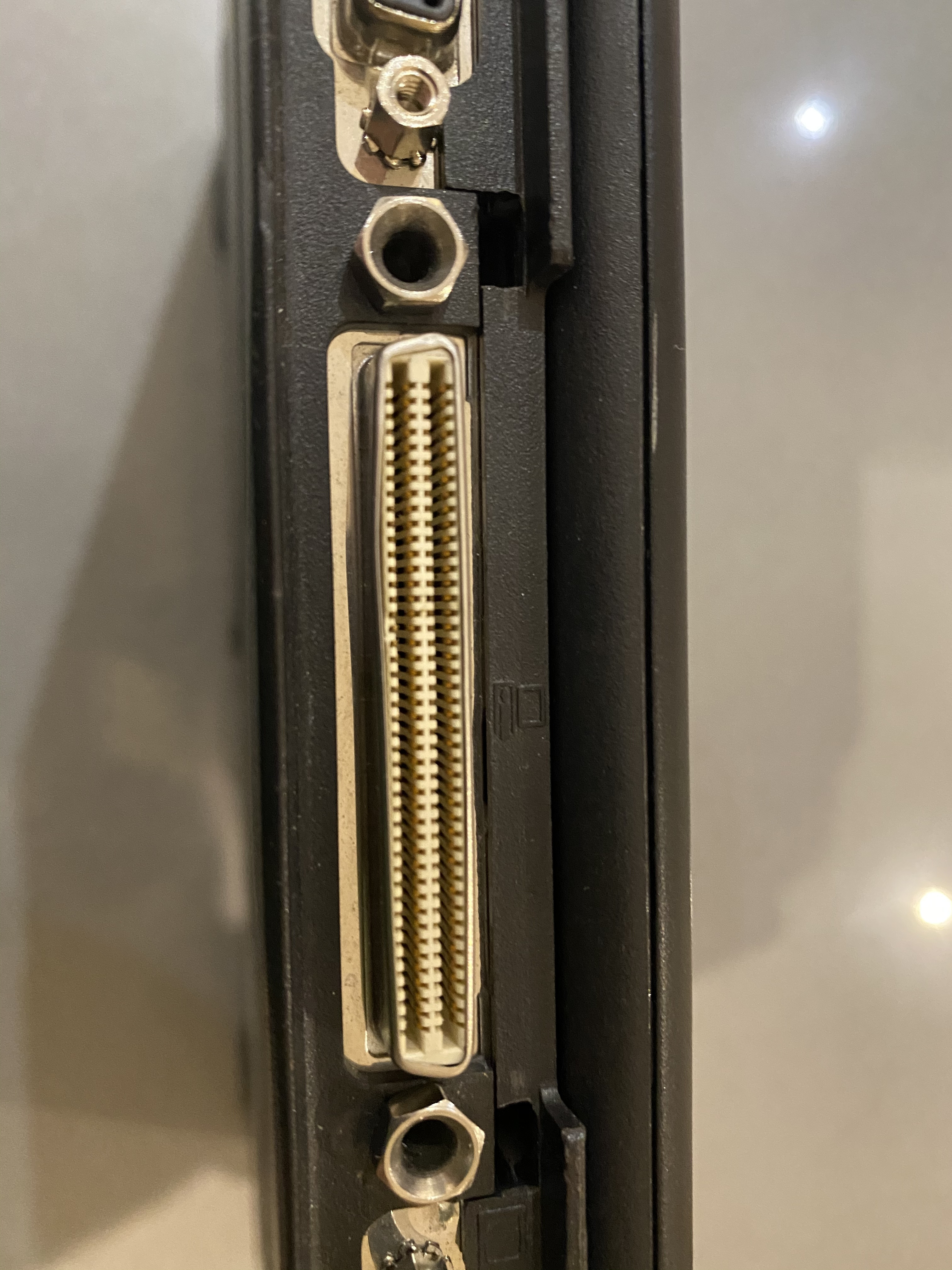

6. Other side of the docking connector
preview

You could check components marked F and L for continuity. You could also try measuring the voltage on VCC pin of sound chip, to see if it gets any power when the board is turned on. But here you would need to be careful too, in order to not cause more damage by touching multiple pins. Maybe the VCC pin is connected to a nearby capacitor, and you can check the voltage on that capacitor, which would be easier.
Reply 4 of 7, by pokeswithastick
No continuity problems. I also removed cpu heatsink and fan and found a couple of extra fuses but these check out ok too. Guess I will try the VCC on the sound chip itself next.

Some progress. This bus controller IC gets really really hot - too hot to touch after a few minutes of the motherboard being powered up. Given its proximity to the docking connector that would seem to make sense however I'm not sure if the fact it is getting hot is because it itself is shorted internally and needs to be replaced or if it is the victim of a short elsewhere.
I'll source a replacement anyway and try to desolder.
Reply 6 of 7, by adalbert
You might look for shorted capacitors (tantalum, ceramic). But maybe it is a problem with that IC. If you have hot air station you can desolder it, if not you can carefully cut the pins with razor (near the body of that IC) and desolder them one by one. If a replacement IC is cheap.
