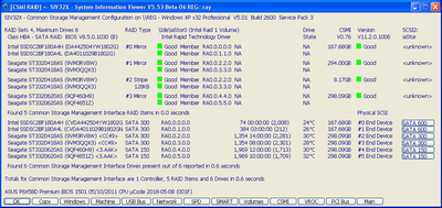

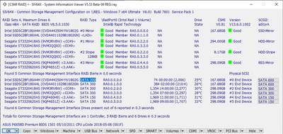

An easy way to check the SATA speed is to run my SIV utility and look at the Menu->Devices->CSMI RAID panel. Below you can see my Intel SSDs are capable of SATA 600, but limited to SATA 300 by the ICH10.
file.php?id=96106
file.php?id=96118
    38.96 KiB
    407 views
    Windows XP - Menu->Devices->CSMI RAID
    71.58 KiB
    428 views
    Widnows 7 - Menu->Devices->CSMI RAID
