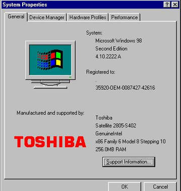

This is the ultimate 9x laptop period.
file.php?id=121964

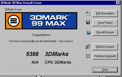

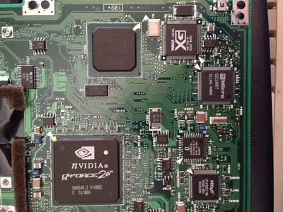

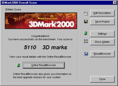

1. Geforce2 go, a highly compatible GPU with comparible performance to somwhere between a geforce 2 MX and a TNT 2 Pro. 12.XX Drivers availible
No scaling issues, No scrolling issues, Can do 2d and 3d both well.
2. Yahama YMF754, OPL3, SBPRO compatible, 2MB hardware and 4MB with Extended XG Midi Bank wavetable. VXD and Pure Dos Drivers Availible. No Dos Midi except under 9x

The other skus are basically faster CPU versions that came out after the original version was released. So If anyone is looking for one, becasue I bought another one last night a 603 version
Skus
(2800-500) 800 Mhz Rare EU Version Original
2805-s402 850mhz PIII Original US Version
2805-s503 900Mhz PIII Refresh Version
2805-s603 1000Mhz PIII Last Refresh Version
As far as I know all versions are the same except for differen't speed CPUs.

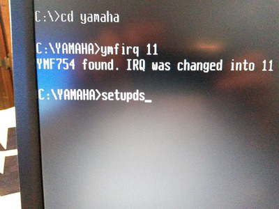

Reply 1 of 161, by Warlord

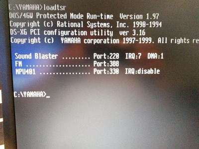

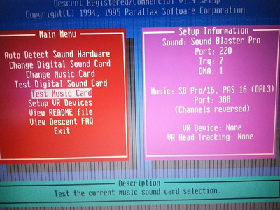

The XG implementation is that the codec sits on IRQ 11 as a PCI device and the legacy sound system is mapped to IRQ 7.
On my model the Geforce 2 go is mapped to IRQ 5 which isn't an issue.
Setting up the laptop so that you can use the XG in pure dos isnt that hard as long as you follow my advice.
I have tested Prince of persia, decent, doom etc all works fine. In decent you can use sbpro for effects and OPL3 as music. Though id recommend playing games that have General Midi in 98 under dos box because the native wave table of the XG is pretty good. It's quality is up there with Roland.

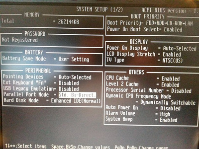

Guide here that should work on getting the 2805 series sound working in pure DOS and 98 properly that should apply to all the other models.

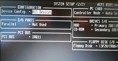

1. To go into BIOS press ESC and it will prompt you to hit F1.
2. 1st page configure parallel port as std-bi direct
3. Press page up or down to go into 2nd bios screen. You want to change Config to all devices instead of by os.
4. For parallel port select not used.

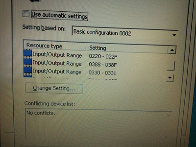

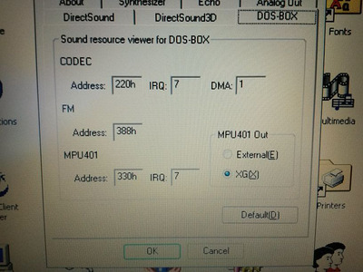

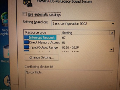

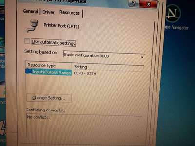

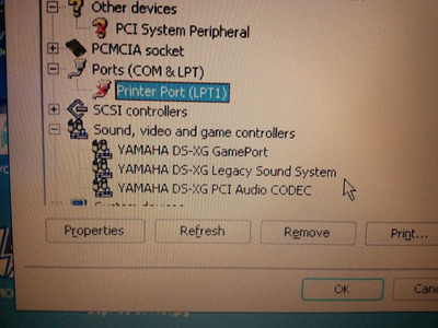

Windows Config
5. Install windows 98
6. You want to use the VXD drivers for windows I will link to to.
7. Go to device manager select the parallel port and manually change the resources. That means uncheck automatic settings.
go through the basic configurations until you find the setting that doesn't use and IRQ. On mine that is setting 003. Then Save that and I went ahead and disabled the port anyways.
8. for sound a video game controller you want to click on the legacy sound system, again you want to manually set the resources. Try Basic configuration 2. Change to IRQ7 DMA 1 io 220-220f, 388-038f, 330-0331f etc These are the like the default legacy values.

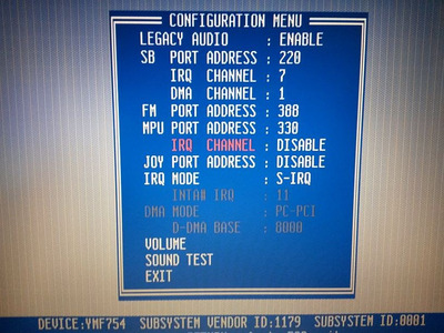

For Dos.
1. You have to use the modified 810/815 driver I'll link.
2. The SET Blaster Parameters. are SET BLASTER=A220 I7 D1 T4
3. I already configured this in the driver I am going to link here. But if you use the one off Phils computer page you need to change somethings to get it to work.
4. If you use some other driver than the one for here. Be advised that the one from phils has the wrong environmental variables set up in the batch file and you need to change that.
5. To configure you go "YMFIRQ 11" without quotes at the command prompt.
6. Type SETUPDS Change it to S-IRQ and then you can change it to I7 220 D1 ETC. With the driver I will link it should already be setup for you. Then save.
7. Then to run the driver you type Loadtsr at the command prompt that's all.

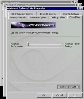

Custom Geforce go 2 9x driver ver 14.10 (/w power mizer feature, useful to down clock gpu, and multi monitor support)
Includes riva tuner 2.24 (use driver and riva tuner at own risk) (if not getting max performance check the power mizer by default its not full performance.

I recommend not running powermizer on full. If you want to use less power and less heat adjust lower. Obviously the oem driver always runs it at full, so its not a issue either way.
