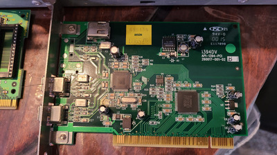

A quick introduction:
I've been a PC enthusiast for around 30 years now (well as much an enthusiast as possible back when I was 5) and my first build was an AMD K6-2 450 with a Voodoo 3 3000 PCI on Windows 98. I was about 13 at the time of that build. I had that computer for a while and did some small upgrades over the following several years before switching to a modern laptop around the Windows Vista timeframe.
In 2010 I purchased a pre-built HP Slimline and upgraded that as far as it would go over the next several years resulting in an I5-760 and a 750ti. I then put together a Ryzen 7 1700x system, then last year upgraded my my current Ryzen 7 3700X/5700XT rig. I have some PC experience, but not a ton. I'm certainly no IT specialist.
Anyway, I got an itch recently to visit my Windows 98 gaming days and finally made a purchase. Here are the specs I know:
Asus A7V rev 1.02
Athlon Thunderbird 1000mhz
512MB RAM (2x 256MB Kingman PC133)

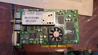

Radeon AIW 32MB AGP

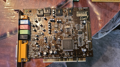

Sound Blaster SB0060 W/ Front Panel
CD-RW
DVD-ROM
3.5 Floppy
76.8GB Deskstar HDD 7200RPM
Sharp SH-300ATX PSU
Windows XP currently installed
Thoughts? Opinions? Advice? I really only have two big questions:

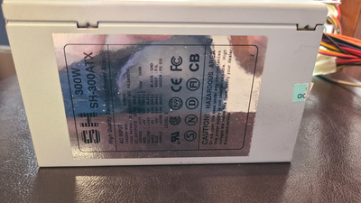

Should I risk keeping the PSU seeing as it's quite old?
XP is locked due to no password, is it worth saving the install? I have a Windows ME install disk but most of my games are from the Win98/98SE era. Should I save the XP install? Should I install ME? Or should I go with my goal of running 98SE?

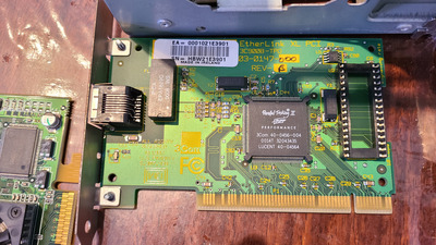

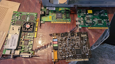

Thanks for taking the time to read this. Attached are pics for interest. I'm currently in the process of disassembling and cleaning it thoroughly. I may transfer it into a new case as this one affords no cable management and is also missing the top cover.

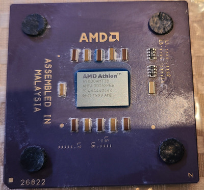

Reply 3 of 28, by omgfoz
Here is a picture of the Athlon 1000 Thunderbird Slot A CPU for future reference.

I second opening that PSU up, Iv seen a few of those SH powersupplies with really bad caps before. They are pretty decent other than the cap selection iirc, the couple Iv ran across worked perfectly after replacing a couple blown secondaries. That AIW card should make a great card, it looks identical to the 3 I have which are 32mb DDR Radeon 7200's.

One note should be made regarding ATX power supplies:
Earlier ATX specifications have higher amperage +5V rails than newer ATX power supplies, which are usually designed to provide most of their power through the +12V rails.
Be sure to check the +5V output of any new power supply you're thinking of buying for this computer to ensure it can supply enough current from its 5V rail to power your motherboard.

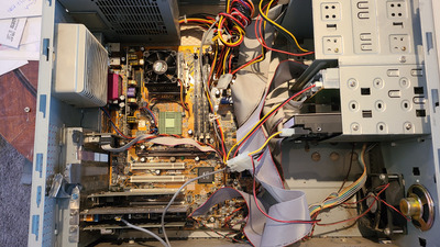

Reply 14 of 28, by omgfoz
So this thing i think has a major problem.
Boot up is very inconsistent. Sometimes it won't POST. Sometimes it will freeze after detecting the HDD through the promise controller. Sometimes it will freeze while showing the PCI devices. And I've even had it freeze while in the BIOS screen. Any troubleshooting tips?

Reply 15 of 28, by Repo Man11
I would: remove the motherboard from the case, strip it down to one stick of RAM and the video card (use a PCI video card if you have one) and begin there. Try Memtest 86. http://www.memtest.org/#downiso

Reply 16 of 28, by omgfoz
Repo Man11 wrote on 2020-12-26, 22:41:
I believe one of the sticks of RAM is bad. It booted immediately upon removing it. Now to see if it's consistent...

I would definitely check the condition of that PSU (but remember that it's not totally risk free if you have no idea what you are doing).
These boards are made for use with PSUs with beefier 5v lines, but the Thunderbird 1000MHz consumes less power than a 1400MHz one. Still more powerhungry than a Tualatin 1400. Btw, the part number (A1000AMT3B) denotes this is a 100MHz FSB part. 133MHz FSB parts would end with a C instead of the B. These CPUs can be unlocked using the pencil trick (google it if you're interested) but had some issues with multipliers above 12x or something (I don't remember the details anymore but I do remember that the pencil trick worked for me during testing). If you really wanted to, you could use the freed up multiplier to lower the multiplier to, say, 8x, netting 800MHz and reducing power consumption even further that way.
