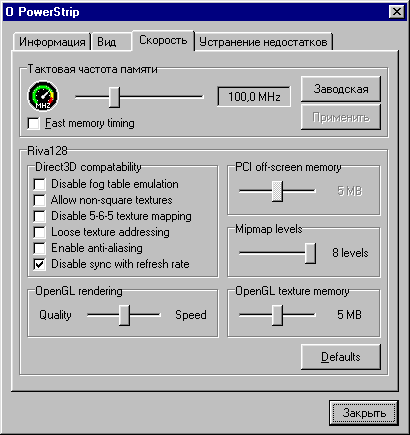

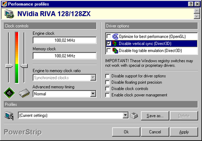

Video card Nvidia Riva 128.
How do I turn off vertical synchronization (vsync) in Direct3D games?
Reply 3 of 7, by Takedasun
Riva Tuner not support.
PowerStrip

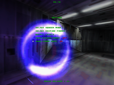

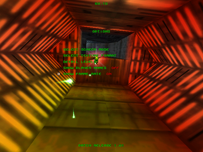

Frequency limited to 60 fps
