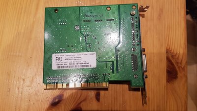

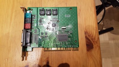

I got my hands on this sound card recently.
3.86 MiB
8444 views
3.9 MiB
8444 views
Sticker says ES1371 but there is ES1373 written to the chip itself, so either there was a mistake or they are the same chip. Anyone knows?
Would it be possible to make this card work in dos and where I could get drivers for it?

The Sound Blaster Live! DOS emualtion are based around the Ensoniq AudioPCI (ES1370, ES1371 and ES1373) DOS emulation so it will sound similar and have the same game support. Sound Blaster PCI are actually just rebranded Ensoniq AudioPCI and share the same drivers.

Hey, that card looks like an AudioPCI 3000, which I used months ago to make a SoundScape recording of Crusader: No Remorse! ^^

This was a real messy time for creative, as they also call it a Sound Blaster 64 PCI, You can read more about it here, but basically they just wanted the dos emulation drivers and didn't know what to do with the soundcard itself. Make sure you get the 8MB ecm file.
Ensoniq / Creative AudioPCI
So the SoundBlaster Live is the better card as amongst other things supports EAX and soundfonts but only marginally IMHO, being from the same era I would say it is a model up.
Your much better off getting an Audigy 1 2 or ZS, they still use the same Dos legacy files but the windows side of things are much more improved and support later EAX versions.

You've got yourself a common AudioPCI. It does have DOS drivers and they're all easily available. Enjoy the bad "FM"!

They are like the cheapest sound card 1997 could make which is what those big computer companies want. Along with some brand recognition in Ensoniq. Just an early AC97 codec on a PCI card with host-based MIDI, FM, effects, EAX and A3D processing that is designed with the limitations of a Pentium MMX in mind. They do sound pretty good for just playing back PCM though.

Yes, few different drivers exist
Different Versions of Ensoniq AudioPCI

You can try modifying the ES1371 driver with the vendor and device ID of your ES1373 with a hex editor.
Device ID (71 13) is located at D397h and vendor ID (74 12) is located at D39Ah in the "ES1371.SYS" file
