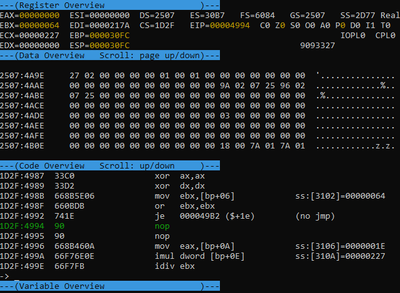

I try to go through the code of an old DOS game (some simulation game that i own on a physical optical storage medium (remember those?) trying to figure out some calculation the game does) and i am currently at a loss.
i'm sure its something obvious, but i can't figure out what i am missing here.
i am stepping happily through the code from some breakpoint i set a bit before and i am at this location:
25.27 KiB
40037 views
The instruction pointer shows 0x4994, which is the line highlighted in green. ok... so a NOP (which i learned is equal to xchg eax, eax) the AX register is set to 0x0.

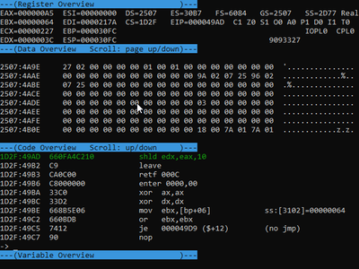

i push F11.... and this is what i get next:
24.62 KiB
40037 views
the instruction pointer is now at 0x49AD (i.... expected 4995....) and AX register contains now the value 0xA5.....
Does F11 not just execute a single instruction?
the host system here is Windows 10 (dosbox 74-3 binary downloaded from this very forum) if that matters 😀 i get the same behaviour on linux (dosbox built myself)with heavy-debug).
What am i not seeing here?
Thanks a lot
