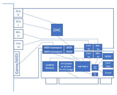

Updates:
1. SQ1500 schematics have been reverse engineered.
2. Based on various suggestions and thoughts, we're going for this:
33.88 KiB
2831 views
It's a very preliminary draft, mentioned parts may change, but the concept will stay the same: ultimate retro-aimed PCI soundcard with true OPL3 core and A3D 2.0 acceleration.
Any thoughts, ideas, suggestions and comments are welcome!

Reply 28 of 169, by matze79
Yes, where is it ?

Also, if you're using one of the YMF7x4 chips in your design keep in mind that unfortunately there's an issue with these chipsets and Miles real mode drivers for digital sound. Games that use Miles .ADV drivers crash when a digital sound is played. I tested with Dune 2 and some other games with a Yamaha 724 PCI card. DSDMA or SBLINK made no difference. Using SBDIG.ADV or SBPDIG.ADV made no difference either. Fortunately source code for these drivers are available so i wonder if this can be fixed, which could make the Yamaha 7x4 cards virtually 99% compatible.
Reply 30 of 169, by digger
@carlostex do the DIGPAK drivers have the same incompatibility? If not, you could try "patching" AIL-using games by replacing the Sound Blaster DAC driver with the Sound Blaster DIGPAK driver. DIGPAK drivers can act as AIL2 drivers, thanks to cooperation between John Miles and John W. Ratcliff back in the day. Look online for the file DMKIT150.ZIP to find the DIGPAK drivers. In addition to the SBLASTER.COM driver, there is also an SBCLONE.COM driver, specifically meant for Sound Blaster clones that aren't 100% Sound Blaster compatible. Perhaps the Yamaha 724 will work with that.
Alternatively to that, you could try patching these games to use the AIL2 bridge driver for VBE/AI (VESADIG.ADV) and then load the VBE/AI driver for Sound Blaster before launching such a game. You can find the VBE/AI driver online in an archive called vaisdk.zip.
Reply 31 of 169, by hard1k
cyclone3d wrote on 2020-11-28, 22:37:
Waveblaster header?
That is a very good question. I've been thinking about it for a week already, and to be honest I haven't come up with a solution yet.
If we place it on the little board, it will increase the height + the pins can mess with the other card in a shared PCI/ISA slot setup. And as it is my personal use case for this board, it's somewhat important 😀
If we place it on the bigger (upper) board, we'll have two options:
a) put it on the left side, right above the interconnector with the lower board (somewhat SQ2500 style, but higher due to the interconnection with the lower board) => the daughterboard will overhang from the upper edge, exceeding all standard measures for expansion cards, thus creating potential problems.
b) put it on the right side, close to the upper edge (MX300 style) => the upper board will get longer, thus overlapsing the lower board to the right. Nothing critical, but a bit clumsy.
So no decision yet.
carlostex wrote on 2020-11-28, 23:13:
Good info!
Does anyone know if there is some means to enable the SPDIF-In on the YMF7x4 in DOS? It would solve this specific problem - enabling the SPDIF-In we would enable the pass-through from the AU8830 chip that works nicely in SBPro mode.

Reply 33 of 169, by Pierre32
I know that with at least some YMF7x4 cards like the AOpen AW744L, the XG MIDI is not available in DOS. Will that be an issue in this design, and can it be addressed?

Reply 34 of 169, by cyclone3d
hard1k wrote on 2020-11-29, 20:44:
That is a very good question. I've been thinking about it for a week already, and to be honest I haven't come up with a solution […]
Waveblaster header?
So no decision yet.
Good info!
I have a maybe strange idea... what about making the card so you can configure what side the waveblaster header is on?
As in.. either have 2 sets of holes, each with a connector where you slip in a header block through from the opposite side or have one set of holes and some sort of way to configure which side the waveblaster card is being installed on.
Bonus points for having the card autodetect which side the waveblaster header is installed on... which shouldn't be difficult at all since the one side of the connector has multiple grounds. You would just need to have some sort of key so the pin block can only go in one way from each side.

Reply 36 of 169, by hard1k
Thanks for your interest! We've been quiet for some time but the works have never stopped.
So, to sum up, AU8810 has a different package than AU8820 and AU8830. So we had to bin that reverse engineering work and start everything from scratch.
We've completed the SQ2500 reverse engineering, got a nice YMF744-based card from Hoontech to double check Yamaha datasheet, and *almost* completed the 0.1a layout of the lower card. I was going to show it to you in a week or so. Also, we've agreed on Fortex as the project name.
So, stay tuned - we'll have some major news in a week or two, but then we'll put everything on hold till late June - that's when the required oscillators will be shipped to us.
