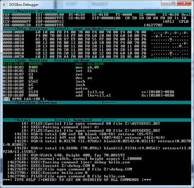

my second patch to svn 4448
added brakepoint at the hello world string with "BPMR 1dd:108 1"
but it seems that my read-checks do not reach the string bytes - do i still miss some read functions?
core=normal
    readb.7z
    260 Bytes
    124 downloads
    simple byte read
    mem_read_bp_2.patch
    17.27 KiB
    131 downloads
    svn patch for revision 4448
    42.01 KiB
    4043 views
    debug screen
    hello_world.7z
    303 Bytes
    130 downloads
    hello world test program
