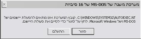

I'm pretty sure this is a VDMSound problem, and I have also attached the error message below. It's just your regular "16 bit MS-DOS Subsystem" error though.

Reply 6 of 17, by Og
I see, I thought you were just making a joke about the expression I used:
Sorry.
At any rate, I am very aware of the infamous autoexec.nt error, however as you can clearly see in the picture I have attached in my last post there is no reference to the aforementioned infamous file. The autoexec.nt error looks like this:
    13.33 KiB
    5440 views
    Autoexec.nt missing or damaged

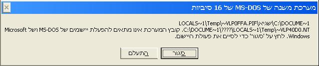

eL_PuSHeR: Sure 😀 (I'm assuming you mean the 1st error):
Title: 16 bit MS-DOS Subsystem
[1st line is the location of the temp folder with visible hebrew characters]
[2nd line starts with the location of the temp folder but with hebrew characters converted to question marks, followed by this text:]The system file is not suitable for running MS-DOS or Microsoft Windows applications. Choose 'Close' to terminate the application.
In other words, the text is identical to the autoexec.nt error, however, the files are generated(and generated correctly) in the temp folder. VDMS simply can't read them from there.

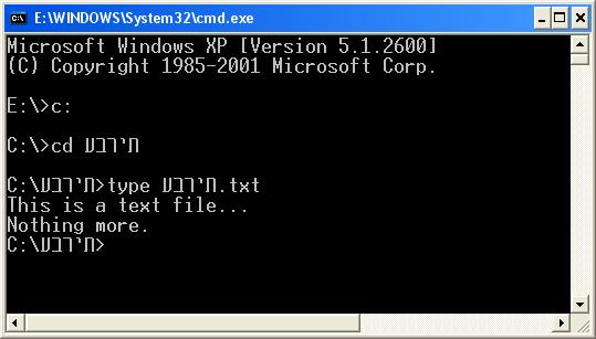

Oh, and NTVDM shouldn't have a problem with hebrew either:
    25.92 KiB

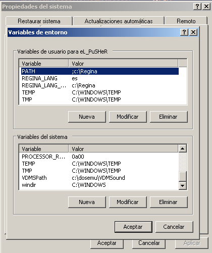

I have an idea that might work for you.
Right-click on My PC > Properties > Advanced Options > Environment Variables > System Variables > Make sure there is both a TEMP and TMP variables. Modify them accordingly.
Check image below. It's in Spanish, but I think you will get the picture. The idea is to make the TEMP paths variables using shortnames.
Make a System Restore point before, just to be on the safe side.
Also, you might need to uninstall/reinstall VDMSound again after making those changes.
    9.45 KiB

Reply 17 of 17, by vladr
Yepp, it's a Windows problem alright. LaunchPad generates a temporary .pif (that's Windows) file that refers to a temporary CONFIG.NT and AUTOEXEC.NT files, but Widnows gives the error you see when the paths to AUTOEXEC.NT/CONFIG.NT contain funny stuff.
NOW, the latest VDMSound from Vogons puts the short names inside the .pif file to go around this kind of problem (and other problems, such as long paths "C:\Documents and Settings\Very Long User Name" blowing the 64-char limit inside the .pif format) but Windows still screws up IIRC hence your error.
Temporary .pif files are kept about 5 seconds IIRC in %TEMP% so you can make a copy quickly before it's erased by VDMSound to check if it has the correct (short) paths inside and confirm whether Windows screws up despite that, if not then check 1) that you have a good VDMSound and 2) that short file names are active on your disk ("DIR /X" in a command prompt to see if dirs have both the long and short file names)
