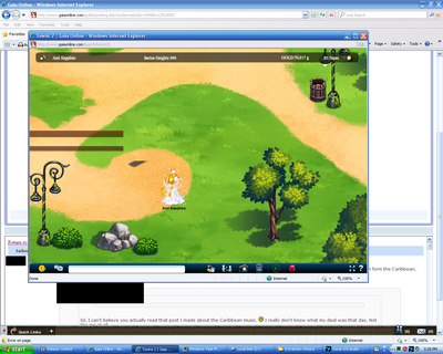

^ Pretty much my experience, not great. Didn't like certain Flash graphics, even with different GPUs (it was 2013; located and attached image, redacted usernames), and some programs would crash and burn upon attempting to run them... but I could run Youtube videos quite well back then, which nearly maxed both CPUs 🤣 [This won't happen nowadays due to more general modern web tech changes...]
System would also black out (rather than shut off) when both CPU temps reached a bit over 50°C, especially while in use; not sure if it was a fluke with my particular board or what.
Did eventually obtain two later Tyan AMD board models (S2877 and S2925) which are much better in comparison, though.
Windows Vista could also run on that board, but some DOS character garbage would show up on the display during transition to the desktop after booting.
    968.24 KiB
    1855 views
    Example of glitched Flash graphics on Tyan S2466N-4M - 20130608
