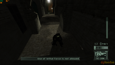

Reply 181 of 272, by lowenz
1) You *must* set the GeForce 4800 preset for Splinter Cell 1,2 - of course you must add an entry in the DGV Control Panel so please do NOT use any other "old" dgv config file
2) Not so well (but you can use them if you want, just backup the original ones)

Reply 184 of 272, by Dege
Indeed! I could reproduce one even at the very first level at the beginning.
It was introduced in 2.73, a fix for D3D9 proved to be incompatible with D3D8.
I re-uploaded 2.75 with the fix, plz download that.

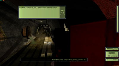

Reply 186 of 272, by eddman
daniel_u wrote on 2017-01-10, 15:19:
(CIA. Defense ministry). I managed to remove the specular reflections from the shaders. No more glitches but also no more (broken anyway)reflections, only for the specific areas. See attachments below.
Is replacing the textures the only way to get rid of this issue?
With the original textures, I tried 2.54 and the latest 2.75, with both 4800 and 5700, and the bug is present.
Reply 187 of 272, by daniel_u
eddman wrote on 2021-07-08, 06:53:
It seems so. But keep in mind, you are replacing the texture files not textures itself. The textures in the files have some shaders also. Some dont work right.
