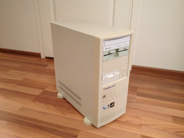

Brief description
This is a heavily modified system and my oldest still in active use. I believe it started out as a Pentium 233 MHz MMX with 32 megs of EDO RAM and an ATi Rage II. Now the only original parts include the case and the motherboard. The system runs a highly optimised Windows 95 OSR2 installation (see guide and tweaks).

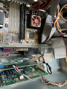

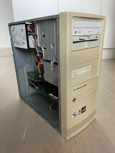

Reply 4 of 6, by leonardo

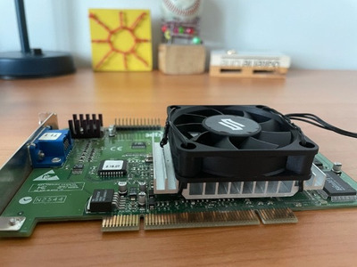

Inspired by speeddemon's recent Socket7 build, I decided to see if I could push my set up even further still!
First order of business was to deal with the fan noise, so I decided place a larger fan on the Voodoo3:
61.67 KiB
2478 views
After this I checked the RAM to see if I could consider bumping the front side bus speed from the officially supported 66 MHz clock to a higher rate and sure enough, found that when swapping out the EDO memory I had overindulged on the SD-RAM specs: 😀
40.21 KiB
2478 views
Here we have the patient with it's belly showing:
35.15 KiB
2478 views
I've joined the club of people who have these seriously large and powerful Noctua CPU coolers. 😎
64.65 KiB
2478 views

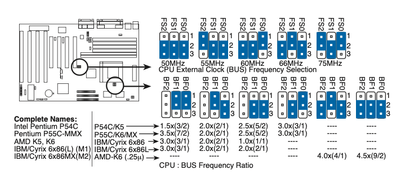

Many of the later K6-series CPUs were intended to run on newer so-called "Super Socket 7"-boards that supported a front-side-bus speed of 100 MHz. The CPU I bought to upgrade my system, for example, would utilise a 4x multiplier together with a 100 MHz front-side bus to reach its intended speed of 400 MHz. However, AMD cleverly included a work-around for users of older Socket 7 motherboards: if the motherboard was set to use the 2x CPU multiplier, the CPU would interpret that internally as 6x! This allowed the use of these faster CPUs on motherboards that maybe lacked the necessary multiplier or FSB settings.
My motherboard (the ASUS TX97-XE) is one that officially only supports a 66 MHz front-side bus speed and does not include a 6x CPU multiplier setting. It also needed an unofficial BIOS update to support the AMD K6-III+ 400 MHz CPU I'm using now.

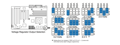

Overclocking on the TX97-XE
The K6-III+ mobile CPU is a special kind of animal. It uses a lower voltage than regular desktop CPUs (at the time). In fact, the specified 1.6V cannot by supplied by the TX97-XE motherboard I use in my configuration. The lowest supported voltage is 1.8V:
37.41 KiB
2401 views
However, a minor bump in the operating voltage is not necessarily an issue as long as the CPU is properly cooled and overvolting is often used when overclocking to ensure stable operation of the CPU. Hence, I was actually already set up to attempt an overclock by raising the front side bus from the officially supported maximum of 66 MHz to 75 MHz. speeddemon has his FSB set to 83 MHz, but besides being quite a substantial overclock, it's also one that I couldn't find any documentation for. Instead the 75 MHz FSB was clearly outlined in the ASUS manual for the TX97-XE:
44.63 KiB
2401 views

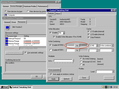

I applied write combining to the first reported framebuffer/video memory range based on what I read in William Jones' guide where he states that:
The 2nd MTRR1 row can be used if you have two graphics cards to enable Write Combining on that card also...
I used the memory addresses visible in Device Manager as basis for the settings in CTU, which confusingly gave me 32 MB worth of VRAM:
25.56 KiB
2458 views
This led to a substantial improvement in performance with and without overclocking:
AMD K6-III+ @ 400 MHz (6x66), 1x32MB range write-combining: 1392 points
AMD K6-III+ @ 450 MHz (6x75), 1x32MB range write-combining: 1441 points

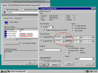

Following my intuition, I decided to perform two more benchmarks. In the first one, I enabled write-combining for each of the reported 32 MB memory ranges allocated to the Voodoo3 according to Device Manager:
27.83 KiB
2458 views
I knew all of it would not be video memory and thus did not expect to get the result I got:
AMD K6-III+ @ 450 MHz (6x75), 2x32MB range write-combining: 1564 points

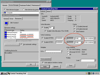

In my second experiment, I made the assumption that both memory ranges would start with local VRAM, but that the remainder of the range was just system RAM allocated for textures (sort of like AGP aperture). If I was right, I could enable write-combining for only the first 8 MB of each memory range (totalling the 16MB on the Voodoo3) and still achieve the same performance as when I had write-combining turned on for the full 64 megabytes of allocated memory:
27.79 KiB
2458 views
...and the results are in(!):
AMD K6-III+ @ 450 MHz (6x75), 2x8MB range write-combining: 1556 points
The difference between this and the previous results are within margin of error, which in my opinion indicates I have the right conclusion. This is further confirmed by the fact that I got a lower score when I only enabled write-combining for the first memory range, even though I had designated a complete 32MB range then. 😎
Conclusion:
For optimum results on your K6-II/K6-III based system, you should enable write combining so that both video memory ranges are included, but so that the two ranges together add up to the total amount of local video memory on your card.*
