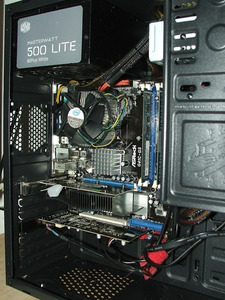

Some photo of the build beside the liquid cooling failure.. I wanted to buy today a GT710 PCIe today but having the GT610 it wasn't a good idea so I think I'll boost it with a GT1030 but in future.. for now it has 8GB DDR3@1333, SSD and the Xonar D1 sound card connected to a old still working home theatre audio amplificator. Too bad the vga heatsink (Point of View brand) block the PCIe x1 bus I could use a USB3.0 adapter into it.. I suppose I might go for the Q9650 one day on air cooling... I was always right of not wanting any of these liquid cooling system. 😉
That vga on the GF119 chip @40nm really need an active cooler on it, even after changing the thermal paste the temps are always above 50°C and goes up fast and too much without a case fan on it. That's why the GT710 chip @28nm might have been a cooler solution but still quite limited even on such old config. The right card for this would really be the GT1030 GDDR5 maybe single slot.
