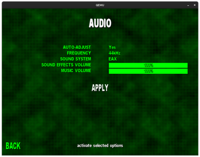

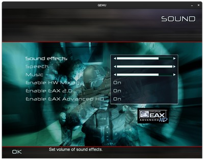

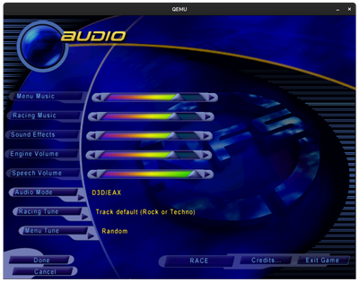

Here's some of the tested games:
378.51 KiB
2412 views

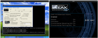

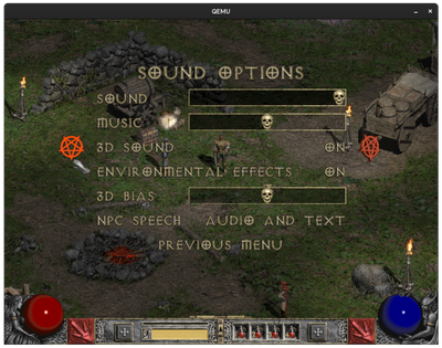

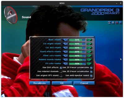

Serious Sam TFE
405.23 KiB
2412 views
Need for Speed 3
896.34 KiB
2412 views
GrandPrix 3 Season 2000
795.17 KiB
2412 views
F.E.A.R
1.38 MiB
2412 views
Diablo 2
GrandPrix 3 Season 2000 is a fantastic game with EAX audio effects fully upgraded from the original GrandPrix 3.
F.E.A.R is probably another fantastic EAX game and the audio effects add to the horrific atmosphere.
The rest, I am not quite sure, probably just a "feel-good" checked mark "Yeah, I have EAX on my VMs for Windows games".

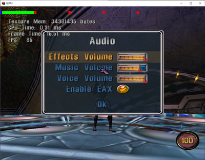

Reply 1 of 8, by kjliew
Tomb Raider Angel of Darkness is another great EAX games.
892.79 KiB
2404 views
TR AoD
This game played at 60FPS on Ryzen 2500U at 1280x960 32-bit color and max details, including all EAX sound effects enabled on ArchLinux x86_64. 😉 Absolutely fun & enjoyable from the comfort of highly portable thin & light ultrabook.

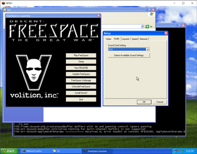

Reply 2 of 8, by kjliew
Descent: FreeSpace The Great War (1998)
386.96 KiB
2368 views
Freespace-EAX
Other than Mechwarrior 2 31st, this is another masterpiece that I would never be tired of replaying through the campaign. Great story that I still cherished today, fantastic graphics and in-game animation. It was a rare game released into Win95 era with support for WinNT 4.0 with DirectX update. That made it an easy game to run in later Windows OSes compared to Mechwarrior 2 31st 3Dfx. It also supported 3Dfx Glide in addition to a very good Direct3D implementation. I have been able to replay the game on WinXP & Win7 with native Direct3D. A community sourceport is available but I always prefer the originality of retailed CD version.
The final official patch 1.06EAX brought 3D sound and EAX audio effects to this wonderful game. However, I have never enjoyed the game with 3D sound and EAX audio effects even though I had a SB Live! back then. The game called for minimum requirements of Pentium 133MHz but if anyone would be a fool to ever believe that. I first played the game on Pentium MMX 200MHz w/ Voodoo1. It was OK until the very last few missions. Enabling EAX on SBLive! on that machine just trashed the game experience regardless of how good it might sound. By the time I could afford more powerful system to play it again on WinXP / Win7, I already trashed the SBLive! and just used motherboard audio. Such experience made the so-called "period-correctness", building retro PCs for games ... bla ... bla ..., an utter joke for the best game experience. 🤣 Oh, no thanks, I want the best CPU/GPU, high quality IPS panel and ultra-fast SSD storage.
Today, thanks to QEMU virtualization I can replay the game at maximum quality beyond the game presets "Very High", scaled at any resolution from the game's only supported 640x480. I can play it on Windows 10 and Linux. DSOAL & OpenAL Soft now bring 3D sound and EAX audio effects to complement for the ultimate game experience on QEMU Windows XP VM, yeah 😁!

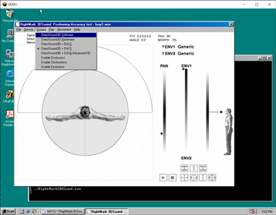

Reply 3 of 8, by kjliew
Yeah! 😁 It's DONE. DSOAL EAX for QEMU Win98SE VM!
202.26 KiB
2328 views
EAX for Win98SE VM
And this one works across all legacy Windows VMs before Vista, Win98/2K/ME/XP.
There is still one last puzzle to solve, but it is an easy one which happened to be the same problem for DDRAW in case of WineD3D -- DLL pinning into memory. So far, all 32-bit Windows VMs including Win7 and Win10, except for Win2K, will pin DDRAW.DLL into memory. This is the problem of 2 DDRAW DLLs, one from the OS and another replacement dropped into game folder. The OS seems to remember exactly the name "DDRAW.DLL" and there is no way to run another DLL of the same name without rebooting the VM. Apparently dgVoodoo2 or any dxwrappers would have the same problem or maybe not for 64-bit Windows. The same DLL pinning applies for DSOUND.DLL but this time only in Win98/ME, Win2k/XP do not seem to be doing it.
So since this can be a completely guest-side implementation (just CPU processing for EAX), perhaps it is also a great news for Marvin folks for beef-up Windows 98SE retro PCs to get EAX support from on-board AC97 audio with WDM audio drivers. No more crappy SB Live! or Audigy PCI that hog the PCI bus, especially on non-Intel chipsets PCI implementation. Not all EAX games will have EAX support from DSOAL though, YMMV.
