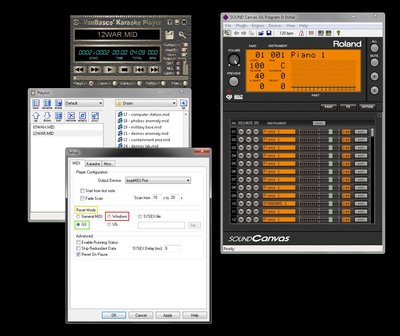

Reply 144 of 780, by James-F
Okay I found your problem.
It's Windows Media Player. Why do you use this awful thing? 😵
Please download a good midi player that lets you select the Reset command (GS) before each song: http://www.vanbasco.com/karaokeplayer/
When I select Windows in reset settings (image) I get the same problem as you do.
PLEASE remove windows media player from your PC immediately! 😊
EDIT:
Actually windows midi players don't send ANY reset SysEx message, therefor the next song you play suffers from this.
AVX, I see you also struggle with your Player not Resetting SC-VA after every song; the link to a good player is here.
The attachment Midi Player Reset.jpg is no longer available

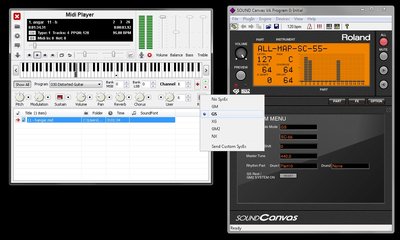

Reply 146 of 780, by James-F
I bump this for thecrankyhermit and avx.
thecrankyhermit,
Actually you CAN select Map when in GM or GM2 mode.
There is a bug in 1.02 where the Map Mode drop menu (Options) does not work when GM or GM2 selected, but the ALL-> ARROWS still do!
Options -> System, just look at Map Mode.
Now Select ALL and press the Left/Right arrows on the main GUI.
avx,
Stop struggling with player (WMP) that does not send a Reset Sysex every song, and download http://www.vanbasco.com/karaokeplayer/.
This will let you choose the reset type (GS,GM, XG, Windows, SysEx), and even reset when paused which prevents hanging notes.
This one is also very good and automatically sends Reset every song:: http://falcosoft.hu/softwares.html#midiplayer
The attachment Midi Player SysEx Reset.jpg is no longer available
