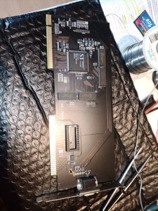

Reply 143 of 266, by Madao
yes, your notice about 64bit bus is right, but it is not important for performance in DOS-Game (because it use often only 16bit Memory bus ) (except VESA Mode)
Trio64V+ with 0 WS is fast as ARK1000VL in VGA/letter-mode.
By Windows-acceleration is Trio much faster than ARK and Vision96x is superior by windows acceleration. ARK1000VL lose totally by windows acceleration.
Difference between lowperformance card and highEnd VRAM Card grown with resolution and color depth.
Windows acceleration, Vision968 VLB is fastest card. VGA/letter, ARK1000VL / Trio64V+ (765) zero WS is fastest.
probably is S3 Trio64 (764) with modified BIOS (zero waitstate) very fast, same as Trio64V+(765)
I must check my S3 Trio64 from SPEA.
I can tell: STB Powergraph P64V ROM doesn't using advantage of 45ns DRAM. I have check it on my homemade Trio64V+ VLB card. no problem with "too slow" DRAM

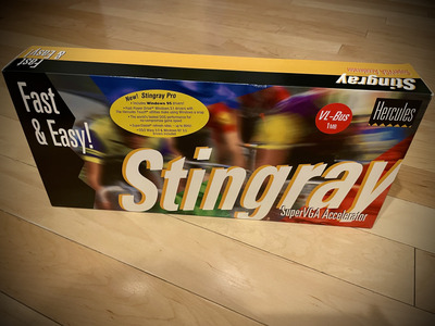

Reply 148 of 266, by Chadti99
So did Hercules or Ark know for sure they had the fastest VGA/DOS performance out there at the time?
The marketing stating:
“The worlds fastest dos performance for no-compromise game speed”
Reply 149 of 266, by pshipkov
I am sure they did.
It is unlikely they spent top $ for R&D, productizing, marketing and so on without surveying what's out there and measuring against the competition.
But that label on the box is just marketing.
Every box has one of these.

Reply 152 of 266, by TheMobRules
That label is curious, I don't remember seeing marketing information targeted towards DOS gamers on VLB (and older) video cards at all. Most of them seemed to focus on how good the cards were for CAD applications or Windows performance, if they were also good for DOS games it was more of an unintended consequence that they didn't care about.
Only with the advent of 3D cards did PC gamers actually become a marketing target... I think that may be one of the reasons of the success of Creative Labs in those times: despite the dubious quality of their products, they focused on gamers which were kind of "second class citizens" of the PC world and found a niche.
Reply 154 of 266, by BitWrangler
Or they sent different stickers to different markets.

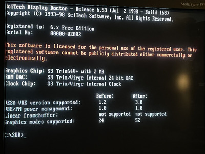

Reply 155 of 266, by Chadti99
Well dang, not seeing ARK level dos performance on the Trio64V+, not yet. SDD isn’t working well on it and the screen is rolling in “vid_mode 11” in Quake. Best I can tell I’m hitting 29.0 fps in 1.08. The ARK can hit 30.3. More testing needed.
Also SDD isn’t detecting LFB support. Although no difference when I force it on.
Reply 158 of 266, by Anonymous Coward
There were two vlb stingrays. The standard one used ALG chipset. The pro had the ark1000. Is that box for the alg version?
Reply 159 of 266, by imi
it says "Stingray Pro" on the oval, I'd assume they both had the same box and the ark one got that sticker.
Hercules naming schemes back then were sometimes confusing, there's multiple cards sharing the same names... same for some Diamond and Spea cards too.
