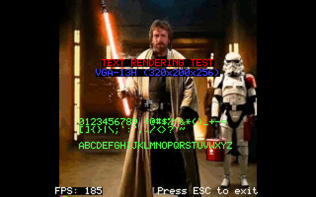

A compact library for efficient text rendering in graphics modes.
Built-in 6x8 bitmap font with 95 ASCII characters.
Support for transparent or solid backgrounds.
Demonstration of overlays, animation, styling functionality in all graphics modes.
The test may appear simple - a mostly static display with only two dynamic elements - a frame counter and a scrolling text block, but it reveals several interesting subtleties.
To achieve the best possible performance across different graphics modes, the test employs two different rendering strategies, so the results are not strictly an apples-to-apples comparison.
In CGA and VGA-13H modes, partial-region restoration is used because their memory layouts make small updates efficient, whereas EGA and VGA-X/Y modes have overhead from frequent plane switching on partial updates, so full-screen blitting is used instead. This approach results in 4 memory copies and 4 plane switches per frame, otherwise frame rates would drop into the 20–40 fps range. Even with this optimization, planar graphics modes remain significantly slower than CGA and VGA-13H.
Understanding these implications is important to extract maximum performance from each hardware configuration.
The test results confirm it:
VGA-13H: 190 fpsCGA : 150 fpsVGA-Y : 125 fpsVGA-X : 110 fpsEGA : 90 fps
The 40 fps difference between CGA and VGA-13H modes comes from handling CGA's interleaved data organization and pixels packing - 4 pixels per byte.
The 20-30 fps difference between EGA and VGA-X/Y modes comes from handling EGA's row-major data organization and pixels packing - 2 pixels per byte.

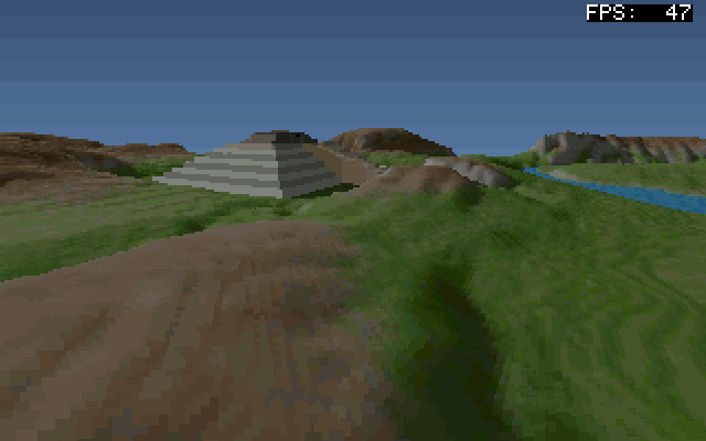

NovaLogic's Comanche: Maximum Overkill videogame (1992) was groundbreaking title with its voxel space engine, written entirely in assembler and so well optimized that it could run on a toaster.
The VXL module implements the same rendering technique.
Technically it violates the library’s design goals and requirements - C‑only code, 286 CPU support, and real‑mode DOS - so it almost didn’t make the bake‑off list, but decided to include it anyway.
Pure C proved too slow due to the legacy compiler limitations, so the critical rendering paths use inline assembly for acceptable performance.
The framerate is still below what Comanche achieves, matching it will require writing the entire render loop in assembly, which is even more out of scope for this library.

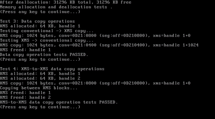

Terrain is defined by square height and color maps stored in XMS memory (too big for conventional memory) and accessed directly via unreal mode (FS/GS segment overrides).
The test is in the form of an interactive application in which the user controls a 3D camera exploring the world and can toggle z‑depth / rendering LOD modes.

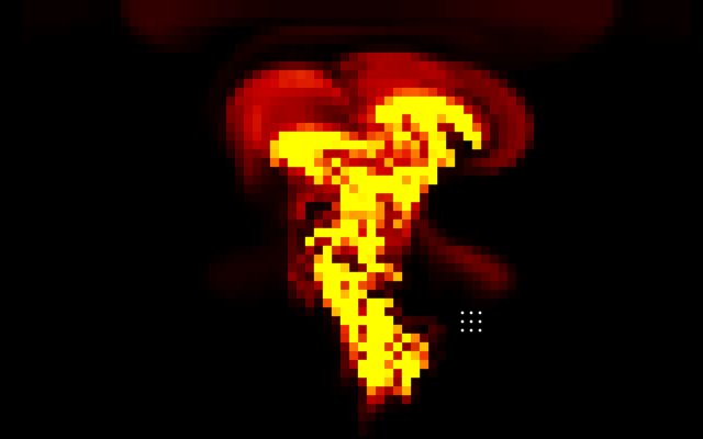

2D Navier-Stokes incompressible fluid dynamics solver (CFD) based on Jos Stam's "Stable Fluids" paper.
- Gauss-Seidel iterative pressure solve
- Semi-Lagrangian advection, configurable viscosity / diffusion / dissipation
- optional boundary handling
- gravity with density-proportional buoyancy
The test demonstrates interactive density emission into the voxel grid.

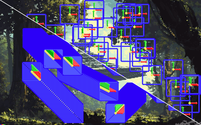

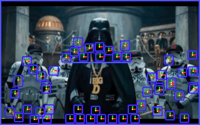

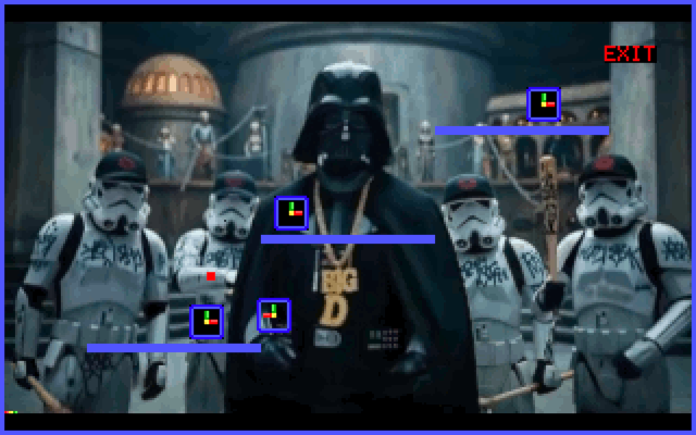

Point-Based Dynamics (PBD) solver for rigid body simulation.
- deterministic semi-implicit Euler integration
- iterative impulse-based resolution with friction + restitution
- circle and axis-aligned rectangle colliders
- compact pools (64 bodies / 64 colliders by default) that fit in conventional memory
- optional collision callbacks for begin/end/static-overlap event
The test demonstrates interaction between dynamic rigid bodies and static colliders, with and without gravity.
Visual representation of the simulation with sprites in VGA-13H graphics mode.

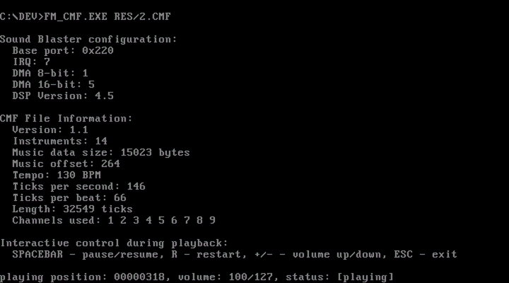

Direct hardware control of the PC internal speaker via Intel 8253 PIT.
Tone generation, musical sequences, and system beep functionality.
Optimized for retro game sound effects and simple audio feedback.
3 libraries covering the following areas:

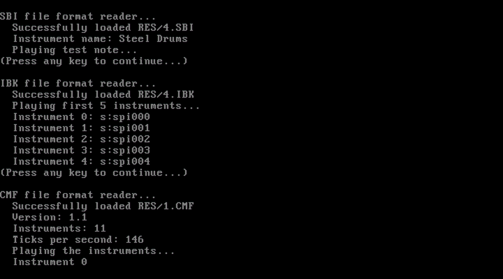

- instrument and music data loading from SBI (Sound Blaster Instrument), IBK (Instrument Bank), and CMF (Creative Music Format) files.
- complete FM synthesis control for Sound Blaster (OPL2/OPL3) and compatible hardware, including tone playback, instrument handling, volume control, etc.
- realtime music playback for the Creative Music Format (CMF)
Demonstration of baseline functionality - playback of tones, instruments, etc.
Demonstration of realtime playback of Creative Music Format files.

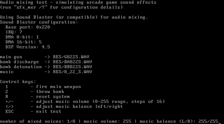

6 libraries form the framework:
WAV file format loading library.
Provides complete header parsing and sample data extraction.
Supports full RIFF specification including PCM, A-law, Mu-law compression formats.
Optimized for DOS conventional memory constraints:
- batch loading from files on disk
- streaming from files on disk or memory buffers

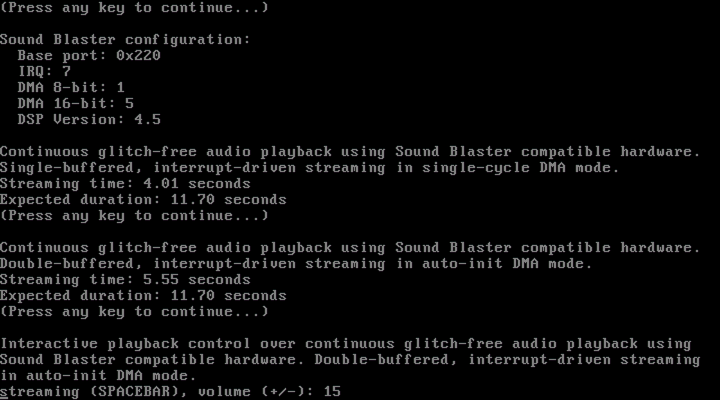

Sound Blaster core library.
Provides fundamental Sound Blaster detection, initialization, and DSP control.
Supports Sound Blaster 1.5, 2.0, Pro, 16, and AWE32 variants and other compatible hardware.
Digital sound effects foundation library for 16-bit DOS mode.
Builds on the SBR core library to provide shared functionality used by the higher-level audio modules listed below.
- DMA controller setup and management (single-cycle and auto-init modes)
- interrupt handler installation and removal
- hardware capability validation for WAV format compatibility
- DSP command constants for 8-bit and 16-bit audio control
- buffer size calculation and adaptation utilities
- extensive floating point optimizations
Continuous playback through the PC speaker using 1‑bit audio (bit‑banging method), via double‑buffered, interrupt‑driven streaming.
- chunked streaming of WAV files from files on disk or memory buffers
- down-sample and fold multi-channel / multi-bit PCM to 1-bit output
- timer IRQ driven playback with optional looped playback
- double-buffered 1-bit output to avoid ISR starvation
