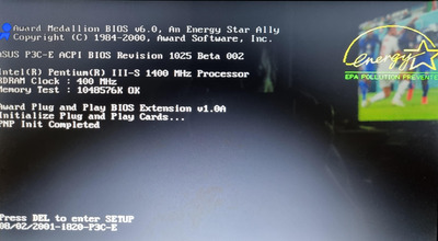

Reply 161 of 395, by karakarga
Operation finished successfully! 😀 Thanks again Deniz....
    556.67 KiB
    1881 views
    1.11 MiB
    1881 views

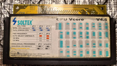

Reply 165 of 395, by karakarga
Asus CUBX-L is a Socket 370 based mainboard. I have checked CPU support page, there is no Cyrix processor support for your mainboard at all. Their cache amount is different from time to time. For example: Cyrix 386 processors have 1kb cache, but Intel and AMD has not any at that time. If your mainboards bios + engineering not build for that, there might be misinformation at bios screen. There are special jumpers on various slot 1 to socket 370 adapters for Cyrix processor support. Some of those are only for Samuel, not for Mojave. There might be more options from other vendors as well. Only bios modification may not help for full support! Here on the picture, there are 3 special jumpers seen on Soltek adapter.
Note: Those voltage part of jumper setting are the same for Asus S370-L (if jumpers present), S370-133 and S370-DL adapters, if one needs to set 1.3 to 1.45 Volt & 2.7 to 3.5 Volt for those Asus adapters, they can look on this Soltek's "SL-02A++" adapter picture as a reference.

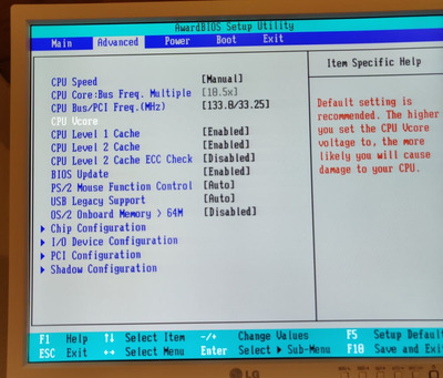

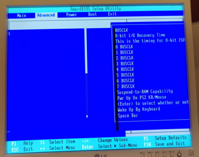

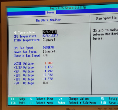

Dear DenizOezmen,
thank you for your great efforts!
I have encountered a problem with the Beta 1008cu004_20221210.1 of the ASUS CUBX 1.02 when using a modified Tualatin 1.4GHz SL5XL.
The CPU works on my other boards.
The problem:
The VCORE is automatically set to 1.98V and cannot be changed.
144.87 KiB
1516 views
When opening the VCORE menu, you only get a graphic error and the left side of the menu disappears.
124.49 KiB
1516 views
94.9 KiB
1516 views
With a Pentium III 933MHz, however, everything works.
Many thanks and best regards
Reply 173 of 395, by DenizOezmen
Hi,
RaVeNsClaw wrote on 2023-01-06, 19:38:
The problem:
Wow, that is bad and shouldn't happen. Thanks for notifying.
I couldn't reproduce the problem exactly the same way, but there seems to be something wrong with the dynamic patch that determines the upper VCore limit. I've changed the code to be less intrusive. Could you try this? (Obviously, the Tualatin CPU shouldn't be running in this board with the old mod build ...)
In the meantime, I'll be pulling the other builds until we're sure the new build works.
[Edit: Moved attachment to first post.]

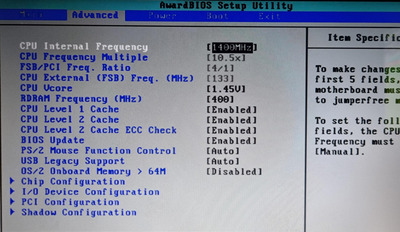

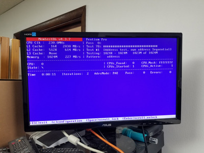

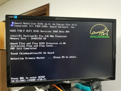

Reply 179 of 395, by maxtherabbit
DenizOezmen wrote on 2023-01-07, 09:20:
maxtherabbit wrote on 2023-01-07, 02:00:
I can't seem to find the P3B-F BIOS anymore... even the version prior to the VCore change...
I was going to try flashing mine tomorrow 🤣
Sorry about that!
Until the bug has been confirmed resolved, here's the last released build before the possibly problematic change.
2x115MHz FSB‼‼ Working like a charm‼‼
1.25 MiB
1404 views
1.22 MiB
1404 views
