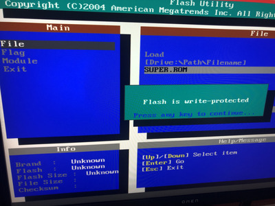

Tried the amiflash utility.
It says bios is write protected.
I am running out of options, maybe I have to give up and wait forever for an Intel chip to reach me from China….

Sorry, I probably have misinterpreted your description. For some reason I thought that the BIOS is forcing you into an embedded flash recovery utility on each boot and you had to abort it to boot into OS.
I have checked the bootblock code - it seems to support only Intel 82802AB:
10007939C E807A5 call 0x38a6 ; send program command 20007939F E8E2FF call 0x9384 ; send reset command 3000793A2 1E push ds 4000793A3 6657 push edi 5000793A5 6A00 push byte +0x0 6000793A7 1F pop ds 7000793A8 66BF0000FFFF mov edi,0xffff0000 8000793AE 67C60790 mov byte [edi],0x90 ; read ID command 9000793B2 678A07 mov al,[edi] ; manufacturer code 10000793B5 678A6701 mov ah,[edi+0x1] ; device code 11000793B9 678A7F02 mov bh,[edi+0x2] 12000793BD 8AD8 mov bl,al 13000793BF 665F pop edi 14000793C1 1F pop ds 15000793C2 E8E2A4 call 0x38a7 ; empty func 16000793C5 C3 ret 17 180007929D E8FC00 call 0x939c ; see above 19000792A0 3D89AD cmp ax,0xad89 ; Intel 82802AB, 4Mbit 20000792A3 58 pop ax 21000792A4 5B pop bx 22000792A5 C3 ret
So without doing any modifications this is the only chip that can be used for write and erase operations.
However replacing the ID check at 0x792A0 is easy, so it can be modded to support another FWH flash if the set of supported commands matches Intel's: FF - reset, 90 - read id, 70 - read status, 50 - clear status, 20 - block erase, 10 - program.
PM49FL004T-33JCE only has a JEDEC-style command set, so it won't work.
Atmel AT49LH004, SST 49LF004C, ST M50FLW040 support Intel command set, so they should (if package and electrically compatible, I haven't checked that) work on a modded BIOS.

Unfortunatelly no, I don't know much about AMI BIOSes.
You would need to replace bytes "89AD" with "1FEE" at 0x7929E in the uncompressed code and at 0x5EA in the runtime (compressed) module. But I don't know how to recompress the module and update the checksum.

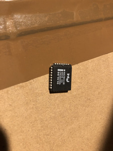

There is exactly the same bios file of the PM49FL004T, loaded with the same Xgecu programmer.
There are no differences at all.
Plus, the Xgecu T48 is able to spot problems on the chip, and all of three are fully recognised, correctly erased and with all pins ok.
What I am experiencing is pure non sense.
Or this motherboard for unknown reasons does not want its own Intel bios chip type anymore…

Weird things often happen when someone's using Ali Baba's cave 😀 You order exact chip model, but you get some sanded and relabeled "compatible" chip.
Did you tried kmeaw's modified BIOS for the Atmel AT49LH004 chip?

I do not think so.
The chips seems original, it is not easy to replace the writings on it.
Plus, the programmer would spot differences or errors. It is not a basic ch341a thing.
There is not use in trying a different bios.
