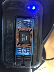

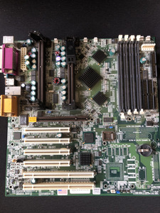

Hello,
I found this nice piece of hardware and could not resist... It won't work of course.
First thing I noticed is a nice "D" on the bios chip, probably means damaged.
In fact It gives me error on my T48 programmer, so it is better if I start looking for another one.
It is an Intel N82802AB, probably, as the writings are not super clear.
So it should be a 512Kb 64x8, but there are also voltage parameters that I am not super certain of.
Thing is that I do not want to fry the chip and lose time, can you confirm that this one will be ok? (AT27LV512A)
https://www.mouser.it/ProductDetail/Microchip … v2TLXL8GA%3D%3D
Thanks

Reply 1 of 74, by Horun
Mamba wrote on 2024-11-06, 13:30:
It is an Intel N82802AB, probably, as the writing are not super clear. So it should be a 512Kb 64x8, but there are also voltage […]
Thanks
The AT27LV512A-90JU is a "one time programmable" or OTP and is not laid out in 64k blocks, it will not work properly as a replacement.

Reply 3 of 74, by Horun
I found nothing as a replacement.

It is a specialized serial eeprom that only Intel made (or had made afaik) and is 4mbit (512kx8). I see them on ebay and aliexpress.
datasheet: https://pdf.datasheetcatalog.com/datasheet_pd … nd_N82802AC.pdf
The Intel N82802AB8 appear to be an upgraded version but no good pinouts found for it.

I ordered this
PM49FL004T-33JCE
From what I understand should have the same spec. No?
Reply 8 of 74, by Horun
Mamba wrote on 2024-11-06, 21:25:
I ordered this
PM49FL004T-33JCE
That has same general pinout and says "Read compatible to Intel 82802 Firmware" so yes it could or should work ok once programmed.
Only thing missing is the random number generator but not sure what function it has for your board..
Nice find !!! It did not show up on a eeprom cross reference chart...

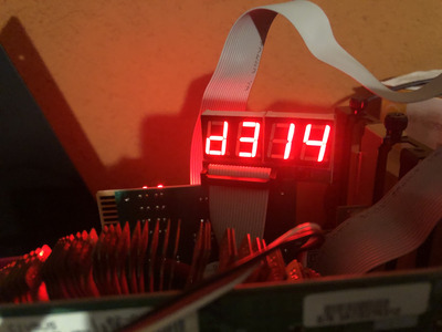

Ok here the update.
I flashed the compatible Eeprom and booted the motherboard.
Black screen at first but my post card was scrolling numbers so I said to myself that the motherboard was alive.
I tried different sticks of ram and gpu.
I figured out that with a gpu on the agp slot the board won’t post.
So I put a pci gpu and it boots.
I receive the message “checking nvram…. Update Failed”
But I can enter XP.
So I assumed that flashing with an external programmer is not enough.but using the flash program bundled with the bios I have the message “NO FLASH ROM PRESENT” ????
What can I do?
Reply 11 of 74, by Mamba
When I put an AGP card, there is no post and I obtain this code:
d3 14
All LEDs are on.
Reply 12 of 74, by Horun
The Reset LED is on ? D3 is "start memory sizing" and 14 is "timer test" from the 1995-97 AMI code pdf.
Maybe something wrong with the AGP slot. How much ram is installed and what AGP card ?

Reply 13 of 74, by Mamba
Horun wrote on 2024-11-17, 21:32:
Maybe a memory or resource conflict...
There is no reset led on.
The system boots fine with a pci card.
I tried different gpus and I obtain the same message.
Still those messages make me think.
My feeling is that the external flash process (or using Uniflash also) does not flash the chip in the proper way.
I need to find an Intel Eeprom or a way to fool the modified amiflash program.
Open to suggestions

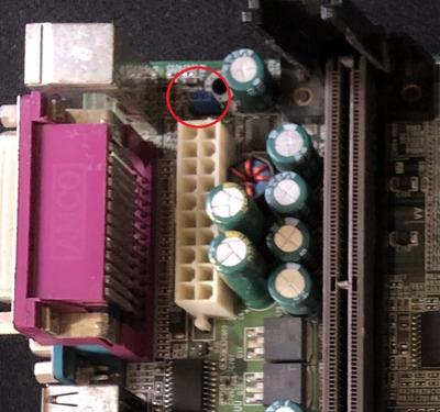

Reply 14 of 74, by luckybob
Check the board for a jumper. as I recall Supermicro still used a jumper to lock the bios and thus prevent anything from flashing a chip. It might also be in the bios settings, oddly enough. SM made good documentation, the manual should have detailed step-by-step instructions.

Reply 16 of 74, by Mamba
luckybob wrote on 2024-11-17, 22:59:
"Universal AGP" is woefully NOT VERY universal. Many AGP cards will fit and not work correctly. Also, when a board will boot from PCI but not AGP. The board is either physically defective. AND/OR the caps that feed the AGP slot need replaced. Once I confirm a working agp card, and its still horked, i start looking at caps. thats been my experence.
Thanks but I do not think that a jumper on the motherboard can prevent me to flash the bios on an external programmer.
Plus, I also used Uniflash and the process was successful.
Still I got the message checking nvram update failed.
Will look for this jumper anyway.
Edit: the manual talks about a JP6 to be disabled before bios recovery but I am not able to find it and the manual itself in jumper description jumps from 5 to 7…. No 6.
Tried the bios recovery method as well, it loads the bios and then I get 7 short beeps (repeating), that I guess is an error.
I am strongly convinced that the bios is not correctly loaded and this somehow prevents the AGP to properly work.

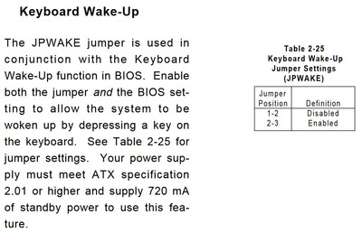

Reply 17 of 74, by PC Hoarder Patrol
Mamba wrote on 2024-11-18, 05:31:
Thanks but I do not think that a jumper on the motherboard can prevent me to flash the bios on an external programmer. Plus, I a […]
According to an older manual version, JP6 & JPWAKE are the same (see pic & table)
The attachment JP6_JPWAKE.jpg is no longer available
The attachment OLDMAN_JP6_JPWAKE.jpg is no longer available
"EMERGENCY BIOS RECOVERY PROCEDURE
1. Turn your system off and place the floppy disk with the save BIOS image file (see above procedure, step 5) in drive A.
2. On your keyboard press and hold "CTRL" and "Home" low-level BIOS flash hot keys. (You need to disable "keyboard wake-up" function via jumper JPWAKE.)
3. Turn on power with the hot keys depressed until your floppy drive is accessed. Your screen will remain blank until the BIOS program block is flashed.
4. If your system either reboots or displays a message to reboot system then the procedure was successful.
5. If the recovery procedure was not successful, please contact our RMA department for replacement."

Great,
Will try this
Edit: There is no jpwake either….
Edit-2: I locaterd the Jp6 jumper on the motherboard, it basically allows to let me start the bios recovery function, if I move it, the process won't start. So at the end of the day the problem remains because I hear 7 short beeps and code F4 (the AMIBOOT.ROM is not the correct size).

...JP6 = Keyboard Wakeup = JPWAKE
