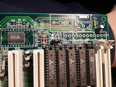

Reply 26 of 40, by quicknick
Played a bit with the board and a multimeter, the external battery header seems to be wired exactly the way Deunan described (pin 1 is the one closest to the Odin chip).
Searched through the pics that I took while repairing the board, and there was initially a jumper on pins 2-3. I believe that my first attempts of powering the board after repair were with that jumper in place, but not 100% sure, that's why I will revisit this board when/if I'll have enough free time, to give it the attention it deserves 😀
As I mentioned earlier, connecting the CR2032 holder between [ext.bat. pin 1] and [barrel battery negative] is exactly the same as connecting the 2xAA holder between pins 1 and 4, so I cannot imagine now why it didn't work.
I couldn't find the datasheet for the Odin 12C885, but there is one available for the Dallas 12885 and I think the Odin is a pin-compatible replacement.
In addition to the above link, if you search for 486 datasheets you can find the pinouts both as "top view" and "pin-side view", the latter being useful for when you're taking measurements on the back of the board, with the CPU installed.
As for the VRM, since on your board it is a simple transistor, can't you just remove it and test it with your multimeter?
Also, if you decide to lift the Odin, maybe you could try with a "classic" Dallas 12887, since there are solder pads for it?

Reply 28 of 40, by treeman
so just had a little session.
Removed the odi, and was very happy to see a mess and corrosion but it was short lived.
Cleaned the traces they all looked fine under the layer of dirt corrosion but I tinned them anyway.
Cleaned the odin legs pads and everything around. Didn't hold back on the flux and did a few horizontal passes followed by finishes with vertical strokes on the legs.
Unfortunately still no boot, tried jumper 2-3, no jumper and external battery.
From here I have to assume the odin is dead, either shorts from the corrosion under the chip killed it or I did with booting with the cmos clear jumper.
Anyway next session ill try find one dallas chip and solder it on, can't sit around a week waiting for a socket.
quicknick maybye your pin4 on external header simply lost its ground, because like u say the shouldn't be a difference on the ground on external battery or internal
Anyway here is some pics of my adventures
Reply 29 of 40, by treeman
so I already spent too much time on this today but I just had to know, so off comes the odin again and I found a dallas 12887A in another board that I socketed previously.
So in goes the dallas I put it through hole properly and quickly soldered, might as well do it right, right
and....
Thats right got a post with battery jumper 2-3 and feeding power from the dallas, unfortunately thats all I got time for but the odin was the problem.
I probably wouldn't narrow it down or get the momentum to try this, especially soldering the dallas so thank you for everybody contributing here.
Still early to say success because haven't done a full boot, but at least stable post now.
So the last item will be finding a definite way to test the regulator, I guess I'll try a few diff 5V cpu first and put it on 3V and if they all don't boot its a good sign
Then the sad time will come to pack it up and look for the next adventure

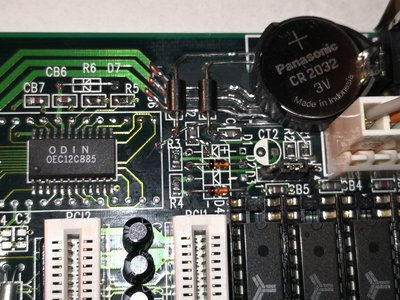

Reply 32 of 40, by quicknick
treeman wrote:
So I guess end of thread, hope somebody makes use of the info in the future
Glad to see a happy end here 😀
But please, if it's possible, update the tread's title to include the motherboard's model so it will be easy for somebody to find it.
Reply 34 of 40, by quicknick
Epilogue:
Re-soldered the external battery header, jumper on pins 2-3,
Soldered the CR2032 holder on the pads of the original barrel battery,
Removed D1 to prevent charging/possible explosion of the new battery.
Everything works flawless now, so I must have made some mistakes when I originally fiddled with this board. Maybe I was tired after scrubbing corrosion and repairing traces, as I tend to do this stuff in one long session, when it hits me 😀
    564.78 KiB
    896 views

Reply 36 of 40, by treeman
Its all wired up from factory but it was probably more cost effective to see a odin + a varta who knows but the option is there and its a much cleaner one I think if you are going to be desoldering things and putting a external battery.
Anyway I got the socket and installed it, bit of a pain to desolder the dallas after I already put it in but socket is the way to go. Also on this board I would say socket is recommended because things get in the way with a direct dallas on the motherboard and have to bend a few things out the way.
The holes and traces are all there so its a matter of taking off the odin and throwing the socket in the place.
From what I saw on other posts of this board it looks common for the corrosion to attack the legs of the odin.
Anyway some pictures.
Reply 37 of 40, by RiP
quicknick wrote:
Epilogue: […]
Epilogue:
Are you sure that it's D1 and not D2?
For me, D2 is connected to the positive pin of battery.
Reply 38 of 40, by bjwil1991
Crikey, what a beauty!
Reply 39 of 40, by quicknick
Yes, quite sure that the charging circuit is comprised by D1 and R3.
Cannot check now, but I guess D2 comes between battery (+) and the RTC, so if you will check the anode of D2 will be towards the battery and the cathode towards the RTC (guessing with another resistor in series).
Anyway, it is safe to connect a CR2032 battery only when the voltage is zero across the empty socket, with the board powered on. If you measure something around 5V, either the charging circuit is still in place or there is too much reverse leakage in the other diode, one that comes between the battery and RTC - had that happen on a Soyo board that still tried to charge the battery with 5 µA after removing the charging diode, solved by replacing the (let's call it "D2" for now) germanium diode with a standard 1N4148.
