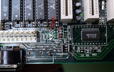

to make it short I got myself a badly battery corroded 486 board with a 100mhz cpu as a new project the dirtier the better. Spent last few days fixing broken tracks soldering a few things that got in the way etc.
It finally powered on but was short lived got. about 6 boots and not posting.
I checked cpu both chipsets and they are warm, the voltage regulator however is hot, hot to the level it is nearly burning but not that hot that have to take finger off.
I measured both sides with a multimeter one side is 1.5V another is .08~.09V.

anyway this is the board before repair, original picture from the seller I should of taken a better myself but I never planned to document it
Original condition
After repair of spilled battery whole picture, set up for 5v operation with 5v cpu to bypass voltage regulator
I think the solder joins for power plug and keyboard are good, I had to remove both. Some of the pins on the power plug were dark, I think it was just dirt not corrosion so I cleaned them with sand paper. I may have to desolder and clean the 11.3V one, unless this variation is ok, I think 11.3V from whats supposed to be 12V is too much drop
Oh yeah I tested the 3 main power rail traces that I tinned and jumped, they measure fine at the end of the last isa slot
The two keyboard traces both measure 5V
I checked all the traces for continuity when I did it first but I should of also checked for voltage

and this is the regulator, current I set it to 5v so its not being used but when set on 3V I put ground on middle pin then put positive on right then on left one side gives me ~1V other side gives me ~1.5V
I think im back to square 0 going to clean and inspect all the small traces in the affected area
It is still not booting with 5V but the cpu does get hot
Reply 12 of 40, by Deunan
TIP127A is a PNP power darlington, not your typical linear regulator like for example LM317.
Anyway, looking at the photo, from left to right the pins of that transistor should be connected like this: Vreg, output (to 486 socket), +5V
That 5V might be connected permanently or through a jumper so check that. If you can't measure 5V there (including when the regulator is bypassed, in case it's not jumpered) but something much lower then I'm afraid that TIP127A is shorted internally and has to be replaced.
Vreg should be set to about 1V lower than what you would get on the output, this is done via the jumpers. Either by connecting a resistor divider direcly to that pin, or there might be an op-amp somewhere nearby but since this is a darlington setup just the resistors would do. If you can, desolder the TIP and then check the voltages again.

I removed the regulator and when cpu is set for 3.3V mode one of the pins is showing 5V and the other 1.5V so looks like the regulator might be faulty. Still no post on 5V mode and no regulator. So still some problem here, I tried a external battery connected to the external battery pins and the negative connected to the origanal battery negative pin like suggested but still no go.
cpu does get hot and I am getting beeps if remove the ram so its not fully dead. Anyway looks like got the regulator problem solved and going to enjoy the further challenge of diagnosing the next issue. thanx guys
