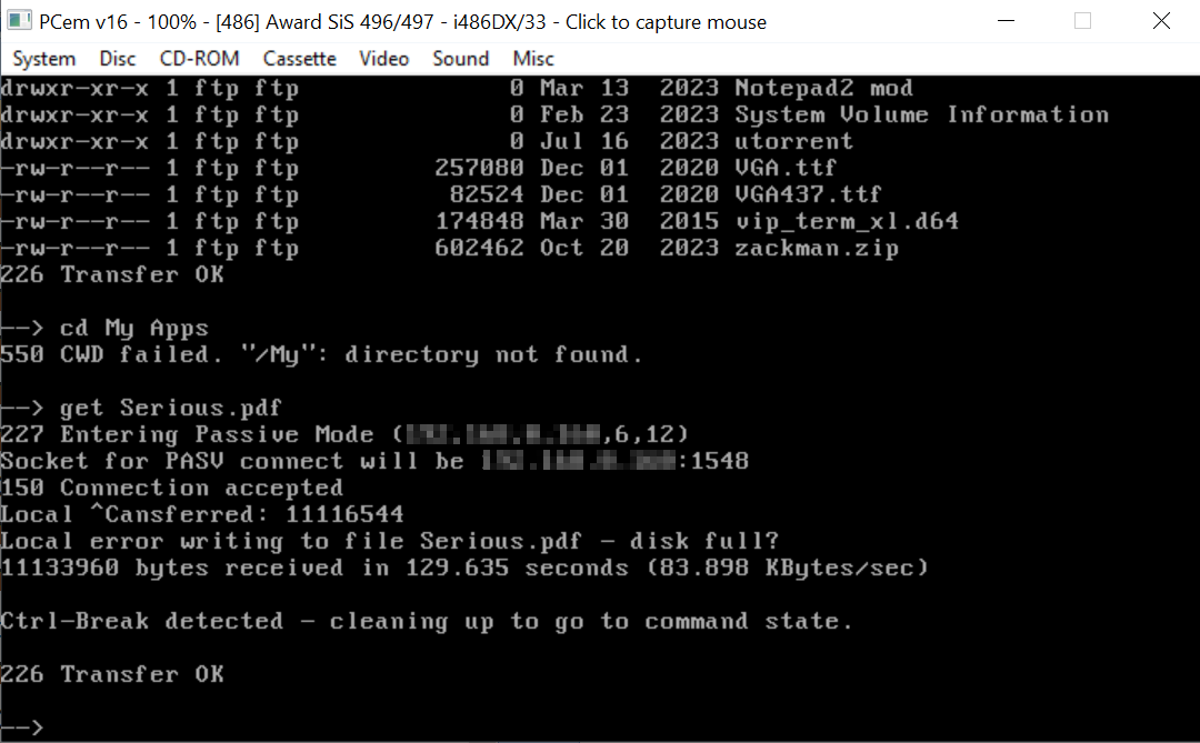

Edit: A FTP server works without issues. If properly configured on the machine, I can pull/put files and directories on the emulated machine from Windows 10 and change basically all files through FTP.
So a basic FTP server should work properly at least.
