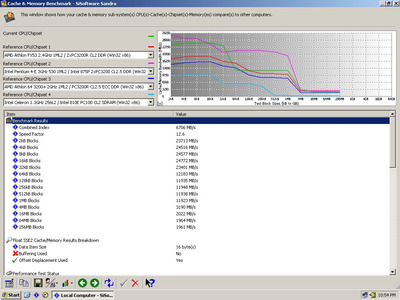

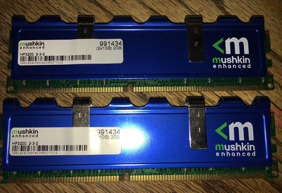

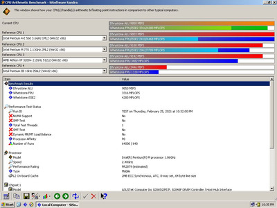

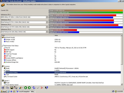

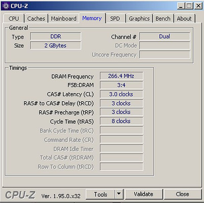

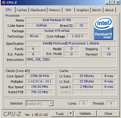

Finally got some motivation and time to resume making the build.
Found some cheap 2gbpair or DDR3200 that would overclock to 533 since thats close to the max the board can go.
Overclocked 1.83 ghz to 2.4ghz stable.
Ran some sandra benches to try and compare it to other CPUs that are in its ballpark like the AthlonXP 3200+ which is what I consider the competitor to the pentium M. Pentium has the edge though with SSE2. Will be interesting how it fairs in game marks vs that cpu.

Reply 26 of 97, by Warlord
I have a 2.2ghz M somewhere. I read they are not as good at over clocking but I might try to see if I can get 2.6ghz out of it, and maybe find some ram with tighter timings that can run 533-550mhz. Very close to beating a P4 3.8ghz with a 1.87 ghz cpu with a small over clock, that id consider stable for everyday. Plus I am already blowing away the 462 Athlon 3200+

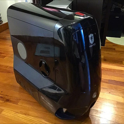

Reply 30 of 97, by Warlord
I bought a case for the build. Once I get it in the mail, Ill post some more updates.
Not my case, but I'm getting one just like it.
My overall goal here is "An Intel version the the ultimate socket A platform"
circa late 2004-2005 period. That can run xp and 98se.
I know a million other people have done it, but not with my own spin.

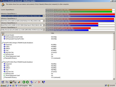

Reply 36 of 97, by Warlord

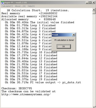

small update.
That ramTurned out to be good over clockers after all and I just had PAT disabled
Also I tightened the timings a bit to 3-3-3-7 T1 @ 533 Mhz , Its completely stable @ 2.65 V
This is about the max the board can go so I'm happy.
My sanda memory bandwidth score went up by another roughly 250 points so ya. Ita about 4800 MBs now. @ 2.4ghz.
So its beating both the reference 915 and 925x with Pentium 4 extreme editions. in memory bandwidth test.
Not to shabby.

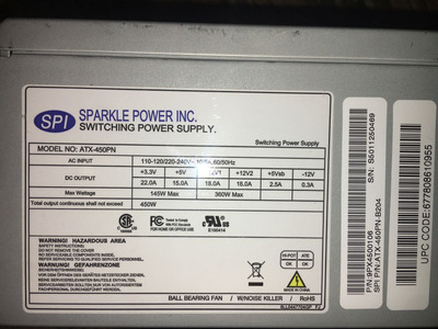

Reply 37 of 97, by Warlord

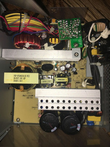

small update
I found this sort of decent OEM power supply. It's not amazing but the price was cheap and its period correct for the build.
spec sheet https://www.farnell.com/datasheets/2686488.pdf
Sparkle ATX-450PN
Opened it up to check it looks fine.
    172.55 KiB
    1132 views
    133.81 KiB
    1137 views
