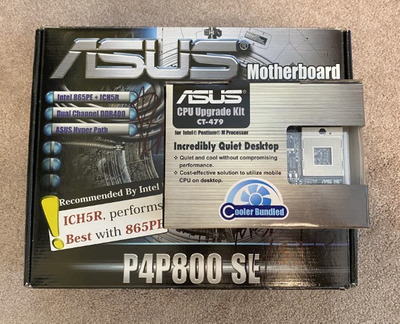

Reply 5 of 88, by pete8475
Are you using the Asus CT-479 adapter to get that pentium m in that board?
I occasionally search ebay for that part but I've never seen one come up, I'd love to buy one.
EDIT - Upon closer inspection I do see CT-479 on the fan sticker.
Were you lucky enough to find one on ebay?
Reply 6 of 88, by Warlord
pete8475 wrote on 2020-07-27, 20:51:
Are you using the Asus CT-479 adapter to get that pentium m in that board? […]
I passed up a few opportunities to get one years ago. They became scarce later and I regretted.
There was this guy who hoarded a few. Unknown reasons. He wasn't trying to make money off them.
He sold one in the middle of the night buy it now. I had been asking about these adapters in another thread when it happen.
I messaged that guy and found out he had more. Then every day I check his listing for like 4 months and I jumped on it the second I see it.
So it's not really luck on my part. Only Luck that this guy existed. And luck that someone else notice him.
I had been searching hardcore for one for a long time though. So I find out bcuz of that.
Anyways I do consider myself lucky to have one. Since I do not want to go through that long agonizing search again.
Reply 7 of 88, by matze79
If you can`t find Adapters look for MSI Speedster FA4

Reply 10 of 88, by pentiumspeed
I had P4P800 with my pentium m adapter running XP. Very nice, and best of all, I still have the adapter and bought P4P800 and P5P800 boards to choose from last year. I had to graciously give away the P4p800 and some P4 processor to a guy's friend who needed PC built (carefully by me!), due to friend not smart to buy parts which ended up gotten broken or junk by his not so nimble hands. I used spare parts that no longer needed back in the late days back then. Nothing vitally critical.

Reply 11 of 88, by God Of Gaming
A CT479 adapter, nice, I also want one and have been looking for one for several years now... why are these so rare?

Reply 12 of 88, by pentiumspeed
Oddly the cost of Asus CT-479 kit is not that expensive back in the day but funny thing people wasn't thinking of using much better pentium-M but I think the fsb could be the reason that holds this back on overall performance?

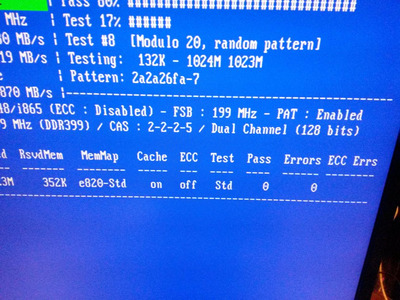

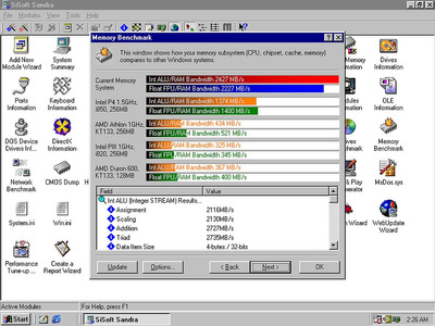

Reply 14 of 88, by Warlord
Small update. Still in testing phase of the build.
Decided to go with 1024 MB of ram. At least until I can find a set of 2gb (2X1gb) with good timings.
The best ram I have is this winbond BH5. It's running stable at 2-2-2-5. (2x512mb)
Sandra 2001 Ram benchmark 98se.
