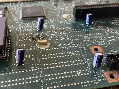

Looks to me like what you get sometimes if you use low concentration Isopropyl, dunno if it's a denaturant or they just diluted it with local water supply which had minerals in it.
Reply 21 of 36, by rasz_pl
might be mineral water additives, wash with some detergent and a toothbrush.

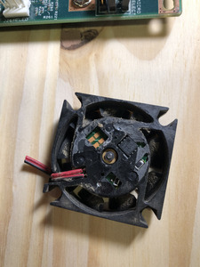

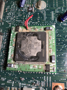

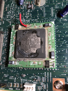

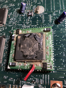

So after much stressing I managed to remove the fan from my Am5x86 using a chisel blade on an x-acto knife. After carefully working the blade under the fan the majority of it broke free. Unfortunately a portion remained stuck to the cpu. I spent about an hour painstakingly scraping the plastic off but I removed enough that I should be able to glue on a new heatsink with thermal paste in the center. Thankfully after all that I was able to power up the system, boot into windows 95 and play SimCity 2000 for about 10 minutes. The cpu never went above 101f with a fan blowing on it, so I'm reasonably confident the heatsink fan combo I have coming in will be more than enough to keep it cool.
Fan removed
The attachment 1fan_removed.jpg is no longer available
Failing fan
The attachment 2bad_fan.jpg is no longer available
Most of the plastic scraped off
The attachment 3most_plastic_removed.jpg is no longer available
Most the old glue cleaned off
The attachment 4removed_most_glue.jpg is no longer available

Ah, so you do have a dx4-133 already. Didn't catch that before. Bit of an overkill for the system per se, but if it's there?
For sure, that looks like shit.
I had some glue residues on a dx2-66 that slowly yielded to an prolonged acetone treatment, but that was CPGA, with you plastic chip, you'd have the make sure the chip itself won't dissolve.
If optics don't matter, mechanical force might suffice. Sand paper. Or an angle grinder. 😜
9731 on the chip means that it was manufactured in the 31st week of 1997, I think. Rather late 486.
In a somewhat ventilated case, it will probably be fine with a modern passive heatsink. Maybe one meant for a modern motherboard northbridge - plenty of those to chose from.
Consider, theses things were sold with an active one so they won't cause an RMA case in the most sealed off, 286-era death trap.

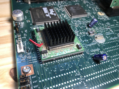

Reply 32 of 36, by failuresuccess
That makes sense and I didn't even think about using a northbridge heatsink. That said though I went ahead and ordered a set along with some fans.
Reply 33 of 36, by failuresuccess

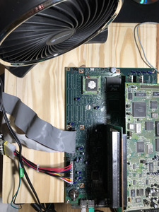

I got a heat sink attached and so far so good. Even without a fan the cpu sits at 121f. Sim city 2000 proved to be pretty good keeping the cpu at 100%. I plan to attach a cpu fan later tonight to see what kind of temperature I get.
The attachment 683BFDFD-CD3B-4DAF-A54D-4B52D6AF05A3.jpeg is no longer available
Reply 34 of 36, by failuresuccess
Fan installed

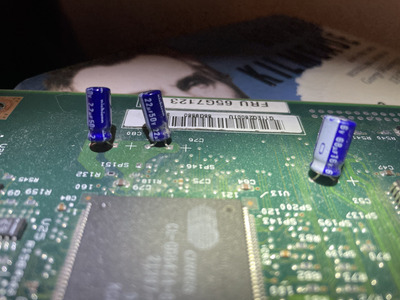

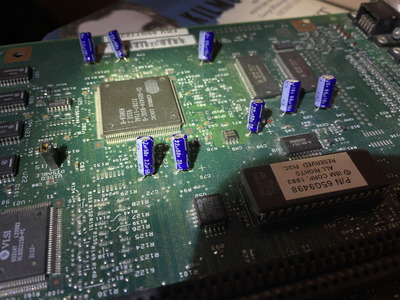

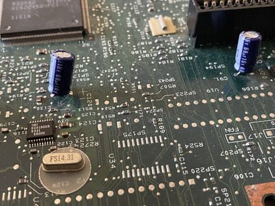

Evening all,

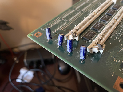

So my PS/1 finally stopped booting all together, it never seems to get to a point to where it can post. I removed all the expansion cards, the hard drive, and floppy. I've also tried booting with the integrated cpu, two different amd 5x86 cpus, and different sticks of ram. No post beeps or anything like that either. The psu checks out, I don't see any cracked traces and no magic smoke was released. At this point I'm guessing the 30 year old electrolytic capacitors have given up the ghost.
Has anyone ever recapped their IBM before and had any success? I believe there are 3 different electrolytic capacitor types on the motherboard.
68uf 16v - 13 Count
22uf 50v - 9 Count
2.2uf 50v - 2 Count
I'm willing to give it a try if I'm not barking up the wrong tree. I'm ok at soldering and it looks like the capacitors can be had relatively cheaply on mouser for about $16.
Any thoughts would be appreciated!
