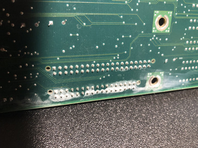

I got the bug to start working on my 90s and early 2000s hardware again. I dug out my IBM PS/1 Multimedia or more specifically what's left of it (motherboard/riser card). This was my first PC going back to my childhood so I've got a fair amount of sentimental value for it so I'm hoping to breathe some life back into it. I'd like to be able to setup a couple of CF cards, one running dos 6.22/windows 3.11, one running Windows 95, and another with a heavily customized Gentoo compiled for i486. I also want to max out its specs, something I could never do back in the 90s.
First I'd like to figure out exactly which motherboard I have but my googlefoo is weak. At the moment the best I've been able to find is at uncreative labs and the page appears to cover several submodels.
http://www.uncreativelabs.de/th99/m/I-L/34755.htm
My PS/1 Motherboard
The attachment ps1_motherboard_small.jpeg is no longer available
These are the following items I'm currently working through to restore my PS/1. I'll update this as I find out on my own or from feedback in this thread.
**UPDATED**
1.) Does the motherboard support AT power supplies or is it IBM proprietary?
The motherboard does support the use of an AT power supply. It originally used an LPX psu which was a compact version of an AT power supply.

1.) I dont see an AT power connector on the board, it does have what looks like a IBM only PSU connector, im guessing you will need a PS/1 PSU with the right IBM connector on it or a way to adapt a AT PSU for the IBM connector.
You might also want to consider washing that board, its looking a bit grubby and a quick wash will make it easier to spot damage components and traces, washing it under water wont hurt it just be gentle and use a paint brush to gently clean the dirt off it, then let it dry in a warm dry place for a few days. If you really want you can buy some Isopropyl Alcohol and give it a quick rinse with that to help remove the water.
I'll give that a try, I know you can use rubbing alcohol but I didn't realize water wouldn't cause problems. I actually gave the board a quick rub down with alcohol before snapping the picture. The entire thing had some really nasty thick dust on it that wouldn't come off easily.

That is a 2133 or 2155 motherboard.
1) Regular AT power
2) Look for LPX cases. It's a "loose" standard so not all are the same though.
3) You need 72-pin Parity FPM RAM with IBM presence detect. For example Kingston KTM0130 (8 MB), KTM0160 (16 MB), or KTM0320 (32 MB)
Something else to note is the hard drive size limit is 504MB. You will need a BIOS extension ROM or drive overlay for larger drives.

Well that doesn’t look good. I washed both sides last week and maybe I just missed it but does that look like corrosion near the floppy connector pins? I’m wondering if my growing floppy drive issue is because the solder joints are bad.

Reply 19 of 36, by Plasma
It looks like dust to me. Corrosion is usually green. But I would clean it anyway.
