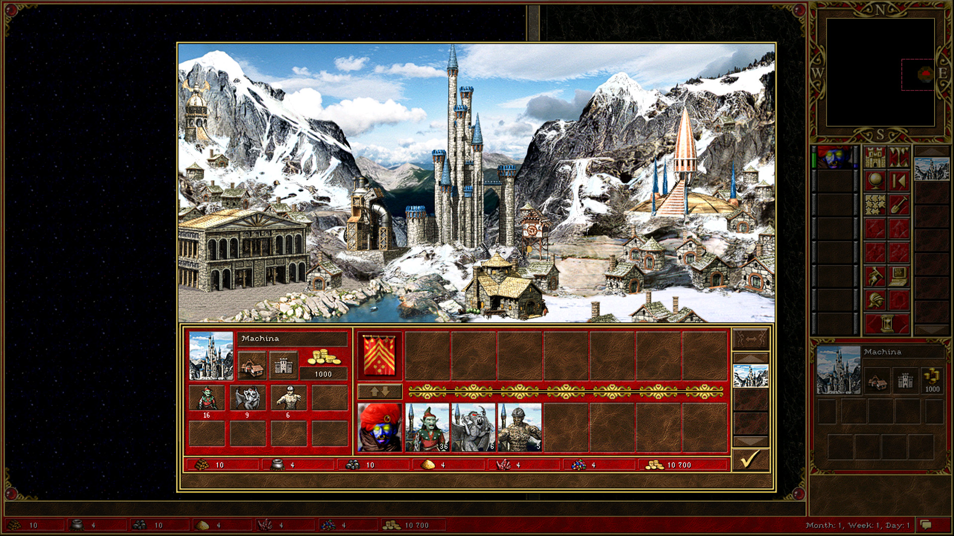

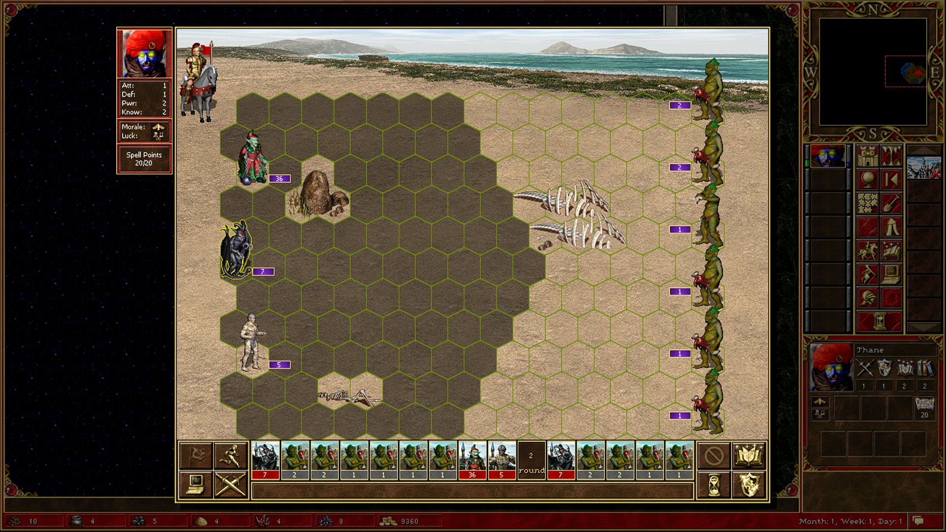

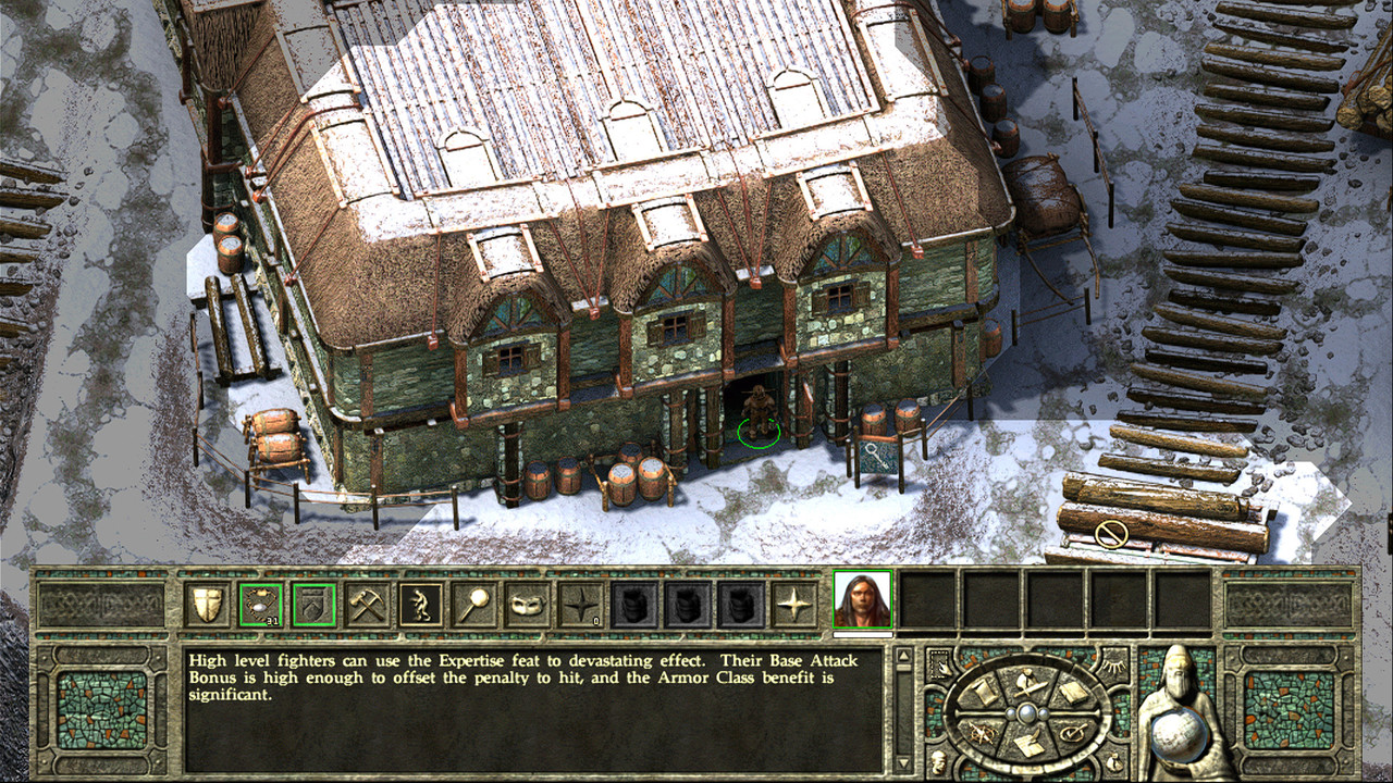

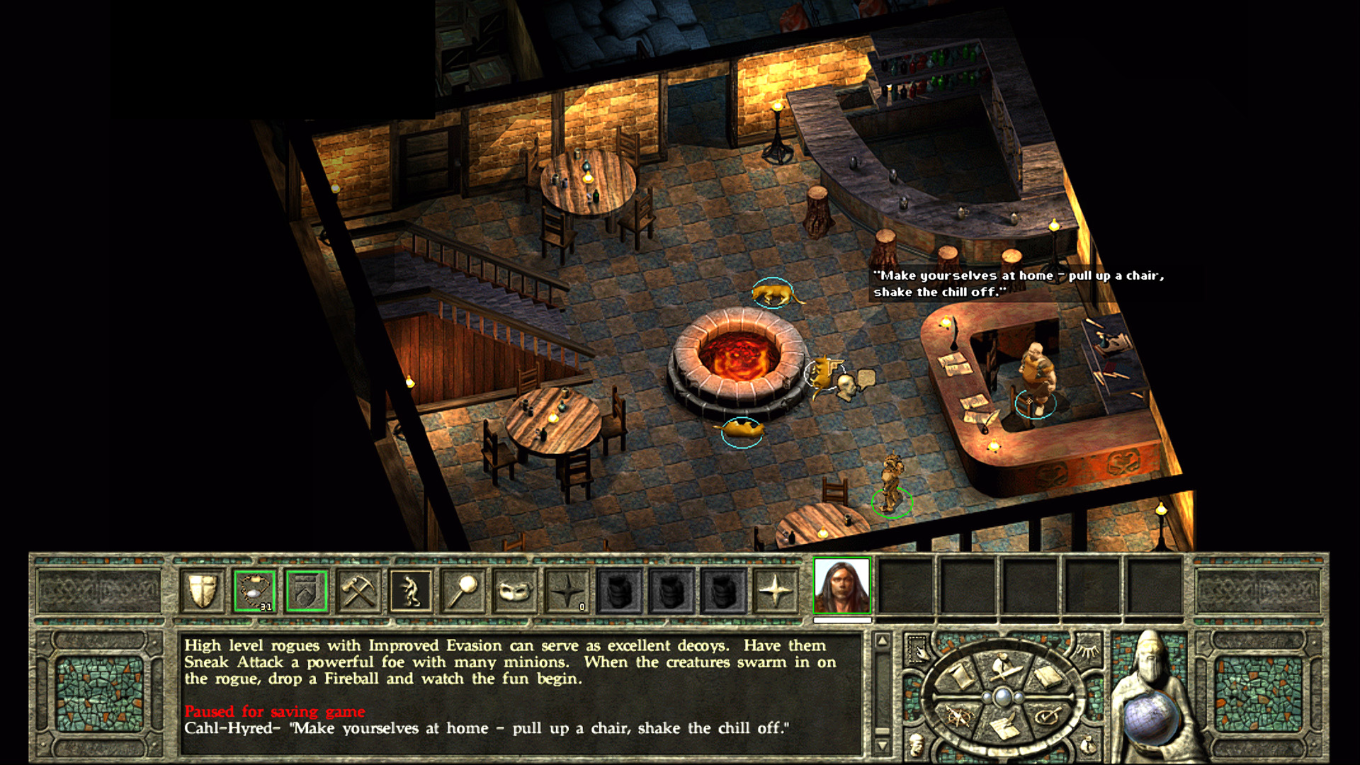

Reply 25 of 26, by eierfrucht
https://i.postimg.cc/GdyWwGbW/screenshot-7.jpg
https://i.postimg.cc/QxGnxYjR/screenshot-6.jpg
https://i.postimg.cc/dFWP8JWx/screenshot-5.jpg
https://i.postimg.cc/GLgWrj8C/screenshot-4.jpg
Some older 3D games like Sacred or Etherlords II have fan patches available that unlock custom, more modern resolutions like 1920x1080 yet effectively need to run at the closest widescreen resolution to the original one, e.g. 1366x768 instead of 1024x768, etc.
Otherwise the 2D UI becomes too small to be readable, there's no workaround, the engine does not scale the UI flats but rather renders them pixel for pixel. So far, I've been using dgVoodoo supersampling (4X resolution, Stretch, Keep Aspect Ratio) + Lanczos resampling. I really like the result. But replacing Lanczos with FSR would yield an even better image.
