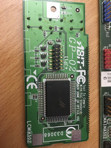

Here are the test pictures as promised. I couldn't find my multimeter at the moment, but i'll get back to you on that one.
As you can see, it's much more visible from an upper angle than straight from the front.

Reply 22 of 54, by rasz_pl
see that plated hole on the top? theres even a fuse between it and ground
get that multimeter out and measure
-supply voltage, ground (pin 6) to pin 8
-bias, ground to pin 9
https://github.com/raszpl/FIC-486-GAC-2-Cache-Module for AT&T Globalyst

Reply 23 of 54, by DJonekill
rasz_pl wrote on 2022-12-11, 16:50:
see that plated hole on the top? theres even a fuse between it and ground […]
That ground fuse was a great observation!
Finally found the multimeter! Now, i feel really dumb to ask this, but are you talking about the pins on the LCD connector array, the LCD PCB wire connector (JP11), or the legs on the holtek chip as we discussed before (the ones just above "R21")?
Also, before breaking the fuse, what setting should i use on the multimeter for bias? I have 200, 2000, 20k, 200k, 2000k. Thanks!
Edit: also, when checking bias, should the unit be on or off?
Reply 24 of 54, by DJonekill
Just did a quick measure of the fuse (FB21) connections on the lowest setting (200) for whatever it's worth, and it's at 0.03, which is the same bias as when just putting the measuring sticks together. So i guess there's nothing wrong with the fuse?

Reply 26 of 54, by rasz_pl
DJonekill wrote on 2022-12-12, 07:26:
holtek chip pins
what do you mean breaking the fuse? dont break the fuse! 😀
to measure voltages there must be .. voltages 😀 so yes, unit on. But just from your post maybe get some IRL help? I can already see one of the probes slipping and you frying something 🙁
DJonekill wrote on 2022-12-12, 09:08:
I mean that pad needs to be screwed into something, it needs solid connection to ground

Reply 32 of 54, by rasz_pl
DJonekill wrote on 2022-12-13, 09:44:
Pin 9 to ground voltage: 3,53v.
Pin 9 to ground bias: 1
what exactly do you mean by bias? When I wrote
"-supply voltage, ground (pin 6) to pin 8
-bias, ground to pin 9"
I meant "pin purpose", "what to measure" 😀
Edit: Pin 8 to ground: ca 3,7v
this is impossible, cant have higher voltage than supply while deriving that signal from supply.
I was counting the chip's legs from left to right, if you look at the PCB in the direction of the "ABIT GP-02" text not being rotated.
The attachment Clipboard02.jpg is no longer available
Unfortunately, there was no way for me to do this without using ground from the pc motherboard usb pins, because i don't have 3 hands, so there's probably something wrong with the results.
explain?
I want you to measure Voltage between 6 - 8 and 6 - 9 while the thing is powered and displaying something

Reply 33 of 54, by DJonekill
rasz_pl wrote on 2022-12-13, 21:02:
explain?
Yes, i was putting the plus side on the multimeter on the chip, while taping together the gound/negative side of the multimeter to a ground pin on the motherboard. But since you tell me the results are wrong, i will try to do it again just using the chip pins. I just probably need an extra hand to hold the thing down. Or maybe use some tape.
Edit:
Pin 6 - 8: 3,72v
Pin 6 - 9: 3,53v
Those readings are directly from the holtek chip pins, no cheating.

Reply 35 of 54, by weedeewee
DJonekill wrote on 2022-12-14, 10:49:
Yes, i was putting the plus side on the multimeter on the chip, while taping together the gound/negative side of the multimeter […]
explain?
Edit:
Pin 6 - 8: 3,72v
Pin 6 - 9: 3,53v
I'm kinda wondering if one of the other fuses (fb16, fb10, fb18,... , fb13, fb1 ) on the main pcb, (not the lcd pcb) might be faulty.
Could you measure the voltage on the usb-A connector and verify if that is still 5v or close to it ?
and then figure out which pin on jp7 should be the power supply to the lcd, which I'm assuming should also be 5v.

Reply 36 of 54, by snufkin
ok, I was wrong about the EL thing, was jumping to conclusions based on other photos.
Might be a nothing to do with the problem, but I'm slightly curious about what's connected to what though, looks odd to have the GuruLink cable off to the side of the connector, and having a separate cable going to one pin, and needing just the Ground on the USB header. Do you have a manual for how it's supposed to connect up and could you take a picture of all the cable ends?
(also, think the FB devices are ferrite beads rather than fuses, but they can also go open circuit, so worth checking).
Reply 37 of 54, by weedeewee
snufkin wrote on 2022-12-14, 17:36:
I don't think it has a manual of its own, but the way it should be connected can be found in the manuals of the mainboard with which it was delivered... I already looked it up and forgot 😀 the guru link is some data from the mainboard and a connection (3pins?maybe 2) to the cmos reset jumper on the mainboard.
also, yes, Ferrite beads.

Reply 39 of 54, by rasz_pl
Edit: Pin 6 - 8: 3,72v Pin 6 - 9: 3,53v Those readings are directly from the holtek chip pins, no cheating. […]
Edit:
Pin 6 - 8: 3,72v
Pin 6 - 9: 3,53v
That looks correct and weird at the same time. I could totally see this module being powered from 3.3V rail, but 3.7V? thats one weird voltage. Either it should be 5V and your wiring is bad, or 3.3V and your board runs that rail hot (for example to help with overclocking). Still even at 3.7V it should work. Can you solder? One safe thing you can do is
- verify that resistor R21 is connected between pins 8 and 9
- solder a wire on top of it effectively shorting pins 8 and 9
This will set maximum output voltage for LCD, should make contrast better. Another option is rewiring it for 5V supply.
