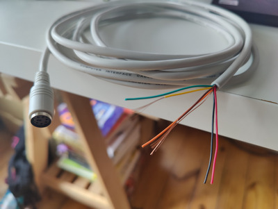

Reply 26 of 31, by stu_e_hughes
Can I presume here that the red will be + power and the black ground?
Then it will just be a case of finding the 2 data wires from the remaining 4?

Reply 28 of 31, by maxtherabbit
stu_e_hughes wrote on 2023-06-15, 09:38:
No, cable manufacturers just use random colors
Reply 29 of 31, by stu_e_hughes
Thank you so much. This was incredibly useful. I've managed to match up which colour wire now is which.

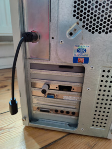

Thanks to everyone in this post. With all your help i've managed to add a PS/2 port which works!!! It was a long road but I got there. I was playing some Dune to celebrate.
I've added some new skills along the way. I used continuity on the multimeter to get the pinout on the PS/2 extension cable. Then, found the +5 voltage on the motherboard header to get the power and ground and to find the clock and data was just luck. Then bought and used a dupont kit to make a proper 4 pin header connector from the extension cable which connects and works (with CuteMouse driver) on the PS/2 header on my motherboard.
For the moment i've taken the bracket off an old network card as it has a round hole where I can poke the PS/2 connector through and it doesn't go back into the case. I might fix it permanently with glue if I can't think of anything else.
Would it be safe to secure the wires on the other end (my homemade dupont header) with glue?
