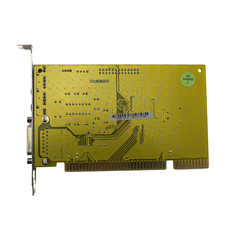

Reply 20 of 37, by DerBaum
Omarkoman wrote on 2023-08-30, 21:54:
I bought this sound card for my pure DOS build
Can you post a picture of the back of the card?
I would like to see if i can make out where the ground pins on the Wavetable connector go to...
FCKGW-RHQQ2
Reply 21 of 37, by Omarkoman
hope this helps?
Reply 22 of 37, by DerBaum
Omarkoman wrote on 2023-09-03, 00:05:
hope this helps?
Yes.
https://www.epanorama.net/documents/pc/waveblaster.html
Your lower row has all the grounds... so its 1 / 25 .
The attachment wavetable.png is no longer available
If you want to use this : https://www.serdashop.com/waveblaster
it has to point up ... (ground is on the outer edge of the dreamblaster s2)
FCKGW-RHQQ2
Reply 23 of 37, by Omarkoman
Oh wow! Ok so has to point up, fingers crossed I havent damaged it already connecting it pointing down!
I’ll hook it up and post result!!! Thank you!!!

Reply 28 of 37, by Omarkoman
thanks for that, just goes to show how difference PCB layouts can be !

Reply 31 of 37, by Omarkoman
Update - tried the S2 on two new ESS cards I received today. No sound for general midi. I fear the wavetable board is damaged.
Is there any chance this can be repaired at all? Or pretty much it goes to bin?

Reply 33 of 37, by Omarkoman
I have it connected the right way, I am 100% sure. I checked the pin layout and definitely have it on correctly. Even matches Phils YT video as its exactly same Sound Card model and S2.
I got an email from Serge at Serdashop and he suggested its likely that its damaged and cant be repaired. I got offered a discount for new one so will be placing an order for replacement.
