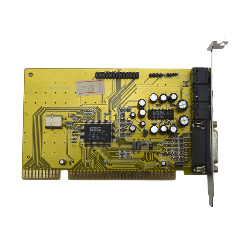

I bought this sound card for my pure DOS build
I tried the phils drivers from here - https://www.philscomputerlab.com/ess-audiodrive-es1868.html
for DOS and watched his YT video however, when I run the install, the software just freezes.
Then I found another set of drivers from a thread here : http://www.vogonsdrivers.com/getfile.php?file … menustate=48,38
which worked and running the go.bat file sets the settings and I can edit them as needed.
Im using these settings :
REM ESSCFG V4.8: Verbose IRQ DMA1 DMA2 Address MPU Joystick
ESSCFG.EXE /V:1 /I:7 /D:1 /E:3 /A:220 /B:330 /J:E
REM ESSVOL 0..15: v=master l=line w=wave m=mic c=CD s=synth a=auxB =pcspkr
ESSVOL.EXE /v:8 /l:0 /w:8 /m:0 /c:0 /s:8 /a:8 /p:0
and all works ok (although if E is high DMA, it doesnt work when I set it to say 5, it gives me error).
in the vol settings, a is supposed to be the auxB port which according to Phils YT video is the wavetable header. However, I just static when its on, when I make it zero there is no static noise.
I have dreamblaster S2 plugged in and when selecting General Midi at 330, I get no music playing at all.
Any suggestions what I can try please? I am out of ideas.
Reply 1 of 37, by mockingbird
Take a multimeter and check continuity between pin 20 and 24 to empty SMD pads where a resistor might be soldered in. If you find continuity, try bridging that empty connection, it could be a path for the audio.

Reply 4 of 37, by mockingbird
Omarkoman wrote on 2023-08-31, 01:47:
would this mean though that the card doesnt work with all wavetable cards ? SB16 I have works with it perfectly.
The system clearly sees something on port 330 as when I select different port in say setup.exe for duke it tells me no mpu401 found.
Yes, if the physical audio channels are severed because there's nothing bridging the pads in their path, you won't get audio, even if it might be detected. It would be unusual in your case because the card came populated with a wavetable header, but it's something that needs to be ruled out. Next I would check for an electrolytic capacitor as the issue.

Reply 6 of 37, by mockingbird
Omarkoman wrote on 2023-08-31, 04:45:
hm ok that looks complex. is it possible the S2 card needs to be installed the other way around? is there possibility of damaging it ? Sounds too simple solution and wouldnt make sense for it to stick up vs down but ... thought I'll ask.
That is risky and inadvisable. The way to check the proper orientation is to do a continuity test on the soundcard between the two rows of wavetable header pins and a ground point (the card bracket, for example -- one row of the wavetable header is all ground pins). To be certain, you do the same thing with the actual wavetable board and then you connect it ground row to ground row and signals row to signals row.

Reply 8 of 37, by badmojo
Omarkoman wrote on 2023-08-31, 06:26:
has anyone with this chip card actually managed to get a wavetable header working ? is there some common problem ? or is it just this card?
There's no problems with that chipset and wavetable headers, it's generally well regarded. That card looks to be a super cheap implementation of it though, so I suspect that either you have some sort of resource conflict, or the card is faulty.

Reply 11 of 37, by Joseph_Joestar
Note that ESS only made the main chip, the actual cards were manufactured by a bunch of different companies. Not all of them are of the same quality. Some are heavily integrated and have cut down certain features as a cost saving measure.
If you're looking for a high quality ESS card, Terratec produced some of the best ones back in the day.
