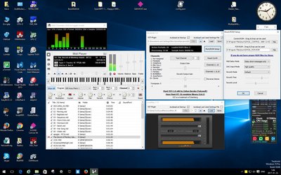

Turning to the point Munt VSTi 1.0 is ready to release. There is a test version for you to try:
http://falcosoft.hu/munt_vsti_test.zip
Notice:
Since Munt only supports 32000, 48000, and 96000 Hz, you have to set one of these in the host (FSMP). These frequencies correspond the COARSE, ACCURATE, OVERSAMPLED analog output modes in Munt. Since Munt also uses 32Khz internally for timestamps for the most accurate timing 32Khz is recommended. But 96KHz is still preferred to 48Khz.
@James-F and Phil:
I would be grateful If you could test it.
PS: Contrary to normal Munt releases this one also works on Win9x 😀
The attachment Munt_VSTi.jpg is no longer available
