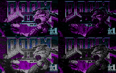

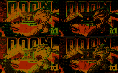

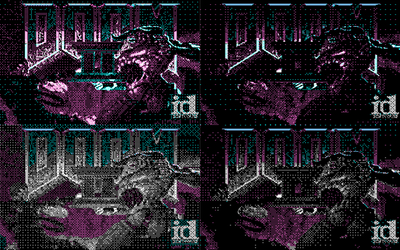

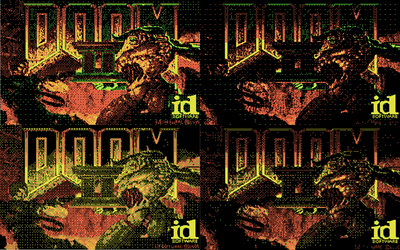

Reply 257 of 993, by b_w
Some suggestions to FreeDoom:
1) Use 8x8 Bayer dithering for monochrome (CGA, Hercules) output:
I use these tables -
unsigned char bayer64_1_1[] = {
0,32, 8,40, 2,34,10,42,
48,16,56,24,50,18,58,26,
12,44, 4,36,14,46, 6,38, // This table favors devices like
60,28,52,20,62,30,54,22, // the Hercules card where the
3,35,11,43, 1,33, 9,41, // aspect ratio is close to 1:1
51,19,59,27,49,17,57,25,
15,47, 7,39,13,45, 5,37,
63,31,55,23,61,29,53,21};
unsigned char bayer64_2_1[] = {
0,32,16,48, 2,34,18,50,
24,56, 8,40,26,58,10,42, // This table favors devices like
4,36,20,52, 6,38,22,54, // the CGA card where the aspect
28,60,12,44,30,62,14,46, // ratio is close to 2:1
3,35,19,51, 1,33,17,49,
27,59,11,43,25,57, 9,41,
7,39,23,55, 5,37,21,53,
31,63,15,47,29,61,13,45};
2) For CGA binary use BrightRed-BrightGreen-BrightYellow-Black palette. It produces more accurate color "mixings". While DarkRed is nearly equals DarkYellow. Or BrightCyan-BrightMagenta-White-Black palette? See attach for comparison.
3) Made a binary for monochome:
VGA 640x480 mode 0x11/0x12.
EGA 640x350 mode 0x0F/0x10.
Here is DOOM on CGA samples:
    58.45 KiB
    1955 views
    175.32 KiB
    1955 views
    299.68 KiB
    1955 views
    310.04 KiB
    1955 views

b_w wrote on 2021-07-04, 16:02:
1) I first implemented a 4x4 matrix, but it was very slow on 486/586 processors, so I had to downgrade it to 2x2 and optimize it by precalculating LUT tables with all the possible combinations to avoid all the branches. The 8x8 will look better for sure but will hamper the framerate.
2) Those images look very very good, can you share the source code of your implementation? I've been looking for an implementation that generates good results, but most of them require very fast CPUs.
3) I rejected the idea of the VGA 640x480 (16) just because 320x200 (256) looks much better and is much faster, and VGA cards supports both modes anyway. And the EGA 640x350 was also rejected because most EGA cards are painfully slow, even in Mode D most of them can't produce more than 10 fps. Now I get why Doom runs so bad in Amiga computers 😅
