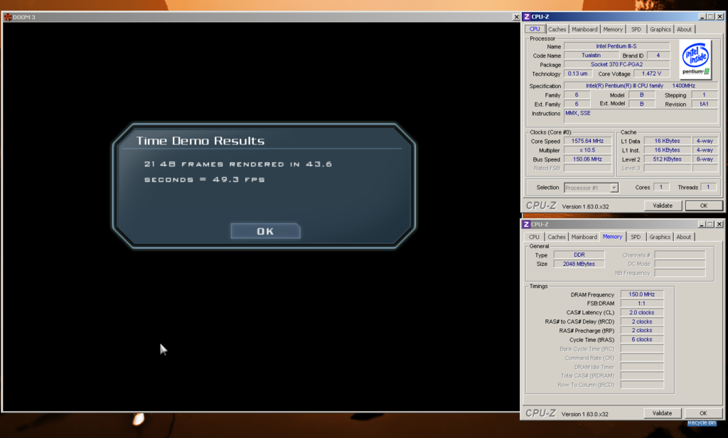

My latest toy arrived in the mail today - a QDI Advance 12T motherboard. It's based on the Apollo Pro 266T chipset with native Tualatin and DDR support. I've always really liked the Pro 266T chipset; it's easily the fastest P3 chipset out there (that I've tested), has a dedicated 266 MB/s link between north and south bridge, and easily the best AGP support of all VIA PIII chipsets. This board has no problem running cards in 4x AGP mode!
PIII-S just screams with 2GB of 300MHz, 2-2-2 DDR memory! This is a full 8 fps faster than my previous attempt with an 694T-based board, and far ahead of my 2.2GHz Northwood P4.
PIII-S @ 1575MHz (150MHz FSB), 2GB DDR-300 2-2-2, GeForce 6800GT AGP (81.98), Apollo Pro 266T, X-Fi ExtremeMusic, XP Pro SP3

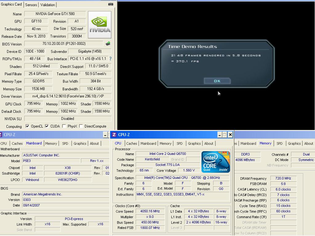

The Q6700 I found in the dumpster along with the warped X38 board did pretty well (using another X38 board). The Kentsfield cant touch the Wolfsdale obviously but its not slow.

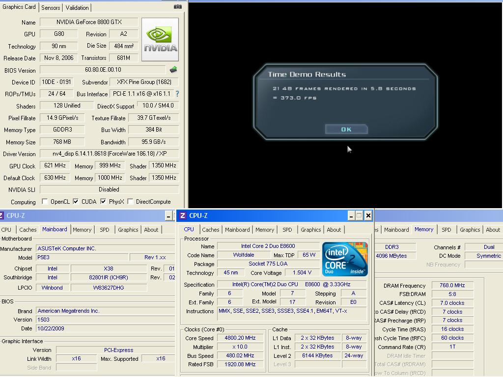

I took my E8600 out for spin in the Asus X38 DDR3 board cooled by a Thermalright Ultra-120 😀
The E8600 managed to beat the E8400 running in the Gigabyte P35 DDR3 system but not by much. The the GTX 580 overclock gained 4 FPS so even with stock GPU clocks the E8600 X38 system would have ended up ahead. The E8600 is clocked 100 mhz higher than the E8400 though, clock for clock both systems seems totally even.
1024*768 Ultra
First the Geforce 8800 GTX.
The Geforce GTX 285, this card and the GTX 580 performs pretty much the same in Doom 3 with this CPU.

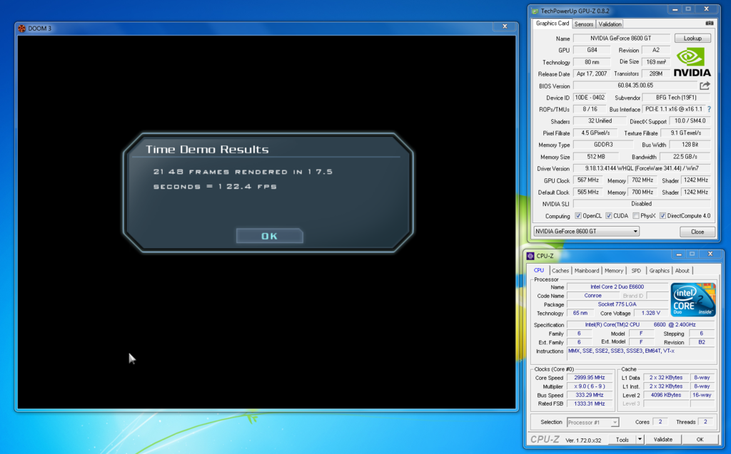

My latest dumpster find: a complete LGA775 system. It even came with a hard drive and fresh install of Windows 7. And even better, the previous owner overclocked it! The Core 2 Duo e6600 was running at a nice 3GHz on a 1333MHz FSB.
Complete specs as found:
Asus P5N-E SLI motherboard (nForce 650i SLI chipset)
Core 2 Duo e6600, overclocked to 3GHz/1333FSB by previous owner. Stock voltage and Intel HSF.
4GB DDR2-667 CL4 memory, dual-channel.
BFG GeForce 8600GT 512MB GDDR3, slightly overclocked.
Ultra case, Corsair CX500 PSU
Windows 7 x86 SP1
640x480 Medium: 188.7 fps
1024x768 Ultra: 122.4 fps
Obviously hitting a GPU bottleneck there. I must say, I'm thrilled to have a 775 board to play with again. I have a few CPUs sitting around (Pentium D up to Core 2 Quad) that I'll eventually get around to testing with this thing. 😀
"A little sign-in here, a touch of WiFi there..."

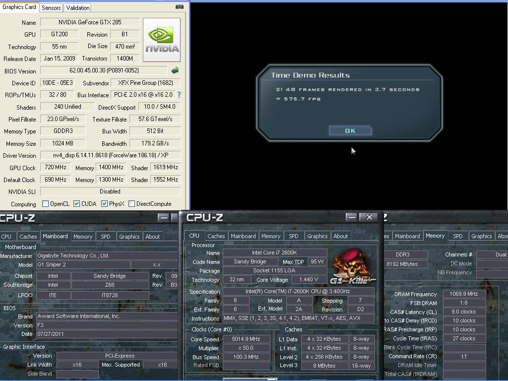

Reply 272 of 662, by Skyscraper

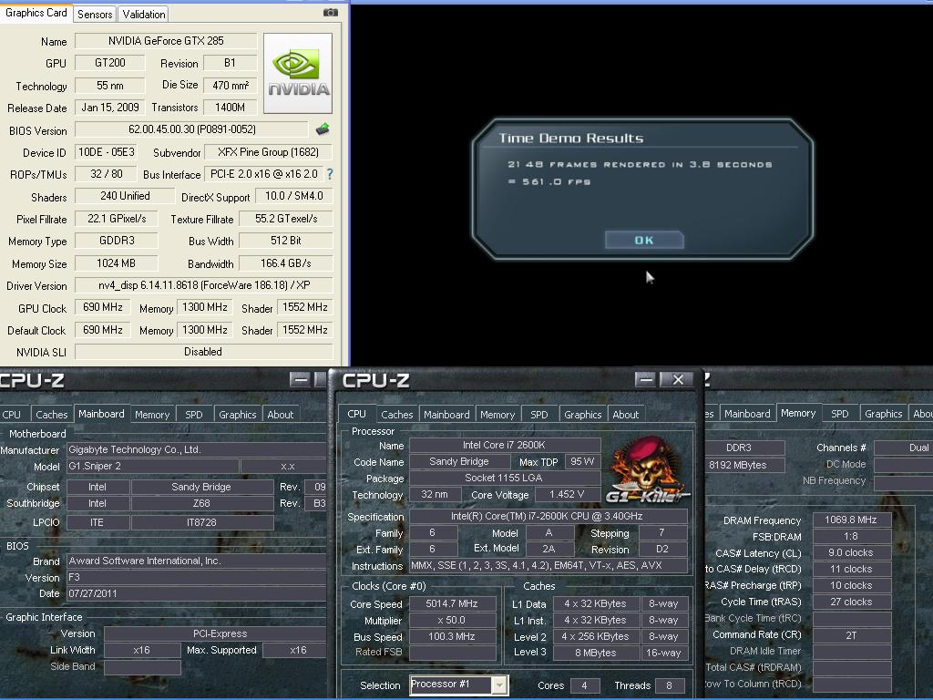

Close but no cigar, I have a feeling this is a little bit GPU bottlenecked though.
Spec. i7 2600K@5 GHz, Gigabyte G1 Sniper 2 Z68, 8GB DDR3 2133 CL9-11-10-27, XFX Geforce GTX 285 Black Ed., onboard audio, XP-SP3.
1024*768 Ultra: 561 FPS
I got a slightly better score with 1T memory and a slight OC on the GTX 285.
Spec. i7 2600K@5 GHz, Gigabyte G1 Sniper 2 Z68, 8GB DDR3 2133 CL9-10-10-27, XFX Geforce GTX 285 Black Ed., onboard audio, XP-SP3.
1024*768 Ultra: 575.7 FPS

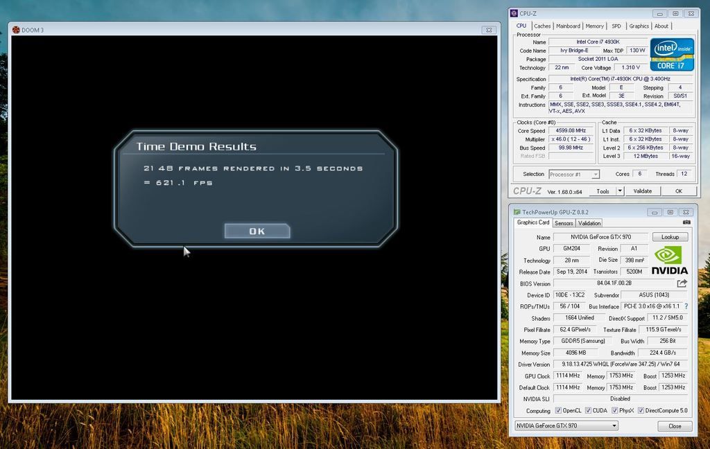

All right, once last try. This time, I even unhooked my second monitor so that the system wouldn't have to draw a second desktop. Whether or not that actually gave me a few extra frames, I have no idea. 😁
i7-4930k @ 4.6GHz, Asus GTX 970 (347.25), 32GB DDR3-2400 CL10, Asus Rampage IV Gene (x79), onboard audio, Win7 x64

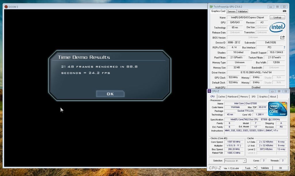

Here's that little Optiplex 780 again, this time running Windows 7.
640x480 medium: 28.6 fps
1024x768 Ultra: 24.2 fps
1280x1024 Ultra: 16.5 fps
Core 2 Duo e7500 (2.93GHz, 1066FSB, 3MB L2), Intel GMA X4500HD, 4GB DDR3-1066 CL7, onboard audio, Win7 x64 SP1
Here were the XP results:
640x480 Medium: 35.3 fps
1024x768 Ultra: 26.0 fps
1280x1024 Ultra: 17.2 fps
Strange how 640x480 takes a bigger hit than 1024x768, despite both resolutions being completely GPU limited.

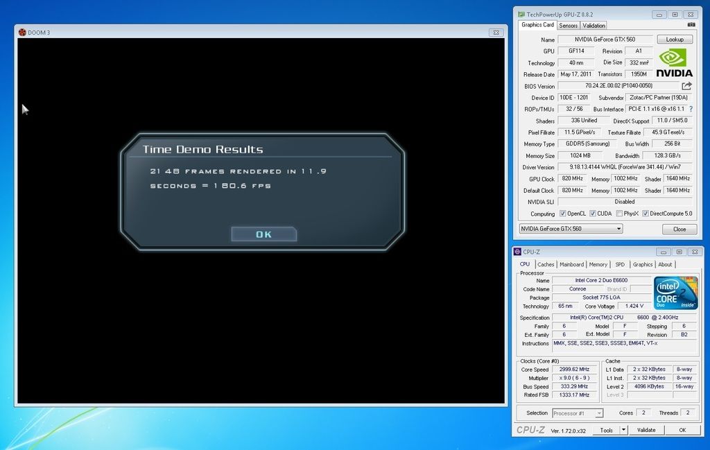

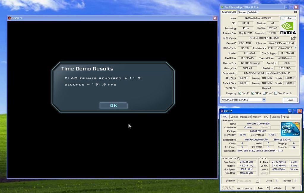

I finally got around to installing one of my GTX 560s in the P5N-E SLI based dumpster find. I'll eventually get around to testing some of my other CPUs in this machine, but for now here's the C2D E6600 that it came with. Stock-clocked and overclocked, Windows XP and Windows 7. All tests run at 1024x768, Ultra.
Windows 7:
C2D E6600 @ 2.4GHz/1066FSB, GeForce GTX 560 (341.44), 8GB DDR2-800 5-5-5, Asus P5N-E SLI (nForce 650i), X-Fi Ti, Win7 x86
C2D E6600 @ 3.0GHz/1333FSB, GeForce GTX 560 (341.44), 8GB DDR2-800 5-5-5, Asus P5N-E SLI (nForce 650i), X-Fi Ti, Win7 x86
For the sake of comparison, here were the Opteron 185/Win7/GTX 560 results:
At 3.0GHz: 156.7 fps
At 3.13GHz: 172.1 fps.
So while IPC is clearly higher on the Core 2 system, at 3GHz it's actually not quite as fast as I had expected/hoped it would be. It beats the 3.13GHz Opteron, but it doesn't really leave it in the dust. What's strange is that the Opteron gained 16 fps from 133MHz, while the C2D only gained 8fps from a 600MHz overclock (it's repeatable, too). I believe part of the problem is the memory. The Opteron is stuck with DDR1, but the memory timings are very tight, and DRAM frequency increases along with the overclock. The Core 2 Duo on the other hand is making do with whatever cheap ass memory I could find in the spare parts bin. Timings are relatively loose and DRAM frequency remains constant, but at least there's 8GB of the stuff. Once I'm done experimenting/benchmarking I'll install the 64 bit version of Windows 7 to take advantage of all that memory.

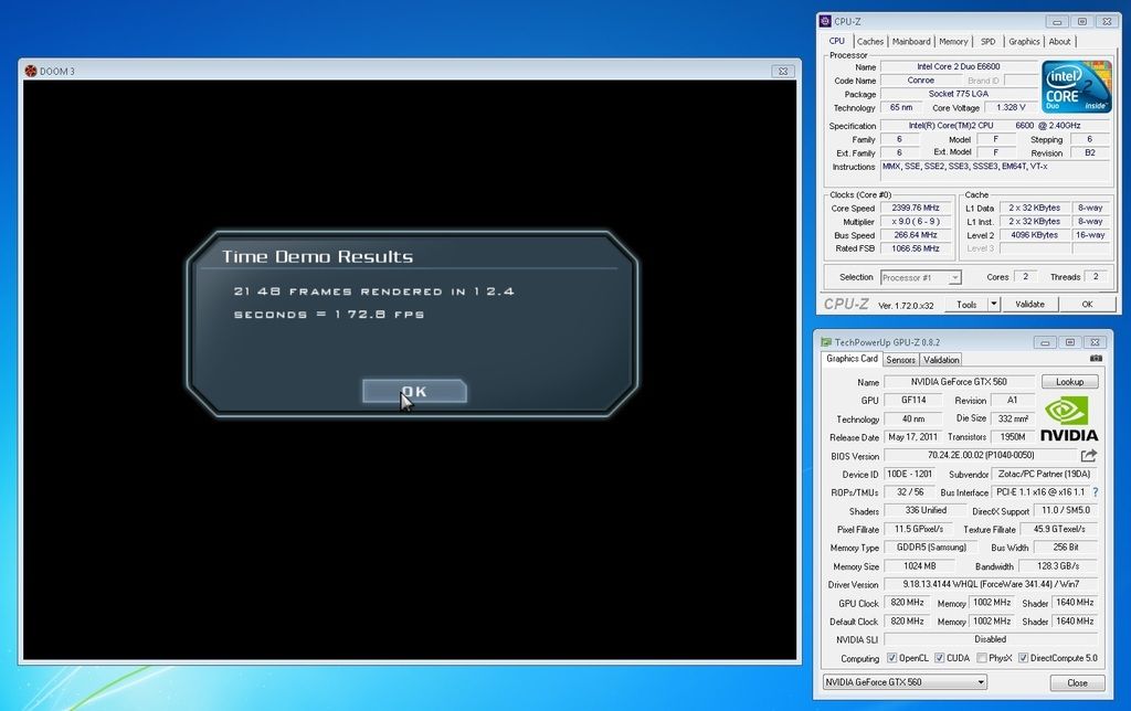

Windows XP:
C2D E6600 @ 2.4GHz/1066FSB, GeForce GTX 560 (275.33), 8GB DDR2-800 5-5-5, Asus P5N-E SLI (nForce 650i), X-Fi Ti, XP
C2D E6600 @ 3.0GHz/1333FSB, GeForce GTX 560 (275.33), 8GB DDR2-800 5-5-5, Asus P5N-E SLI (nForce 650i), X-Fi Ti, XP
For the sake of comparison, here were the Opteron 185/XP results:
At 3.0GHz: 174.3 fps (with 8800GTS SLI)
At 3.13GHz: 192.4 fps (with GTX 260)

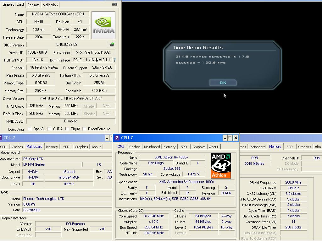

I benched an Athlon 64 4000+ with a DFI Nforce 4 board for the overclocked period correct list. The difference between Doom 3 version 1.3 and the older versions isnt huge when you are GPU bottlenecked, only ~5%.
Athlon 64 4000+@3120 San Diego, DFI Nforce 4 Vanilla, 2x1GB DDR520 CL3,3,2,7 1T, Geforce 6800@425/1100 92.91, onboard audio, Windows XP SP3
1024*768 Ultra: 120.6 FPS. The system is bottlecked by the video card and or memory, I will look into that later.
The performance is fine, Doom 3 is just incredible sensitive to memory latency. That system was a great dumpster find 😀
