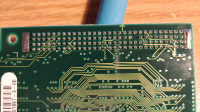

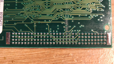

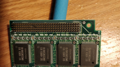

Hi, please could you look closer at the memory module towards some strong light to see if the PCB is 2-layer or multiple layers? If you can see a bit throug traces from other side then it would be only 2-layer and would be easier to RE.

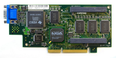

BTW I also saw Mill II 4MB for AGP - chip version 2164WA-B, I was a bit surprised to see it but there are of course better cards for AGP systems...
Wow! I didn't know there was an AGP version.

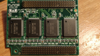

Hi, I started with reverse-engineering of memory chips wiring on Millennium II. I identified almost 92% of all pins and have some idea how it works. But I need to track the rest of pins to be able to make replica of memory module. I need someone who has the module and multimeter, with some electrical skills and be kind to help.

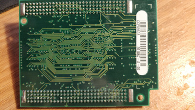

Hi, I had a closer look at your photos and also I got some photos of 12MB module from Russia but I'm unable to track unknown pins as the PCB traces are hidden below pin header or inner layers. So this method will not work, it needs to be probed with multimeter...

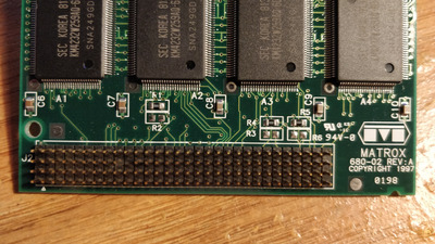

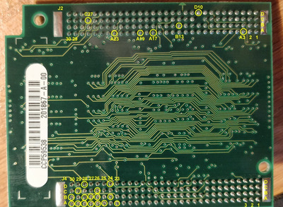

Hi, I need to identify this pins, see picture below.
It's very helpful to have a multimeter with beep tester that reacts immediately on probes connection. It's paradox that some cheap multimeters do this better than expensive ones that have overvoltage protection so it takes a few 1/10s until they beep, then seeking is much slower.
So just hold one probe on unknown pin (better on components side) and with second one move slightly touching all pins around the package of memory chips A1 to A4. Once it beeps stop and localize exact pin which beeps and count its position from nearest numbered edge pin. Pin numbering on a package below. Write down the pin number, memory chip number and connector pin number, so e.g. J2.D10=A1.78. On 4MB module some of unknown pins would be probably unconnected, on 12MB module probably all are used. Thanks.

Reply 39 of 71, by Dusko
Ok, here it is, not sure if you are still missing something, let me know...
J4-A30 n/c
J4-A29 n/c
J4-A28 n/c
J4-A27 n/c
J4-A26 n/c
J4-A25 n/c
J4-A23 A1,2 -99(OE)
J4-B30 n/c
J4-B28 A1,2 -18(CAS)
J4-B27 n/c
J4-B26 n/c
J4-B24 n/c
J4-C29 A1,2,3,4 -80(SE)
J4-C26 A3,4 -18(CAS)
J4-D28 n/c
J4-D24 A3,4 -99(OE)
J2-D10 n/c
J2-C27 n/c
J2-B13 n/c
J2-A03 n/c
J2-A17 n/c
J2-A19 n/c
J2-A23 n/c

Reply 40 of 71, by RayeR
Thanks for effort, thankfully my vision is still sharp enough to see this pins w/o mag. lens 😀
Now we have important OE and CAS signals that are grouped by 2 chips for 64b data bus width, but I'm missing the RAS. I belive it should have 2 separate pins as CAS has. You probably missed it but try also J4-D30 and J4-D29 that are RAS of onboard chips.
I wonder a bit about J4 A23 that is connected with B30 on the card but not on module, maybe used on 12MB version.

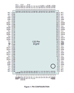

Also I need to figure data bus mapping so please check at least J4-A12 (DQ0) and J4-C3(DQ0) which goes to what chips (pin 5 on mem.chip)
and similar for J4-D21,C21,A21,D20 (BE0-3) and J4-B23,C22,B22,A22 (BE0-3) which goes to what chips (pins 119, 98, 120, 97 on mem. chip)
Also not clear about SQ0-15 lines that each onboard chip have them separate but I guess it would be also separately connected to 4 mem chips. on module, so please check at least J2-C25(SQ0), J2-C19(SQ0), J2-D13(SQ0), J2-D4(SQ0) which goes to what chips (pin 32 on mem. chip). This pins seems to have 33ohm resistors in series so be sure your DMM beeps at this resistance yet.

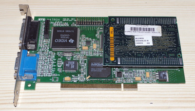

One of my friends found a 4MB expansion module and was so kind to send it to me so I will be able to beep all necessary connection myself so I hope the schematic will be completed soon 😀

Reply 43 of 71, by RayeR
I sometimes checked ebay for years but didn't have a luck. In our country it was pretty expansive professional card that was not much common used so there was even much less memory modules. All cards I saw offered on local secondhand servers was without module.
Today I received the package with friend's Mill2. It's 8MB version with 4MB module as you have. I plug it in my BX133 raid and play with it for a while. At 1st I wondered that my VESATEST detected only 4MB LFB. So I updated video BIOS from 1.1 to latest 1.5 and then got reported 12MB LFB but still there was only few truecolor modes and 1600x1200 only in 16bpp. I tried also load UNIVBE 6.7 and it increased number of VESA modes from 24 to 33 while added the highest truecolor mode 1280x1024/32 - I'm still missing 1600x1200/32 (142h). I know that this higher truecolor modes was not fully standardized by VESA but I hoped at least UNIVBE would help, a bit disappointed. This mode should be available at least in Windows and DOS CAD programs that have native MGA drivers (like Vibrant for 3D Studio).
I also bought that AGP Mill2 as a donor of memory chips. I tested it and it works fine. Due to AGP it has better LFB throughput - 180 MB/s but there are better cards to be plugged in AGP...

I have finished the schematic. RAS# signal is common for all 4 chips on the module and chips A7, A8 on board
http://rayer.g6.cz/hardware/retropc1.htm#MGAMEMRE

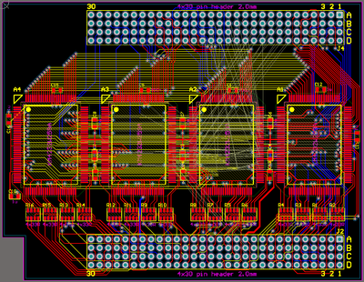

Reply 45 of 71, by RayeR

Reply 46 of 71, by RayeR
Routing is done.
http://rayer.g6.cz/hardware/retropc1/mempcb1.png
http://rayer.g6.cz/hardware/retropc1/mempcb2.png
I just have to finish some other small PCBs and I will send it to JLCPCB manufacturer...
UPDATE: PCBs are manufacturing.

Reply 47 of 71, by RayeR
PCBs arrived today. I assembled one and tested but didn't work. I found that I made a stupid copy&paste error in schematics that I swapped order of SQ0-15 pins on all memory chips. This would require manually reroute 64 connections. I will have to make new PCB revision and try again...
