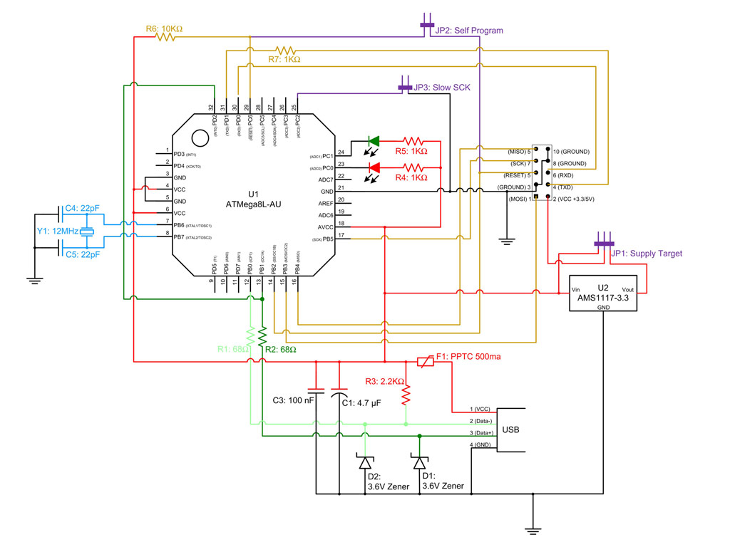

I have found a project that can make this whole interfacing even simpler. It uses a generic USBASP programmer, which is reprogrammed with custom firmware to transform it into a USB audio interface that accepts directly MIDI data: https://dragaosemchama.com/en/2018/10/usbasp- … a-midi-adapter/
Still needs an optocoupler on the input.
Since I had a couple of USBASP devices (you need a second one to program the first one) I flashed one of them. One caveat is that before you do that, you have to edit the project makefile to set the correct fuse bits for the microcontroller that the USBASP uses, in this case an AtMega8. The bits that need to be set (near the top of the makefile) are FUSE_L = 0x9F and FUSE_H = 0xC9
Then with the devices connected one to the other, you run 'make program" in the folder that you clone from github https://github.com/robsoncouto/usbaspmidi and it will program the device. You may need to install avrdude on the computer you do this on if you don't have it. I actually did it directly on the Pi.
Then you disconnect the 2, take the one you programmed and insert it into the Pi, and it registers with alsa as USBASP-MIDI; you can then use aconnect to connect it to the mt32d input.

Now, mt32d accepts imputs both from ttymidi (which can be used to send data over a USB-serial adapter from a PC through the serial port using SoftMPU for instance) and from USBASP-MIDI that will accept data from a standard MIDI output on PC.
This is a simpler and more elegant solution than the one I was working on earlier, and should work on a real Pi, any of the clones as well as a regular PC. The USBASP devices can be found for under $4 on sites like Amazon and ebay. You need to select ones that have jumper headers for J2 (that needs to be closed to reprogram it) or at least have solder pads for J2 where you can solder a 2-pin header. Some devices sold don't have either.
(edit) there are several hardware revisions of the USBASP floating around. I looked through mine, and I have 2 types:
1. blue PCB, labeled "USBASP V2" and have jumpers, these are OK to use as the relevant pins from the MCU are brought to the 10-pin interface (pin 4: TxD, pin 6: RxD). Schematic: http://www.actuino.fr/wp-content/uploads/usbasp-sch.jpg
2. black PCB, no revision marked and have no jumpers at all. These are NOT OK to use to be flashed to USBASP-MIDI because pins 4 and 6 on the connector are tied to ground, not TxD/RxD. They can be used for flashing other devices though.
So beware when you buy.
