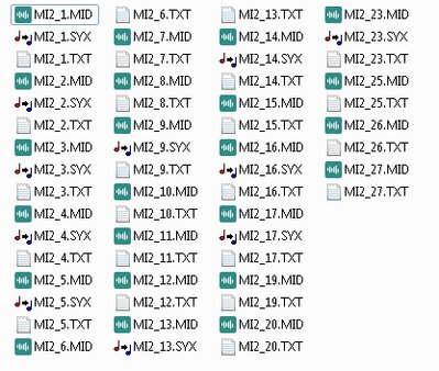

Also, there is definitely something wrong with a folder structure that looks like this:
I think it runs all the SYX files in that folder before playing the MID I clicked.
The attachment Folder MT32.jpg is no longer available
FSMP sends all the SYX files in the folder when I add a MID file into the playlist.
If I have 20ms send delay, FSMP freezes for a minute.
I think FSMP should not run all the Folder-SYX when simply adding a MID, only when actually double-clicking the mid.
Opening FSMP with a MID file that has many SYX in its folder, freezes FSMP at startup because it sends all the SYX in the MID folder at startup, before I click anything.
I think it's best not to sent a Folder-SYX at startup.
I can also see that clicking Stop only sends the reset sysex, but not the Folder-SYX.
This is correct behavior, in case I want to hear the MID without the folder-syx without changing the SYX name.
I don't think FSMP does this. You can check what syx files are played together with the midi file by looking at the last column of the playlist. Its header is now Sondfont/SysEx and lists the files that are associated with a midi file (both syx and soundfont).
The pattern is the same.
I cannot reproduce this. Further investigation is needed why you experience this.
Just like in case of Reset SysEx messages the associated syx files are only played at load time. So they are also not sent when you repeat/rewind the file.

James: could you send me a zipped version one of your problematic folders? (preferably with more files)
I have also missed this:
On one hand FSMP does not send all syx files in the folder (that's for sure),on the other hand only loads the associated syx files when you load/double click the mid.
The only exception is start up since it loads the active/selected midi file of the playlist (and its associated soundfont/syx files).
So my only explanation for the strange issues of yours is very big and time consuming syx file(s) that are associated with the active/selected midi file.

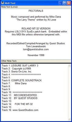

Also, a super advanced Event Debugger or the practically useless "Midi text" are in the main window but not a Minimize button?
That was rude 😀. What's the problem with 'Midi Text' ? Even if you do not enjoy Karaoke/Lyrics it can be quite informative:
The attachment midi_text.jpg is no longer available
I have uploaded a new test version with a gift for you.
