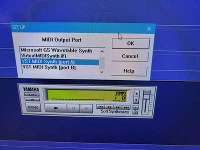

RetroGamer4Ever wrote on 2022-02-20, 17:32:
The XG Player that I'm using is the older version that shipped with the S-YXG50/70 for 95/98/XP installer packages and not the f […]
The XG Player that I'm using is the older version that shipped with the S-YXG50/70 for 95/98/XP installer packages and not the far more advanced version that you are using, which is one that I've never used, though everyone seems to have access to that particular player and uses it in their testing. Based on the config file and the system info, it seems this 2.X version was part of the WDM install package for XP. All settings in FSMP 6.1 x64 are the default settings and there is nothing accessible through the XG Player beyond the volume control and MIDI output selection, as the XG driver itself doesn't load. I'm now testing with the SysEx for Volume/Balance enabled and it's a little closer to what the XG Player puts out.
images?q=tbn:ANd9GcS_ov73fwEzmV_lCjlaaiXj35WhE9SyQ66TUg&usqp=CAU
OK, I'm trying to find this version somewhere. But you still did not answer my question, that is:
What is the "manually selected VST Midi synth" you are talking about? What is the host you use that hosts the VSTi plugin?

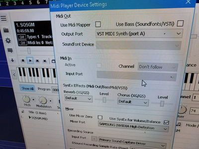

Reply 341 of 381, by RetroGamer4Ever
Here are the settings from my last comparison, with the SysEx for Volume/Balance enabled in your player. The Yamaha player shows no configurable settings beyond the volume and the MIDI Output selection. The VST host used, which is the only one I ever use, is the VST MIDI Driver from Mudlord that was recently revived by another programmer and revamped with improvements.
Reply 342 of 381, by Falcosoft
RetroGamer4Ever wrote on 2022-02-20, 17:48:
OK, I see. You are using VST Midi driver. BTW, this driver currently has major problems (although they are not relevant for S-yXG50 that much):
Re: Falcosoft Soundfont Midi Player + Munt VSTi + BassMidi VSTi
I thought that you were using some "real" hosts like FSMP or SAVIHost so you were seeing the VSTi's interface. Since you are using VST MIDI Driver you could have no idea what mode the VSTi plugin currently uses. That could be very important since S-YXG50 has a very different XG and GS mode. My player by default is set to send a GS Reset. XG player most probably not (obviously).
So first you should try to set FSMP's default SySex reset to XG by right clicking the 'Reset' button with the first aid like icon at the right hand side of the player and then select XG from the context menu.
Report back if this solved your problem or not.

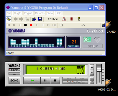

Reply 348 of 381, by Falcosoft
OK, I have finally found this older version of Yamaha XG player. Not too surprisingly it sounds exactly the same with the same settings as the newer Yamaha player and FSMP. So the only explanation (as I have already written above) is that you missed to change FSMP's default reset from GS to XG. And since you used VST Midi driver you could not see this. You heard different output because S-YXG50 was in GS mode when you used FSMP but it was in XG mode when you used the Yamaha player.
BTW this older version of Yamaha player always sends a GM reset (which puts S-YXG50 into XG mode).
The attachment xgplayer2.png is no longer available
@Edit:
Here is the new test video:
https://youtu.be/ThkUufdrjYA

Reply 349 of 381, by Trelokk
I guess that would mean that the VST Driver in its current state isn't a good choice for the S-YXG50, either (because of wrong reset)?
Reply 350 of 381, by Falcosoft
Trelokk wrote on 2022-02-21, 09:35:
No, In this respect the only problem with VST driver is that you cannot see what mode it is running in. There is no 'wrong reset' problem. If you send it a GS reset it switches the plugin into GS mode and if you send it a GM/XG reset it switches the plugin into XG mode properly (GM/XG resets are equivalent in case of most Yamaha XG synths).
The only problem occurs if you are not aware of this therefore you do not understand why the plugin sounds differently.
In the above case RetroGamer4ever used 2 different players that used 2 different reset Sysex messages (Yamaha player always sends a GM reset but FSMP sends a GS reset by default) and expected to get the same output.
If he had used a different host then he would have seen clearly on the plugin's interface that the plugin was in different modes (green XG mode vs. orange GS mode).
If you use FSMP you can use any modes that the plugin knows since you can freely select GM/GM2/GS/XG reset SysEx messages.
Many games and Midi files do not contain any explicit SysEx reset messages so you are using the mode what the player sets.
