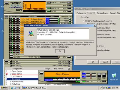

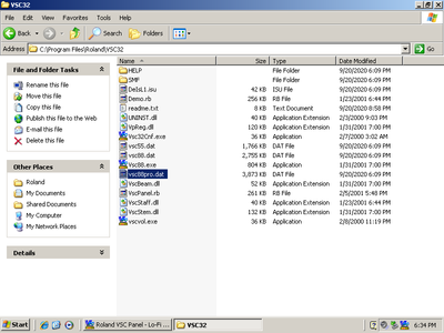

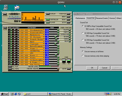

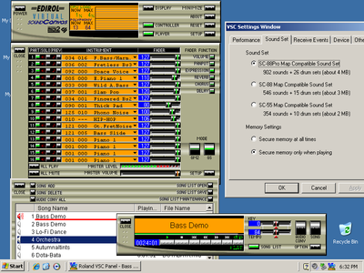

Hi All,
something like 15 years before Roland released "Sound Canvas VA":
Heads Up: Roland Sound Canvas VA VSTi Plugin!
they did release "Edirol (Roland) Virtual Sound Canvas 3.x" :
https://web.archive.org/web/20120302180655/ht … ts/en/VSC-88H3/
I cannot find any discussion about it - here or elsewhere and that's why I am posting this topic.

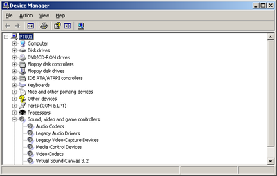

Actually, I am surprised why is that, because I've just tried it and it works both in Win9x and WinXP. it uses (virtual) driver, same like Yamaha S-YXG50 Soft-Synth, which makes it work with everything as it is system-wide.
It seems there is VST version included in what is called VSC-MP (Virtual Sound Canvas Multi-pack).
So, it's very light-weight compared to the new "Sound Canvas VA", but most interesting (at least to me) is that like Yamaha S-YXG50 the sound banks are separate files - that gives potentially an advantage like Yamaha the format to be reverse-engineered and they be replaced with dumps from the real hardware. After all it's amazing how (I believe some Russian guys) reverse-engineered S-YXG50 sound banks format and based on that made Soft-Synth of Yamaha TyRUS using the same S-YXG50 software synth engine just with replacing the sound banks. I guess my hope is some day someone will do that with Roland Virtual Sound Canvas 3.x and based on real hardware dumps will recreate perfect software copy of the real hardware (because current sound banks are deliberately lower quality than the one inside the real hardware). Anyway, let me put few screenshots (most of them from WinXP and one from Win98SE) including one that shows the files, i.e. the separate sound banks for SC-55, SC-88 and SC-88Pro .

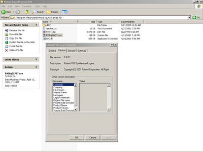

Actually, the VST from Roland VSC-MP1 is even more interesting in terms of reverse-engineering potential, because it has 3 files:
* RVI01.dat : identical to 'vsc88pro.dat' from "Edirol (Roland) Virtual Sound Canvas 3.x", i.e. that's the sound bank. Also, that means the VST defaults to SC-88Pro mode. Interesting to try replace that file with SC-55 or SC-88 bank from "Edirol (Roland) Virtual Sound Canvas 3.x" - if that will work and changing the sound bank is enough to change the VST mode from SC-88Pro to SC-55/88
* VSC.dll : that I guess is more or less just the GUI of the VST
* RVIEg01VST.sys : which file description is "Roland VSC Synthesizer Engine" - see the attached screenshot
So, definitively, someone much smarter than me, reading disassembler code of 'RVIEg01VST.sys' should be able to figure out the format of the external sound bank and most likely be able to ultimately replace that bank with the ROM dumps from real SC-55, SC-88/Pro.

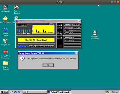

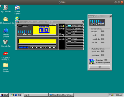

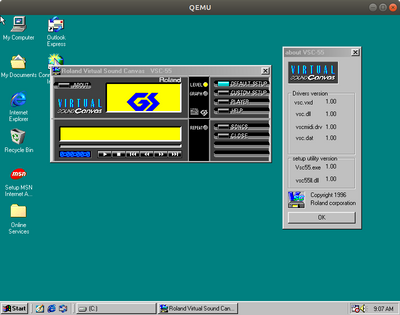

B. Trial Version: filename "VSC55T.EXE"
You can download it from the following web-archive link of the Roland website:
http://web.archive.org/web/19961105205705/htt … /vsc/VSC55T.EXE
That's version 1.00 of the software with 50 seconds playback time limitation.

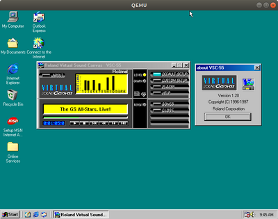

C. Update to version 1.20: filename "v5up120e.exe"
While the update filename is easily obtained from the following web-archives links:
https://web.archive.org/web/19980704003005/ht … /vscupdate.html
the link to the file itself is dead. However, it's easy to find mirrors of it (still up and running in Sep 2020) using Google. V1.20 is the last version from 1.x generation.
D. Retail version 1.20
As of Sep 2020 it's possible to find it using very hard Google search, but posting more details I believe is against the forum rules (i.e. copyright concerns). So, it's not a big loss, because compared to what is in C. it contains only 2 extra files and those are 2 Demo songs "2ND_TIME.MID" and "ALLSTARS.MID" (EDIT: and those 2 songs plus 3 extra are included in Trial version of VSC-88 2.21 - see the next post for more details(
E. What's new in V1.20
In the version 1.20, the followings are modified.
VSC-55 now can work on monaural sound device, too.
VSC sound device now can play 16-bit monaural wave correctly.
Unnecessary message, 'can not find wave device' is not displayed.
A utility function is added to avoid troubles on some applications (such as games)
which use MIDI performance and audio playback simultaneously.
To start up the utility software, please refer to the [About the Utility Software]
in the [Troubleshooting Q&A] in the VSC-55 Help, there click the [Starting the Utility].

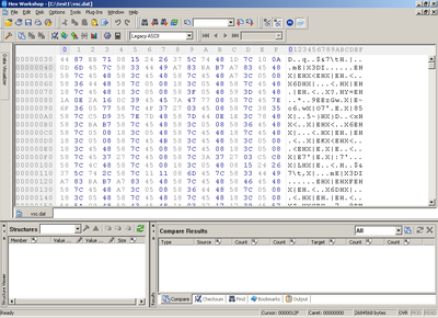

G. Note for people interested in Reverse-Engineer the Sound Bank Format
V1.00 Trial and V1.20Update/Retail has the same "VSC.DAT" sound bank for SC-55 emulation except 2 bytes in its header - what those bytes indicate (version?!) currently is unknown, but the rest is byte-by-byte identical files.
H. Some Screenshots I made:

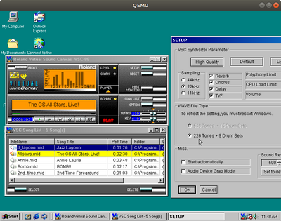

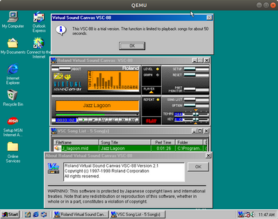

Roland Virtual Sound Canvas VSC-88 (Official name)
Roland Virtual Sound Canvas 2.x (Unofficial name)
Year of Release: 1997 (I must say very impressive, because according to Roland Help files, it emulates Roland SC-88VL, which means that less than 1 years after they released the SC-88VL hardware, Roland made software emulation option available)
Features (from the Roland Help File):
Number of parts: 16
Maximum Polyphony: 128
Internal Tones:
Preset sounds: 546
Drum sound set: 15
Effects:
Reverb (8 types)
Chorus (8 types)
Delay (10 types)
Audio Output: 16-bit stereo, 44.1kHz/22.05 kHz/11.025 kHz sampling rates
Audio Input: 8-bit/16-bit stereo, 44.1kHz/22.05 kHz/11.025 kHz sampling rates
Windows Compatibility
According to Roland Win95/98, I tested it in Win98SE without problems.
A. Web Archives:
https://web.archive.org/web/19970607131210/ht … sc88/index.html
https://web.archive.org/web/19980519184714/ht … om/vsc88me.html
B. Trial Version: filename "TVSC8821.EXE"
the links on web-archives of Roland website are dead. However, it's easy to find mirrors of it (still up and running in Sep 2020) using Google. It has the 2 missing Demo songs from VSC-55 Trial (see section B. from the above post) plus 3 more Demo songs. (So, that allows also to fully recover retail of VCS-55 v1.20 as per the above post.)
That's version 2.10 (last one is 2.21a) of the software with 50 seconds playback time limitation plus it only includes "vsc55.dat" and not "vsc88.dat", i.e. the Trial provides only SC-55, but not SC-88 sound bank. The retail version has both and thus provides both SC-55 and SC-88 mode.
C. Update from Retail version 2.00 to 2.21a: filename "vsc8821a_updater.exe"
Again, the links on web-archives of Roland website are dead. However, it's easy to find mirrors of it (still up and running in Sep 2020) using Google.
D. Retail version 2.10 or 2.21a
I don't have access to one and so nothing to add as a comment here.
E. What's new in v2.21a compared to previous versions
me wrote:
I can find changelog only in Japanese, Google translation is awful and I am not sure if those changes are for 2.21a exactly, bu […]
and I am not sure if those changes are for 2.21a exactly, but to list a few:
- fix the problem that noise may occur
- Enhancement of the MIDI player - the user can change the tempo (and keys??) of a song with a slider
- add monitor window
F. Manually Update Trial version V2.10 with V2.21a Update, i.e. section "B" manual update to section "C"
Side-effect of that is getting retail 2.21a, but without the SC-88 sound bank, i.e. retail 2.21a, but only with SC-55 mode. Again, I don't want to break any forum rules. So, everything said in the previous post section F. still applies, but this time you need to use "i5comp.exe" as they switched to InstallShield 5.x

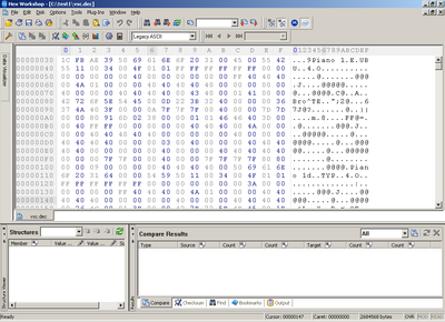

Sound bank "vsc55.dat" Header is totally different than "vsc.dat" provided with VSC-55. Interestingly, "vsc55.dat" header has the same "magic" (first 14 bytes) as sound banks from "VSC 3.x", but the rest of the sound bank is totally different.
H. Some Screenshots I made: (I forgot to made screenshot of updated to 2.21a version, sorry)

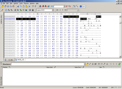

@Stretch, big thank you! And even Bigger thank you to the person made that post with full details for the encryption algorithm almost 15 years ago!!
Wow, it's amazing that the Sound banks from VSC 3. contain even CM-64/32L ROM as well, after they are decrypted. Now, after the first step, the decryption, is done (actually it was done 15 years ago), we can even further and deeper analyze those Sound Banks structure.
Anyone, any information for the ROM Dump Structure of real SC-55, SC-88 or SC-88Pro hardware?

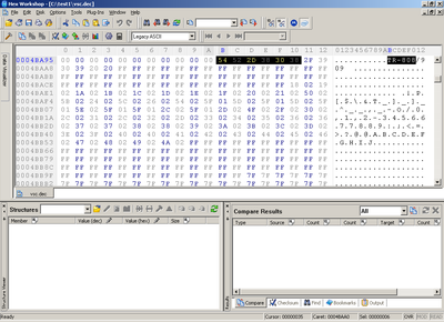

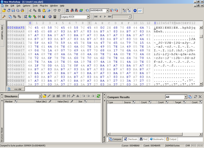

Guys, I've already moved several steps further from what 'sm0n' did, all those years ago, here :
Virtual Canvas Sound Banks
We're very lucky that in VSC 3.x Roland messed up the Sound Bank encryption big time (thank you, whoever Roland employee did that! BTW, when such thing happens I always wonder if the employee did that on purpose or by accident). So, instead using 32-bit encryption key, as I now found out they did in the previous version VSC 2.x (a.k.a. VSC-88 2.x), in VSC 3.x they used effectively 16-bit key (2 bytes of the 32-bit key set to 0).
That fact I guess helped 'sm0n' to figure out VSC 3.x encryption algo, making it actually much more obvious. In other words Sound Banks from VSC 3.x are like 65 536 times weakly encrypted than the previous version, i.e. VSC 2.x (a.k.a. VSC-88). That also helped me, now to break the "heavier" encryption of the Sound Banks from VSC 2.x (a.k.a. VSC-88).
Where I am currently:
* I wrote code (in C) that finds automatically the decryption key, which has 3 benefits:
1. do not publish any (Roland) keys (like 'sm0n' did, which is to say the least, a gray area)
2. be able to find the key of any Sound bank from both VSC 3.x and VSC 2.x (a.k.a. VSC-88) and successfully decrypt them
3. having VSC 2.x (a.k.a. VSC-88) SC-55 Sound Bank decrypted and compare it to the decrypted one from VSC 3.x gives immediate benefit of showing how sounds/instruments are added, because even between the first 2 two pianos in VSC 2.x version another one is added in VSC 3.x version
* What's next:
- check if my code can decrypt VSC 1.x (a.k.a. VSC-55) Sound banks, because more Sound banks we have, easier to fully understand their structure
- I don't have SC-88 bank from VSC 2.x (a.k.a. VSC-88), because the Trial version of VSC 2.x (a.k.a. VSC-88) includes only SC-55 bank. It would be good if someone here have it and it's willing to run my code on it
- at least Sound banks from VSC 2.x and VSC 3.x have unencrypted header, I mentioned that already few posts ago:
mattw wrote on 2020-09-21, 13:10:
G. Note for people interested in Reverse-Engineer the Sound Bank Format[/b]
So, another next task is to try to pinpoint the exact length of the header, i.e. where the unencrypted data ends and the encrypted one starts.
- if other people are interested publish here, my source code, it has no any keys, no any copyrighted material, just public domain algorithms regarding XOR encryption algorithm.
OK, my next portion of spare time, I will check if my current code works with VSC 1.x (a.k.a. VSC-55) Sound banks...

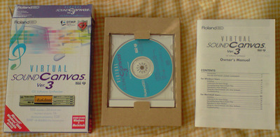

for completeness, i've just found this link in the web-archives:
https://web.archive.org/web/20050205022507/ht … ve/vsc88h3.html
indeed VSC 3.x was released for MacOS too. So, that's consistent with what 'Jo22' poster earlier in this forum thread:
Re: About Roland Virtual Sound Canvas 3
at that time I didn't fully understand his post, because I didn't know there is VSC 3.x for Mac.
[EDIT] found picture of how that retail package looked like...

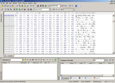

Reply 15 of 377, by mattw
Oetker wrote on 2020-09-22, 18:07:
I was wondering how you'd concluded it was decrypted, being that you don't know the format of the data?
by getting readable ASCII strings in the data. [EDIT] add screnshots to make it more clear - how Encrypted and Decrypted data block looks like.
it's the same with VSC Sound Banks - I am not sure if they are fully decrypted, i.e. if there is not some block inside them that uses different key. However, with VSC Sound banks it looks fully decrypted, because there are readable ASCII strings all over the whole decrypted file.
on hardware SC-55 ROM data - for the time being I gave up as I cannot get readable data all over the whole decrypted ones (in SC-55 hardware the Sound bank is spread over 3 ROMs with size of 1MB each - so it could be the way i am merging them is wrong too).
In any way, with "vscdec.c" in my previous post and VSC Sound Banks - it seems to work fine and everyone interested can try and see - even better find mistakes or prove me wrong.

BTW, the VSC decrypted Sound Banks contain information about "CM-64/32L", possible copy of its ROM (maybe Roland included their own "MUNT" in the VSC soft-synth, who knows?!) - to show the encrypted section and the one decrypted with "vscdec.c" i am attaching the corresponding screenshots.
Reply 17 of 377, by mattw
Also, Decrypted vs Encrypted data block about TR-808/909. So, VSC Decrypted Sound Banks are full of intriguing data.
