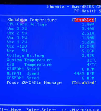

Reply 382 of 683, by repaxan
On my ECS NForce4-A754, the NB chipset fan is incorrectly reported as the CPU fan.
    NFORCE4-A754.rar
    43.08 KiB
    66 downloads
    24.66 KiB
    2015 views

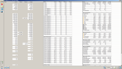

Reply 384 of 683, by repaxan
Asus P6T Deluxe with wrong voltage reporting.
I also noticed that when minimized and re-maximized sometimes this graphical glitch would happen.
    187.22 KiB
    1969 views
    p6tdeluxe.rar
    128.84 KiB
    67 downloads
Reply 385 of 683, by Mumak
repaxan wrote on 2020-06-19, 04:20:
Thanks, voltage values will be fixed in the next build.
But I have no idea why that glitch happens, haven't seen that yet.

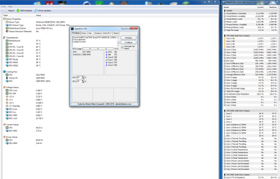

Reply 390 of 683, by dottoss
Hi Mumak, on my LGA 775 build with an q6600 there are some core temperature discrepancy between aida64, speedfan and HWiNFO. The two other is consistent while HWiNFO is reporting higher values. Attached you will find the debug file and below some screenshots.
244.72 KiB
1867 views
    HWiNFO64.zip
    45.21 KiB
    57 downloads
Reply 391 of 683, by Mumak
dottoss wrote on 2020-06-28, 10:43:
This is most probably due to a different Tj,max assumption in different tools, but none of them knows this for sure. It's not possible to detect the correct value on older CPUs.
HWiNFO believes Tj,max=100 C for this CPU (which should be correct according to the specifications), others most probably think it's 90 C.
If you're sure it's not correct, you can change this by right-clicking on the core temperature in HWiNFO -> Adjust Tj,max.

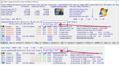

Reply 392 of 683, by red-ray
Mumak wrote on 2020-06-28, 13:21:
AFAIK TjMax depends on the stepping and [B3] is 90°C whereas [G0] is 100°C. Given this I expect Speedfan + AIDA64 did not get updated for the [G0] stepping.
