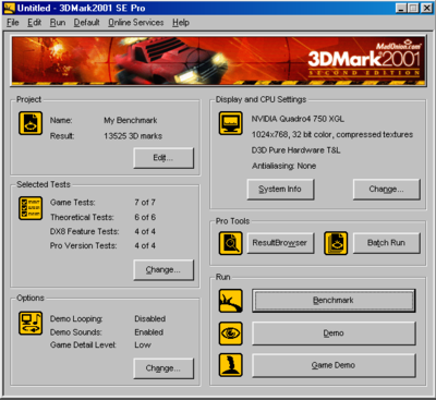

I ran 3DMark 2000 and figured you'd like to see how your system compares.
P4 1.8ghz; 2x256mb at 266mhz; gf4 ti 4200 128mb at 250/500
11690 3dMarks
Seems like even without dedicated CPU tests there is a clear advantage, i doubt 25mhz GPU clock would make for such a big difference on their own.

Here is default 3DMark2001 SE Score
13,525
53.8 KiB
1930 views

I tend to use discjuggler but on a modern machine, mostly since its cdi format is best suited for my console related needs. imgburn usually does the job but maybe there's some copy protections getting in the way?
In other news i've swapped to the fastest 'early 2002' Pentium 4 now, 2.53ghz FSB533 and ran benchmarks again
3dmark 2000 went from 11690 to 14049
3dmark 2001se from 9299 to 10882
I did not quite expect that jump in 2000 but i guess it really was cpu and bandwidth limited, this is all still with the same standard GPU clocks. (250/512 as it turns out, thanks aopen)
